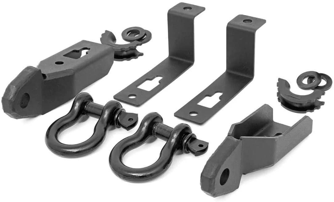

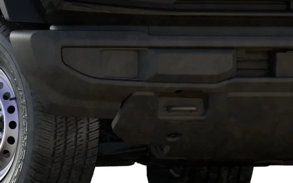

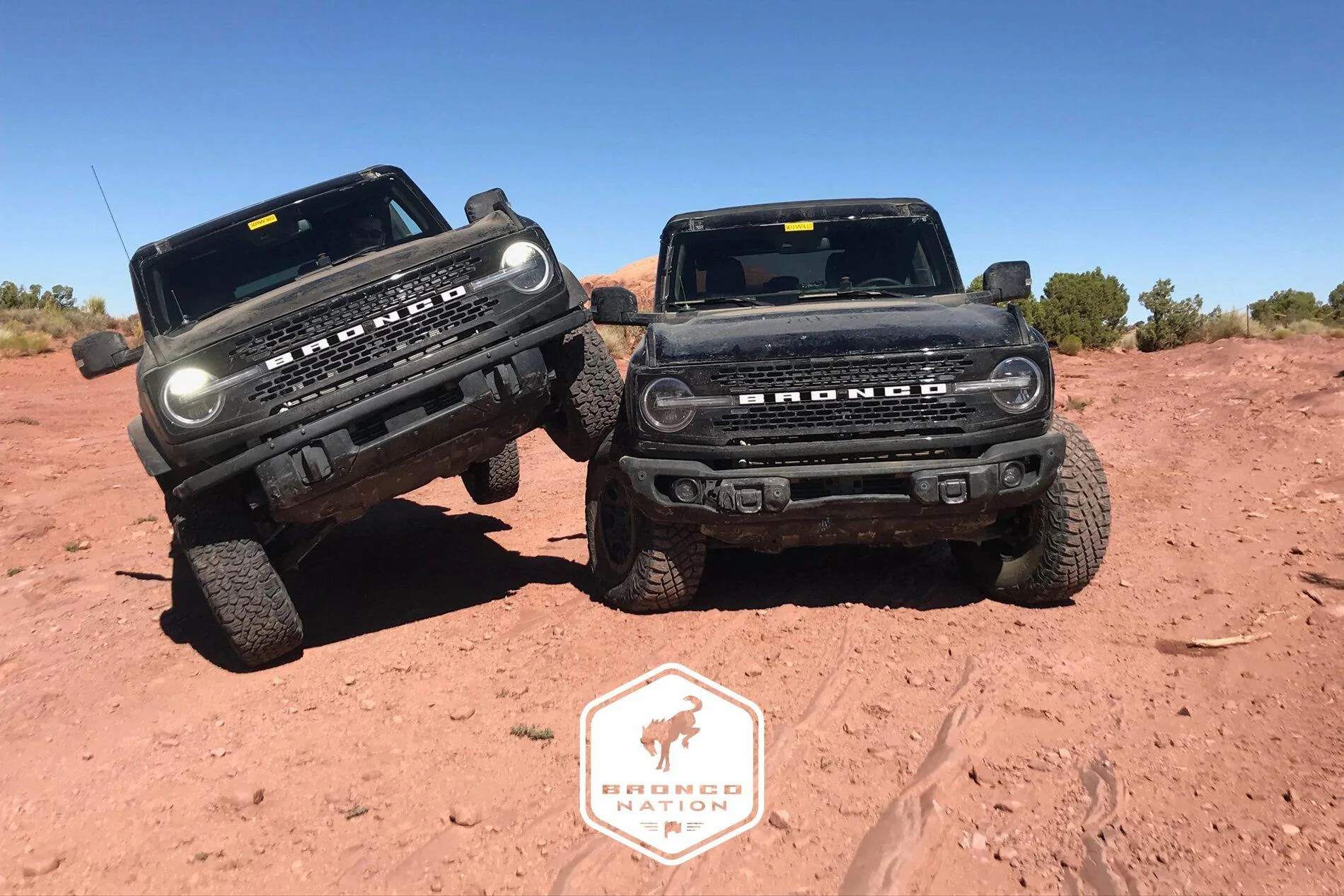

I inspected the shackle mounts in Moab. Factory shackles are mounted with three (I assume hardened) bolts. They bolt to a flat metal plate welded to the end of the frame. The plate is , frankly, not very heavy but ford apparently thinks it's strong enough for towing and winching.
I'm getting a BB with the Base Bumper and plan to replace the lower tow loops with a shackle adapter. Each is held to the under side of the frame with two bolts. Definitely want locktite there. They are at the correct height for my tow rig. The upper shackle location is too high I think. .
Then I would install the upper shackles behind the rectangular 'box' for safety cables and get unstuck towing, like the one on the right in this photo.
If you use a folding bar that stays on the towed it would interfere with the intercooler and sensor box when folded if you use the upper mounts.
All this is tentative pending a better idea. Your comments would be welcome.
Unlikely the bolts are hardened above any standard grade. Hardening is good for friction wear, not so much for shear strength. Excess hardening makes steel brittle. The steel alloy has a much greater effect on shear/tensile strength.

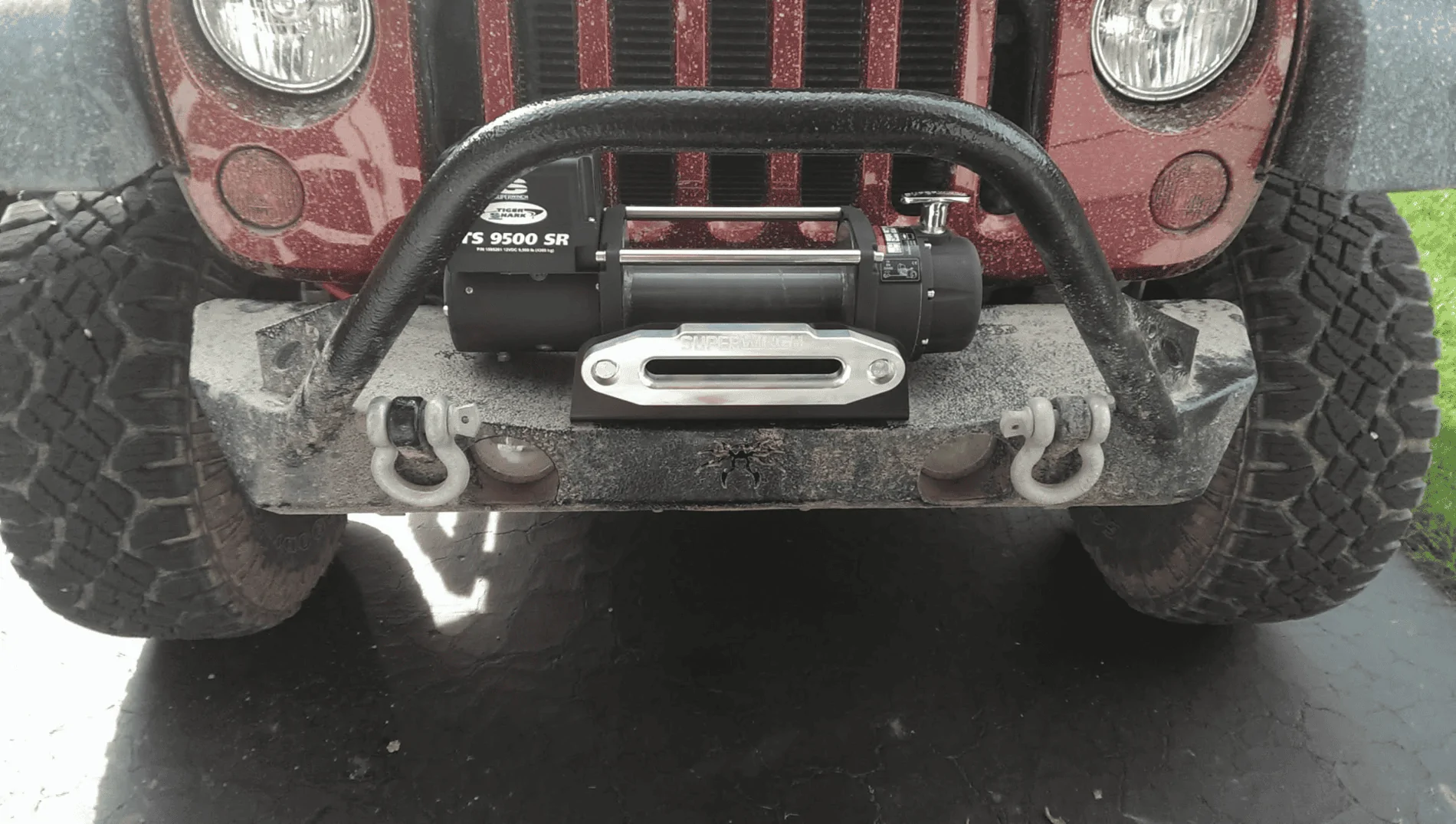

Been running a SuperWinch 9500lbs with synthetic cable on my Jeep for something like 7 years now. It's been extremely reliable with plenty of power. It's totally underused now with the type of wheeling I do so for that it won't be transferring over to the Bronco.
Skimmed my pics and I don't see any of it fully installed with the cover off and I'm too lazy to go outside and do that so here it is freshly installed before spooling the cable.

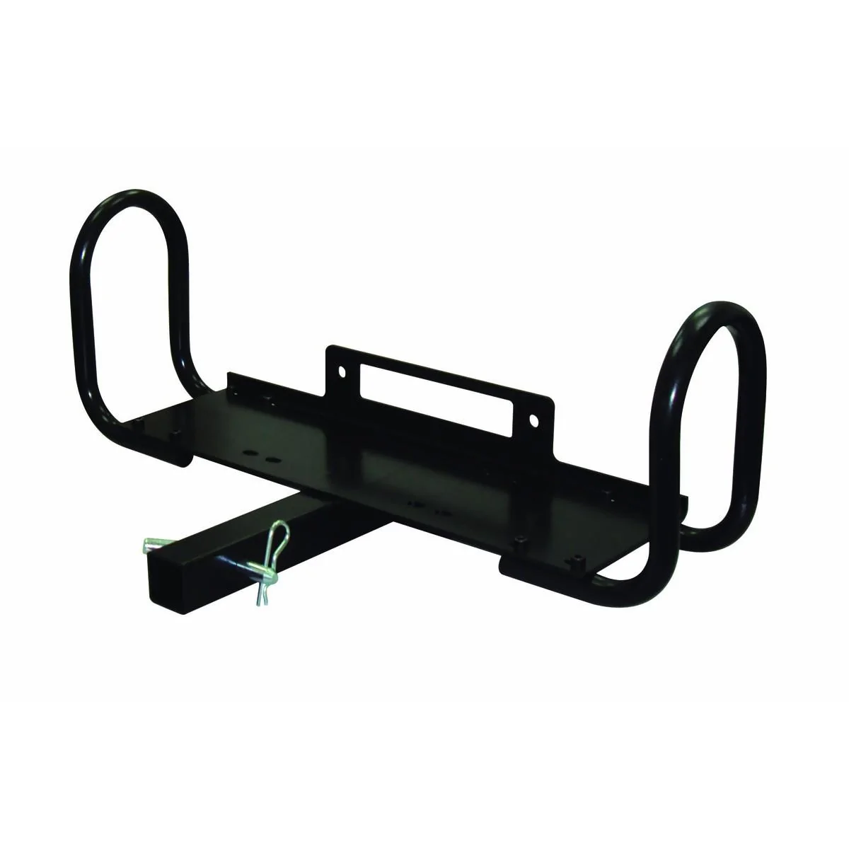

Interesting. It looks like the 7500-lbs option includes a mount that fits Class III receiver hitch. Looks like that would be less expensive than purchasing a hitch and a separate receiver cradle.

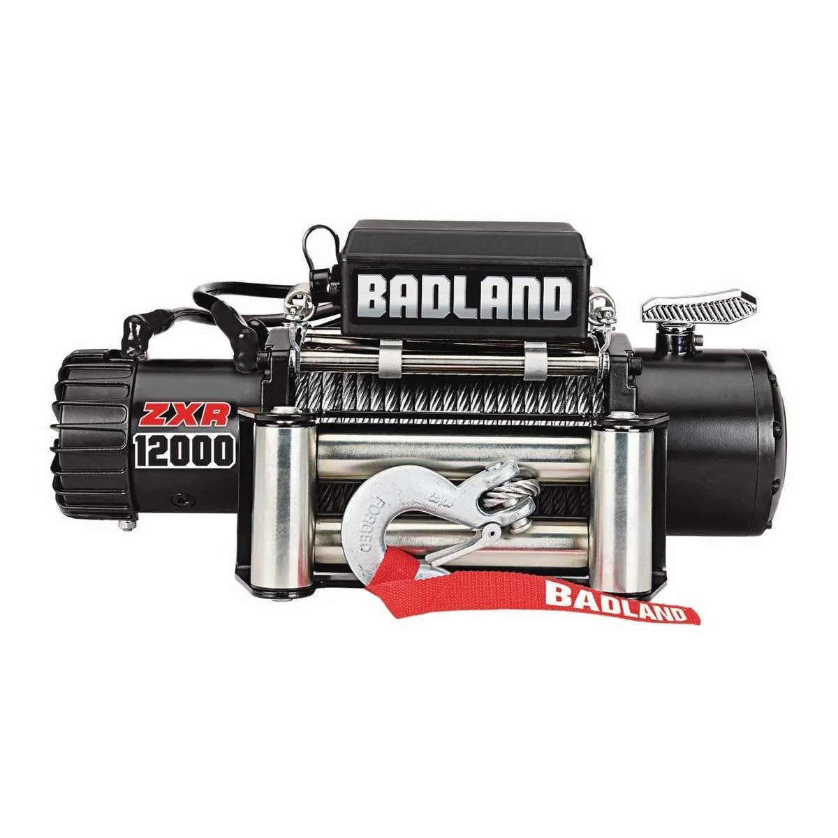

I would buy Harbor Freight before that no name. The Badland has a good reputation amongst a number of wheelers per @Gr8Hortoni.
With their standard 20% off coupons this setup is around $350 and it is rated 12K.

https://www.harborfreight.com/hitch-receiver-mount-for-winches-69106.html

Pros: Harbor Freight has charts that prove the Badland winch is better than a more expensive Warn. :) Plus I ordered a Badlands so how cool to have the trim level printed on the winch.
Cons: That cradle is only rated for a 6000 to 9000 lb winch.

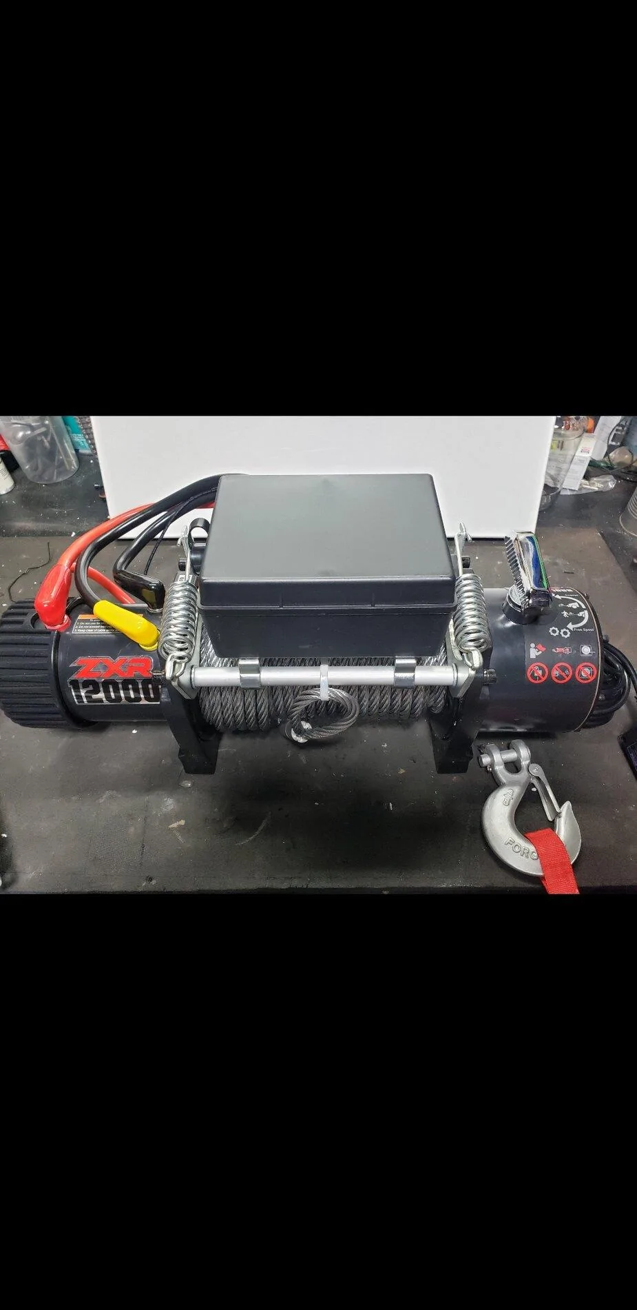

Bought this for my new bronco during black fri sale it comes to house and gf finds it on porch and says thanks baby i love my winch we stuck it on her jeep ,oh well
