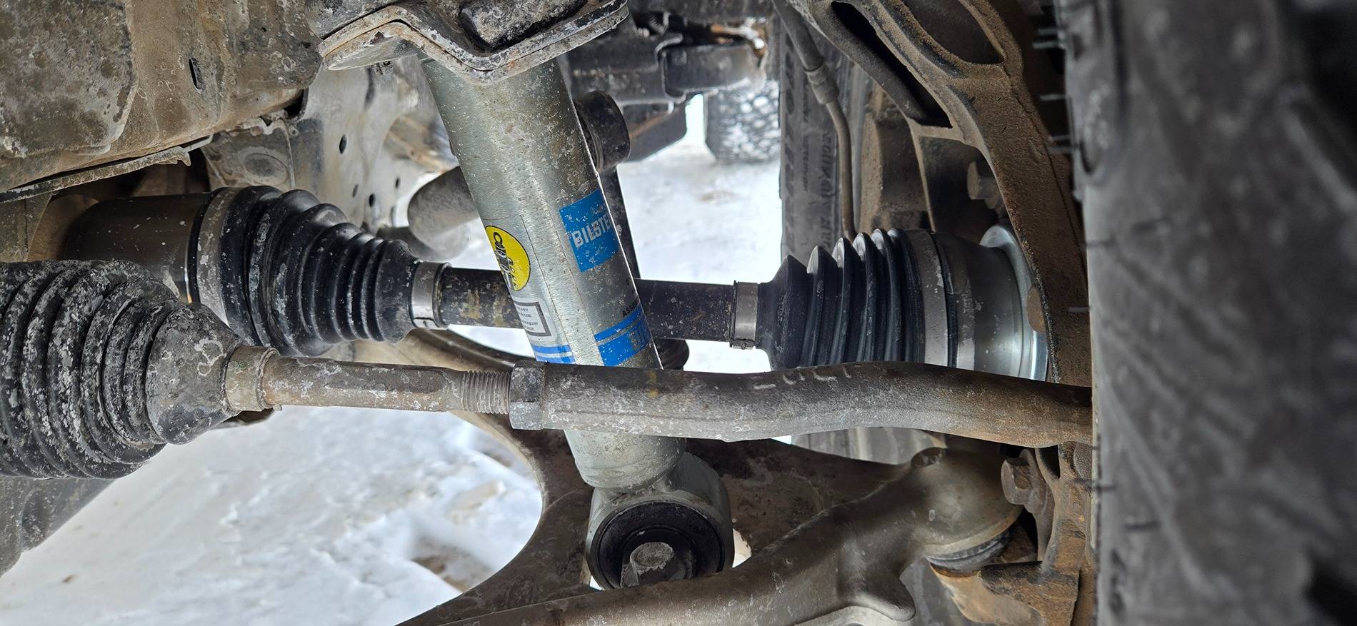

Isn't a 2" lift on a non sasquatch the same as just a 1" level on a Sasquatch? I see lots of people with that and don't have this issue, not trying to sound like a smart ass btw I just thought a 2" lift was fine for CV angles. Here's a picture of my angles incase you were wondering
Looks less than the angle I've been running on mine. Not that that is confirmation that it's fine, just some anecdotal evidence.
Checked the bolts on the drive line and the FDU mounts? There's also that TSB for the FDU mount cracking, worth checking out.
I've thought about that FDU mount TSB but I have no idea if it would cause a rythym sound like I'm hearing. Maybe I'll pull the skidplate off and take a look
