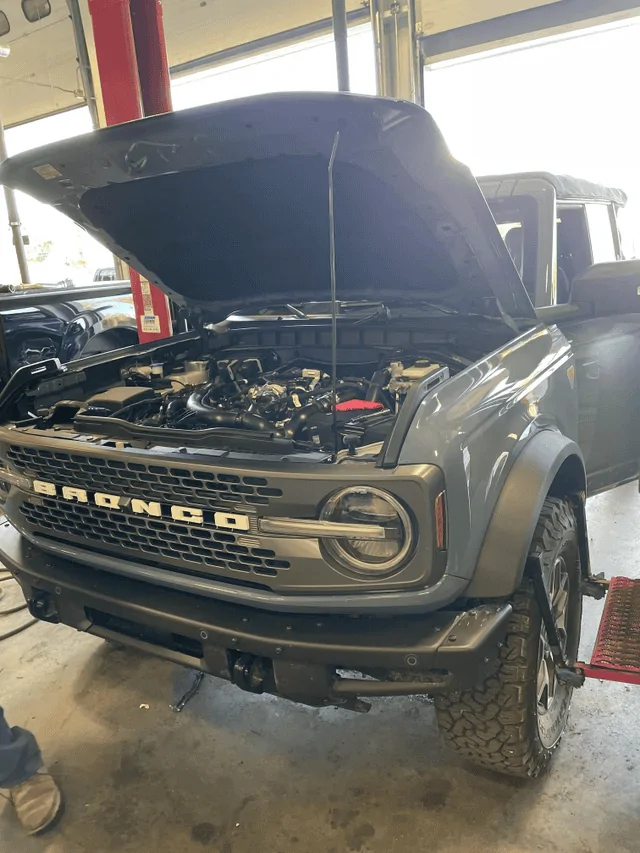

I didn’t post on Reddit, but it’s very possible that the tech working on my Bronco did. Interesting though!
Actually, after going through this Reddit thread CAN CONFIRM this is my Bronco. Lol! My husband hooked tow straps to his F-350 and towed my Bronco into the dealer, which is what this tech commented on Reddit. How funny!

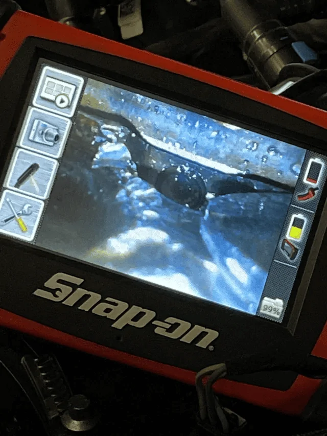

I had an issue yesterday with my Badlands 2.7. Bought and picked up on July 21, we’ve put roughly 2400 miles on her (took an awesome trip up to High Rock at the very top of the Keweenaw Peninsula) and everything has been great so far. Yesterday, I noticed some loss of power in acceleration while driving, pulled over and put her in park. Turned off for about 5 minutes and then tried to restart, wouldn’t turn over.
Luckily, this happened about half a mile away from my dealer, so we just hooked a tow strap up and sadly limped her into their service bay.
The dealer called me this morning and said they got ahold of Ford last night. Somehow, somewhere the engine dropped a valve and that Ford is replacing the entire engine….
Anyone else have this experience?
