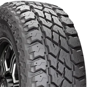

I’m sure this was covered somewhere. But can you fit a 33 on the 16x7 base wheel? I know 285 75 16 KO2 recommended 7.5 inch width at minimum.

255 85 16, Same width as stock base, but 32.6" tall. Available in Cooper Discoverer ST. Will fit stock rims and (probably) allow tire chains.

Just looked up some comparison pics..Not sure I can get on board with now skinny they look.

yes, but they would be ultra functional, tough, and with the steelies give the Bronco a real retro look. I have 235 85 16's on my Rubicon, they do the job

I've spent a lot of time in the dirt with those tires. They perform really well and ride nice on the pavement. Would not hesitate to have them on my Bronco.
