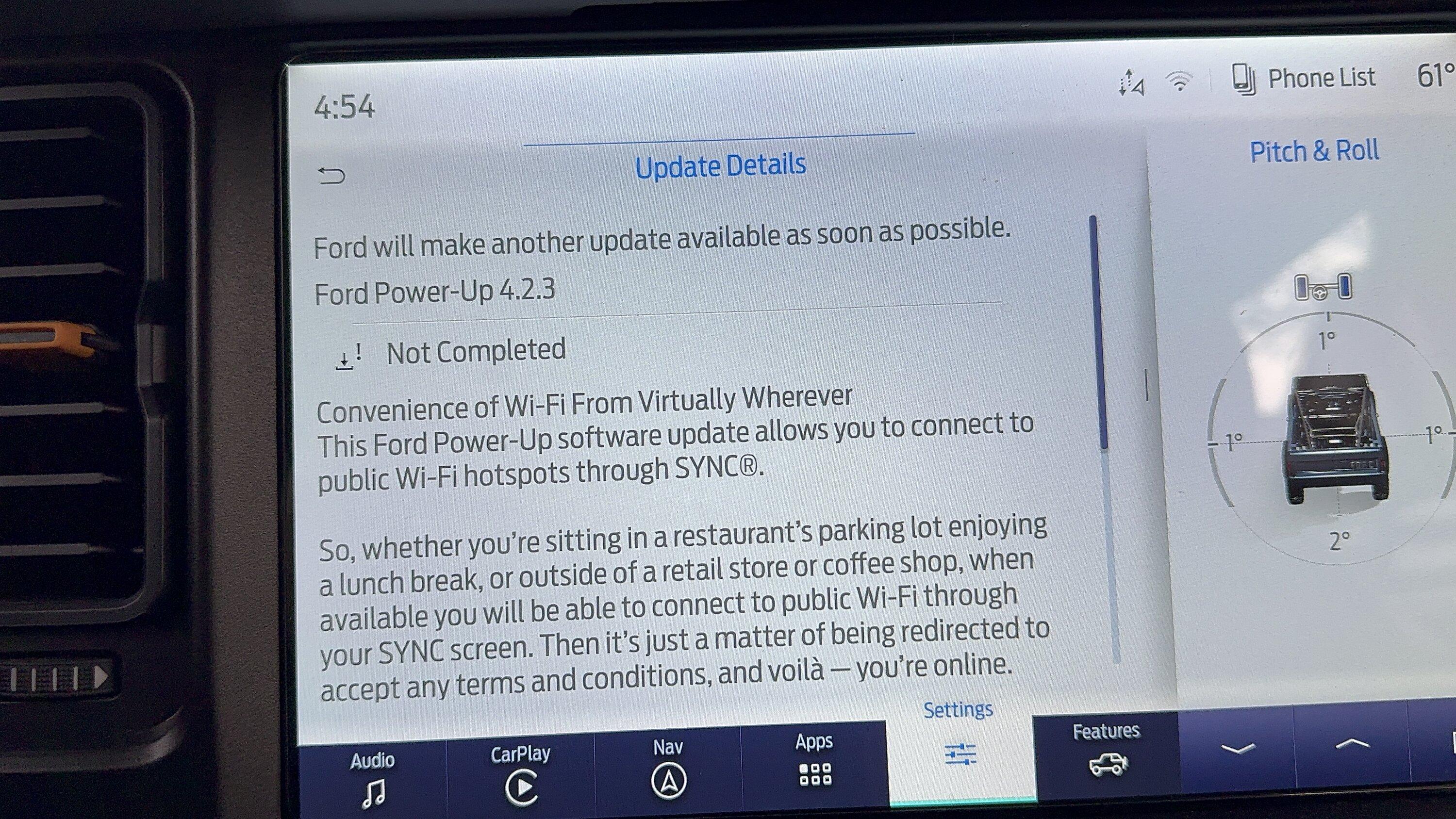

@fordmotorcompany - here is a video of the interference. I get this randomly when driving, when putting into reverse and sometimes when going through menu options. All while playing via CarPlay…
Also, here is a screen shot of a power up that has been stuck since Nov 7.. I called the over the air update line and had my dealer look at it. No help from either.,… Guess we are stuck with faulty software…
Still no improvement on my end either.
