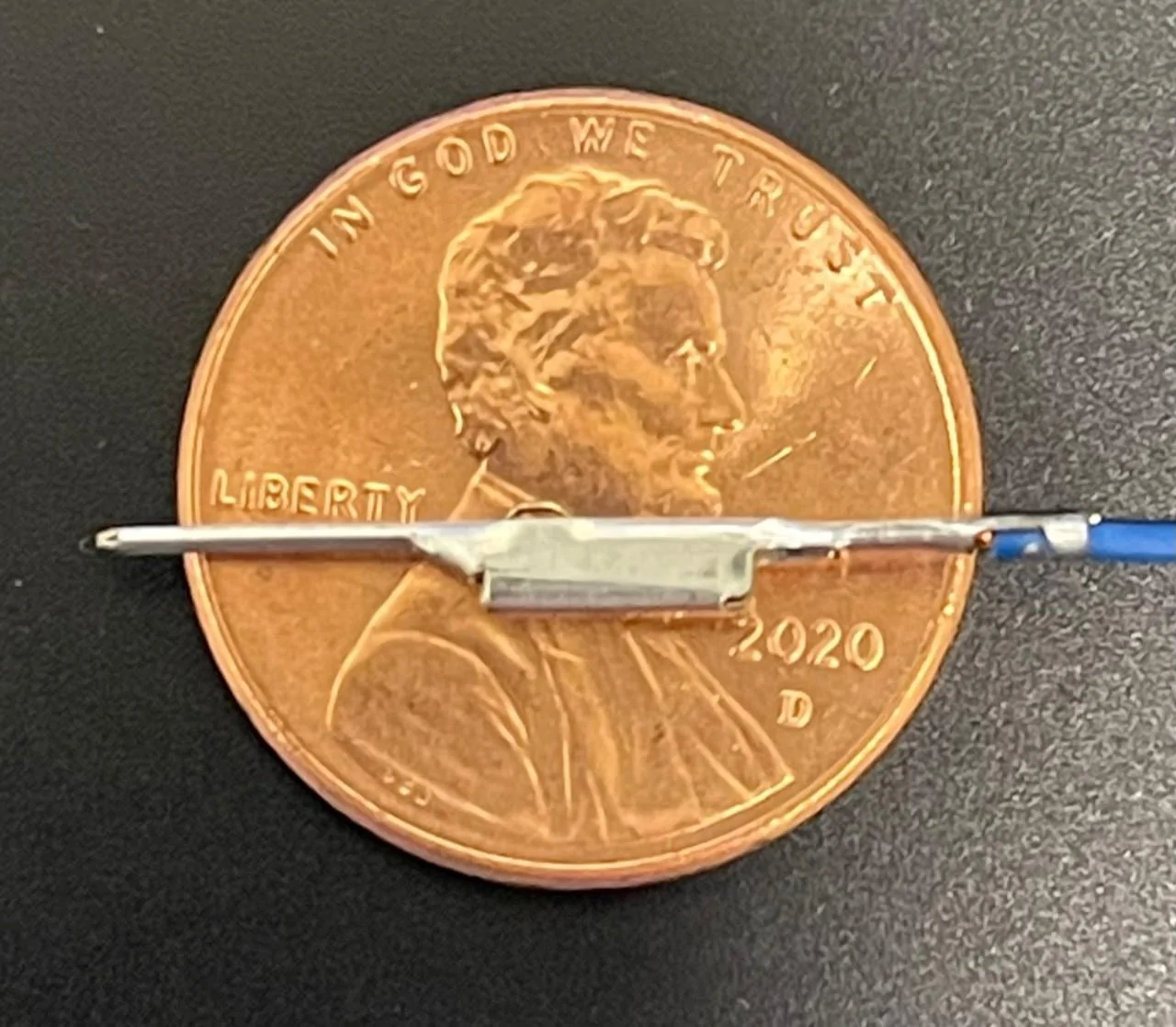

I'm working with a guy to get the pigtails put into the system. These are WDP which means not available on the consumer end, at least not this part number. The bumper harness is fairly cheap by Ford standards. WPT-1548 is available for the fog itself but then you either have to splice the ground into the existing harness and run a + to C424 with the correct TE .64 terminal or just jump around and pick up the white/blue on the body side. It's a little one...

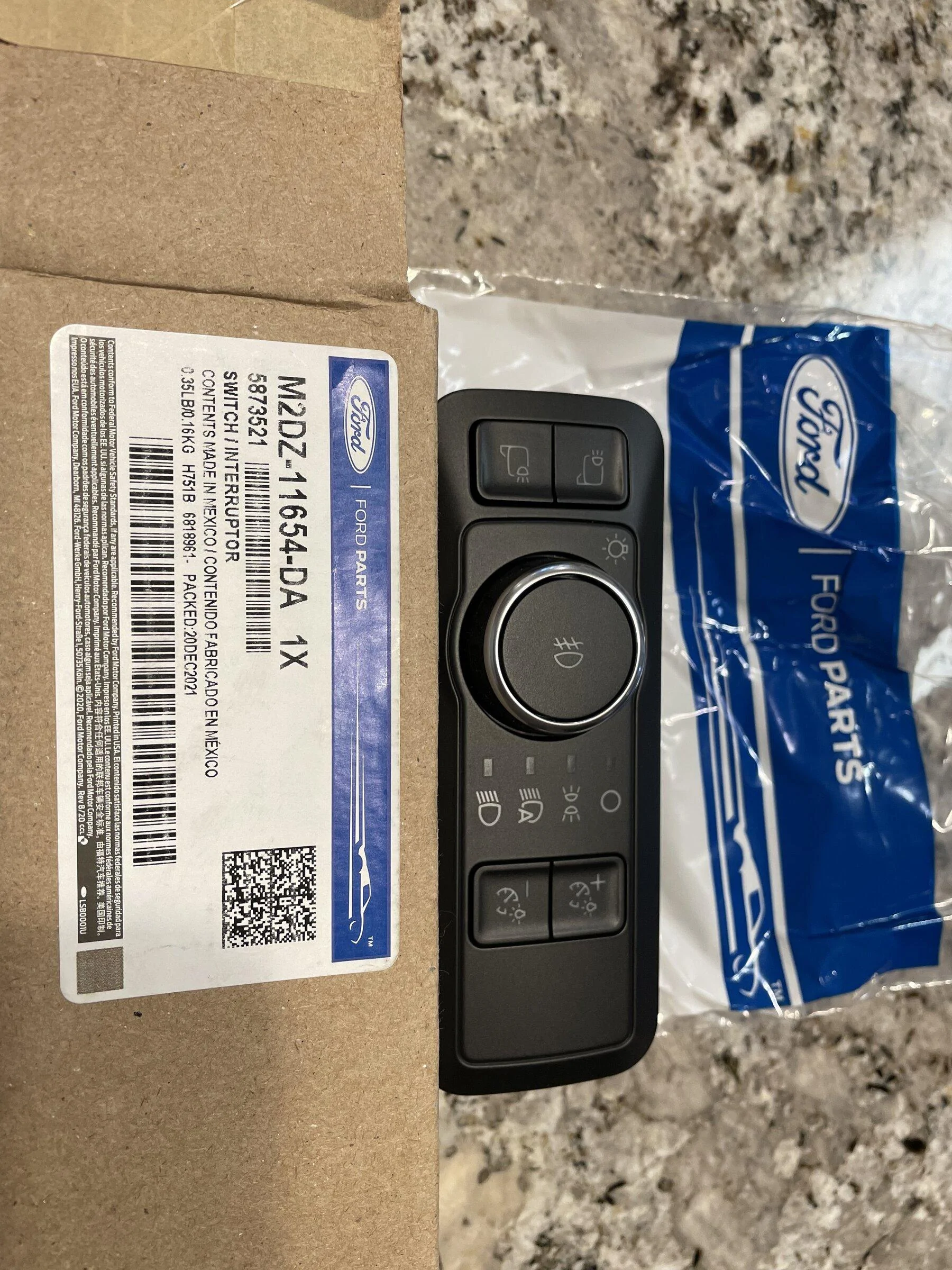

Finally! Now I just need to order a fog kit…
I know a guy... :)
Mine just shipped yesterday also. Ordered mine from Sam Galloway Ford (oemfordpartsfast.com)
4x4TruckLEDs.com
Squatch Sponsor (Level 3)
Adam
Aug 30, 2021
555
6,158
7,050
Lindenhurst, NY
www.4x4TruckLEDs.com
Hey now! Look what arrived.

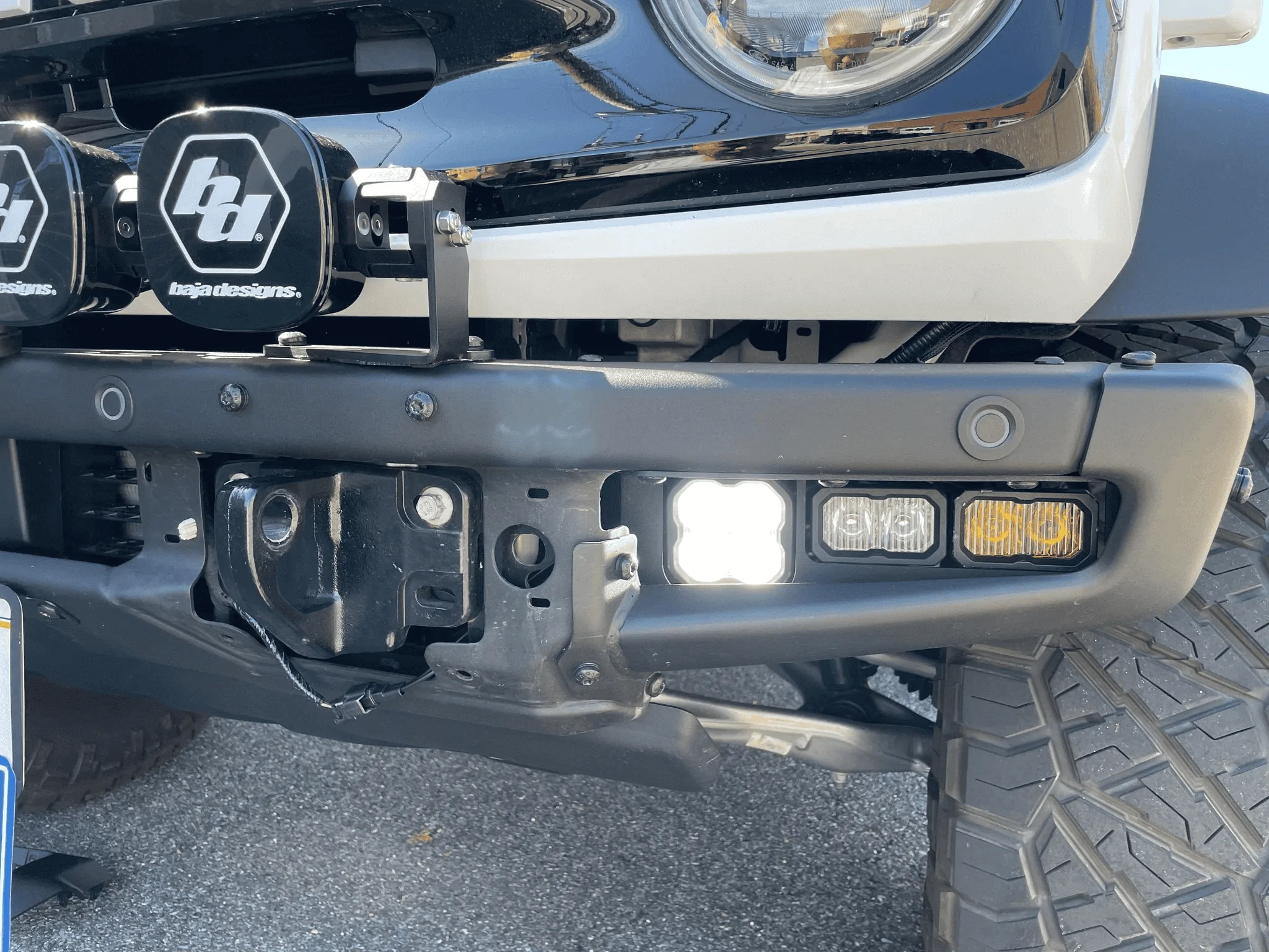

We're a bit late to the party. I mean, it's not like we sell lights for a living and this mod is RIGHT UP OUR ALLEY... right :)
Our pigtails come Friday for us to test out. If everything goes smoothly we'll start offering them to customers whom buy a fog kit from us at no charge (and when we figure out our actual costs, we'll make them available on our site).
For now, we'll make them in-house while our supplier can mass-produce them for us (which will save customers $$)

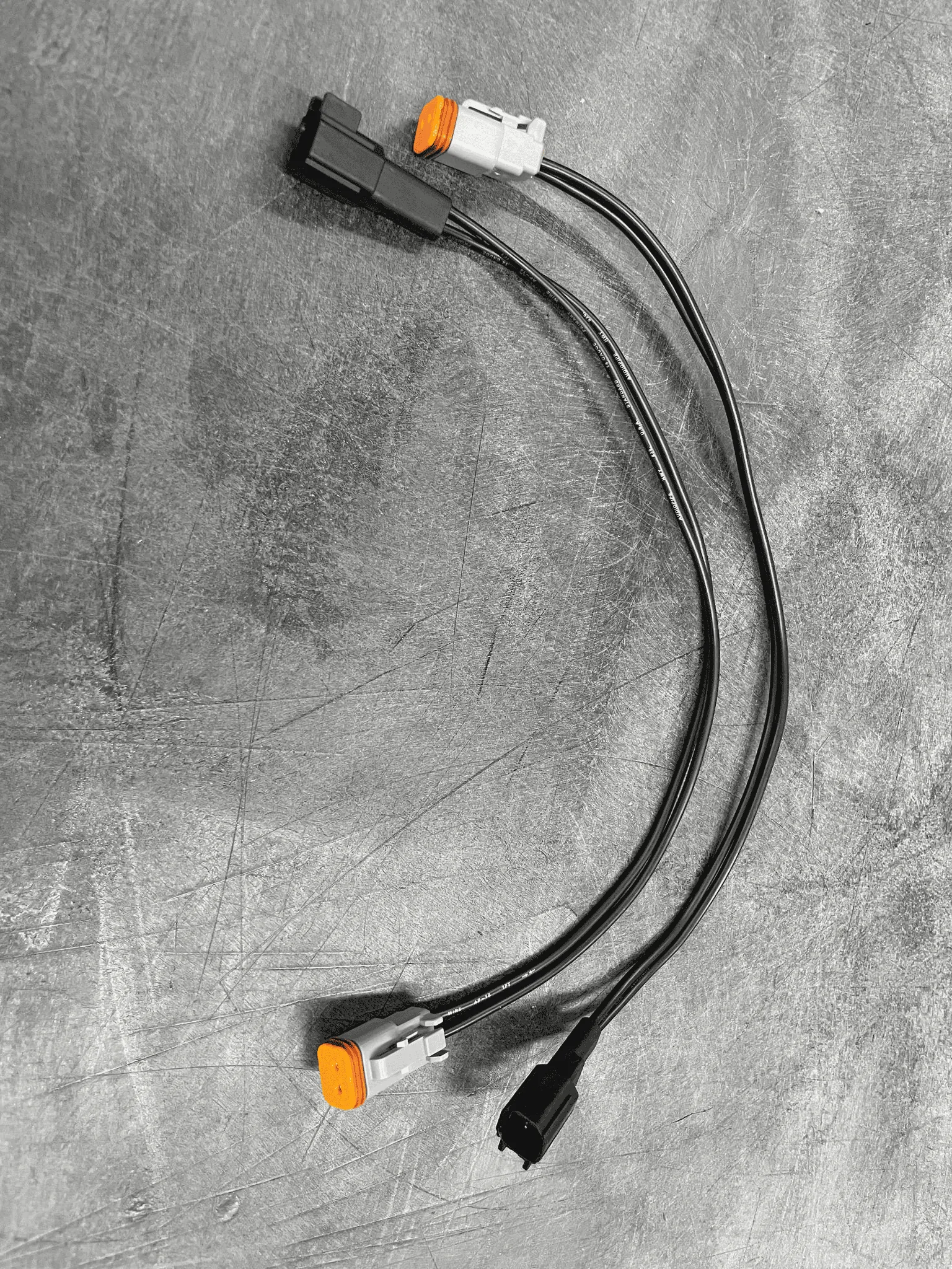

Okay so we got some connectors in, BINGO! Fits and works perfect! We'll be starting production on these soon. We'll have them in about a month or so.
They will be 20" long, which is long enough to reach the outer most pair of fogs.
They will be available with 2-Pin WP (Baja Designs), 2-Pin DT (Diode Dynamics SS3/SS6, Rigid D-Series, KC HiLites) & 4-Pin DT (Diode Dynamics SSC1/SSC2/SSC3 w/Back Light).
The 4-pin DT w/Back Light will have a 3rd wire coming off that you'll need to extend yourself up to your fuse panel and/or upfitter to control the back-lighting.
Some sample photos (we ran out of red wire, so had to use black).
Final product will be 20" long as I said and have our braided nylon wire cover over it. Pricing is yet to be determined. Figure around $20 for the pair or in that general area.

Will we need to change the factory connector to mate with yours?
4x4TruckLEDs.com
Adam
Aug 30, 2021
555
6,158
7,050
Lindenhurst, NY
No. If your HD Modular Bumper equipped truck has the factory pigtail then it'll plug right in. One way to check is just remove the 4 plastic rivet things that hold the plastic shroud around your tow point and look for the wire/pigtail . It's under that and it's attached behind it on the bottom. If you have that on each side, you'll be good to go with our harness.
If your truck DOES NOT have that, then im not sure what to tell ya. There have been reports where SOME trucks may not have the factory pig tails just left there.
Of course you also need to do FORSCAN programming and get the fog switch but that can be done easily with the data on this post.

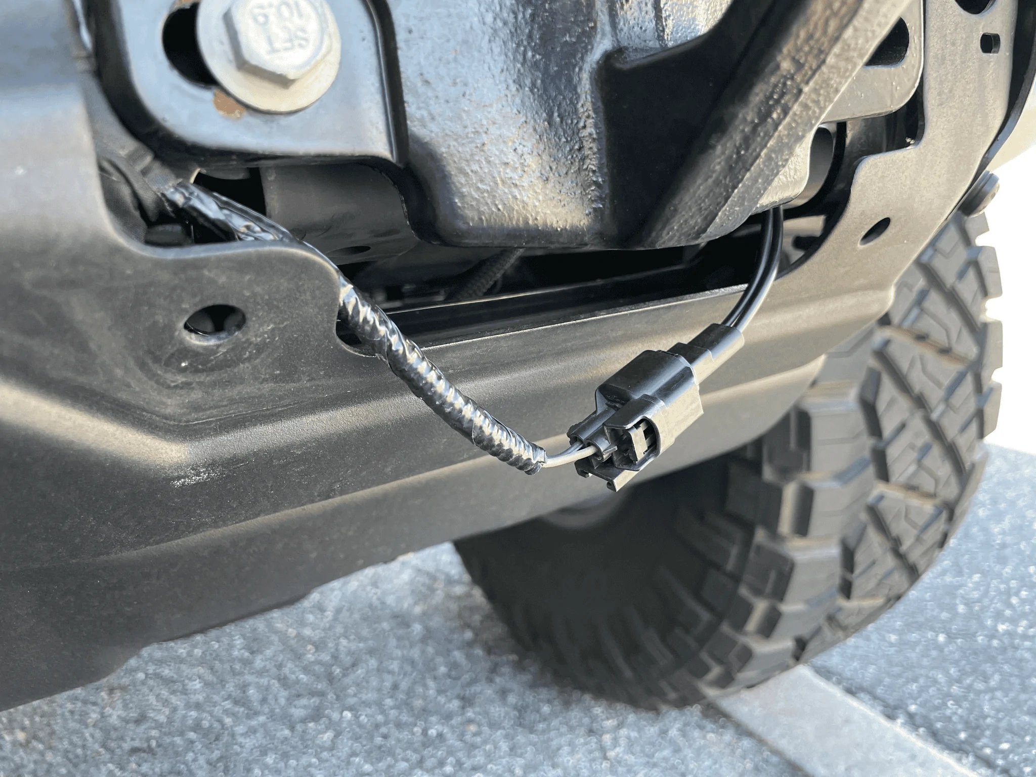

It just looks different than your picture. Or does it have a water proof cover that need to be removed? I haven't pulled it completely out since I don't have the lights.
Ford Bronco Factory Fog Light Switch IMG_20220415_150230
