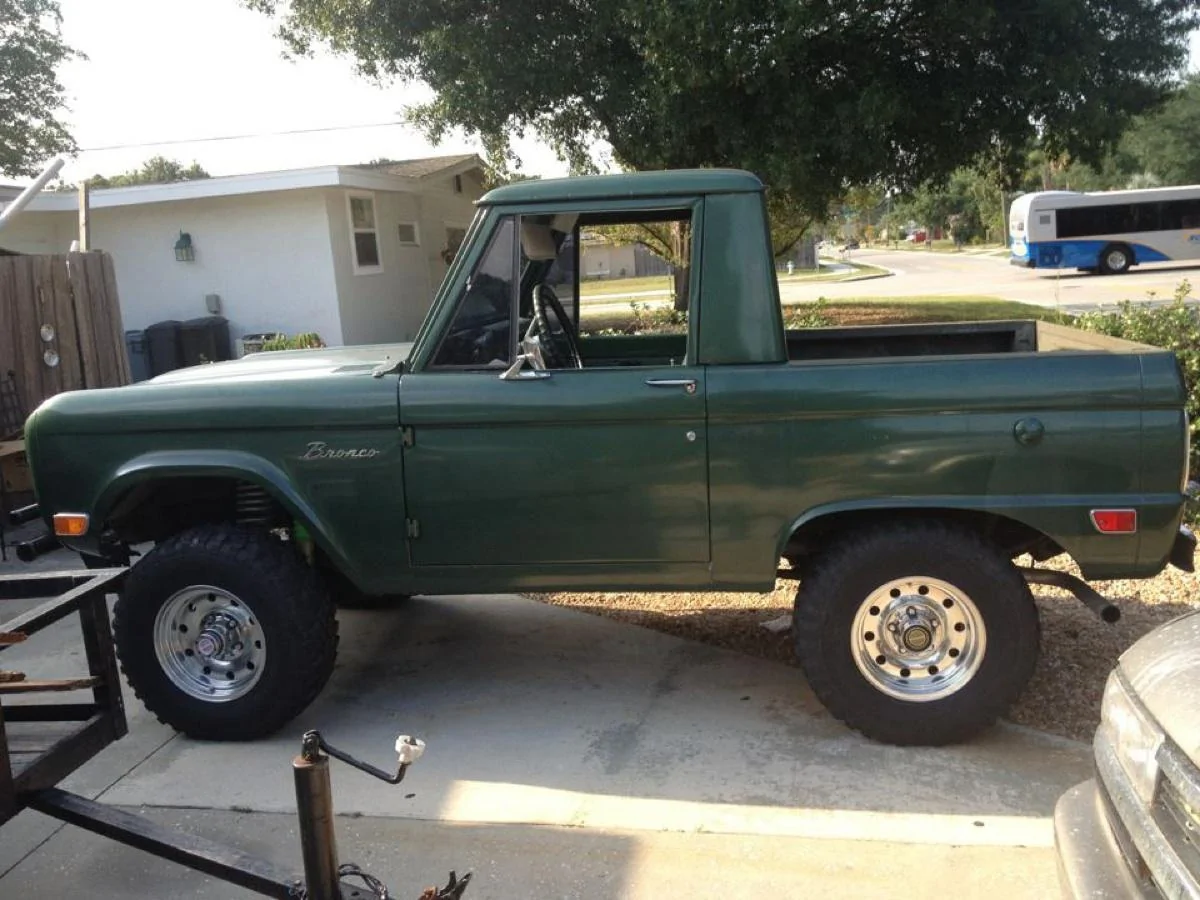

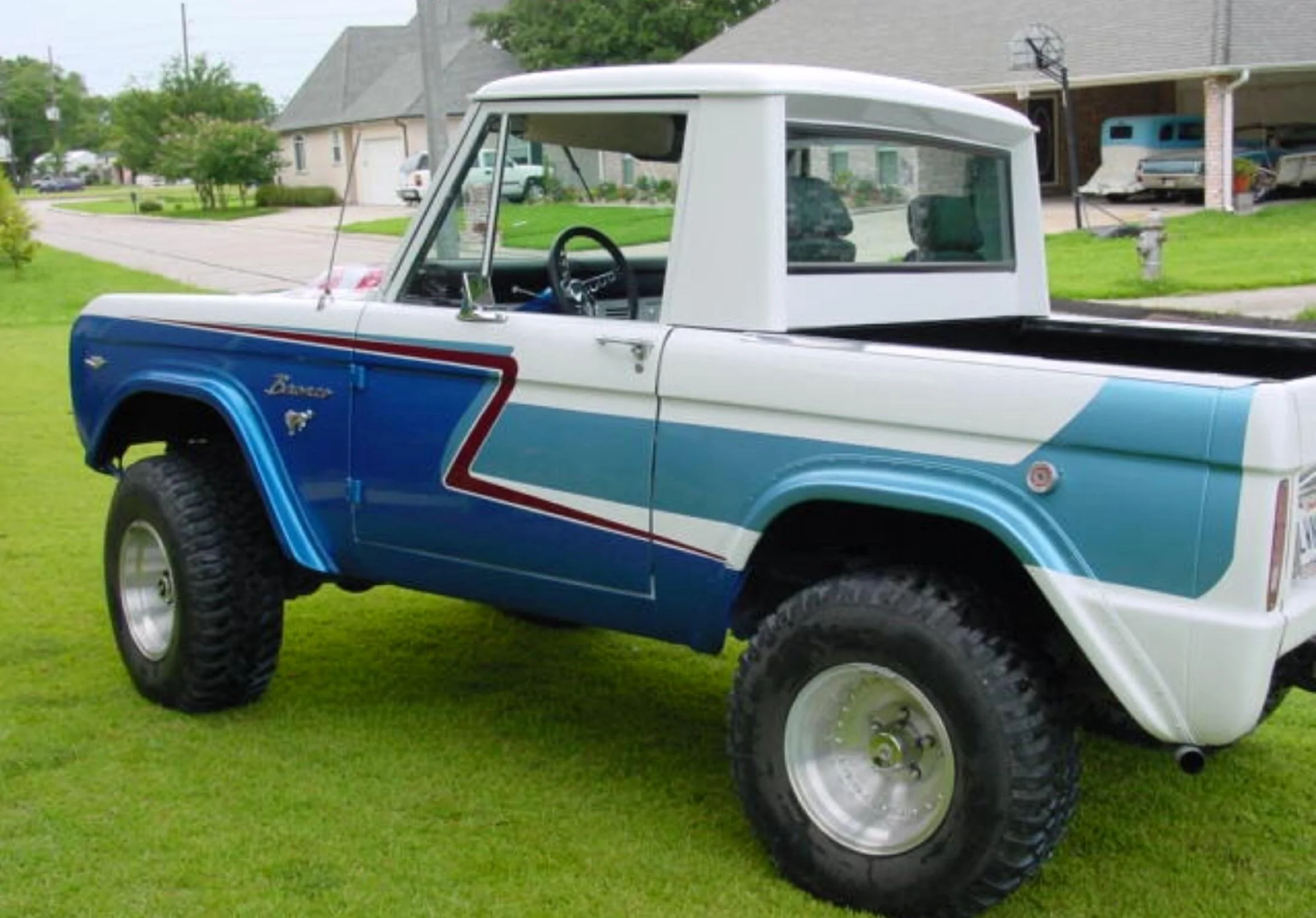

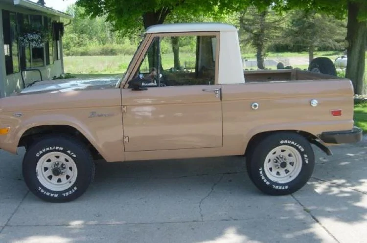

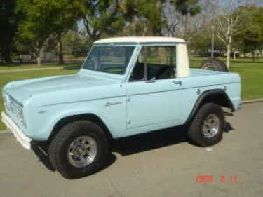

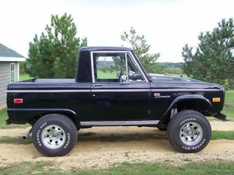

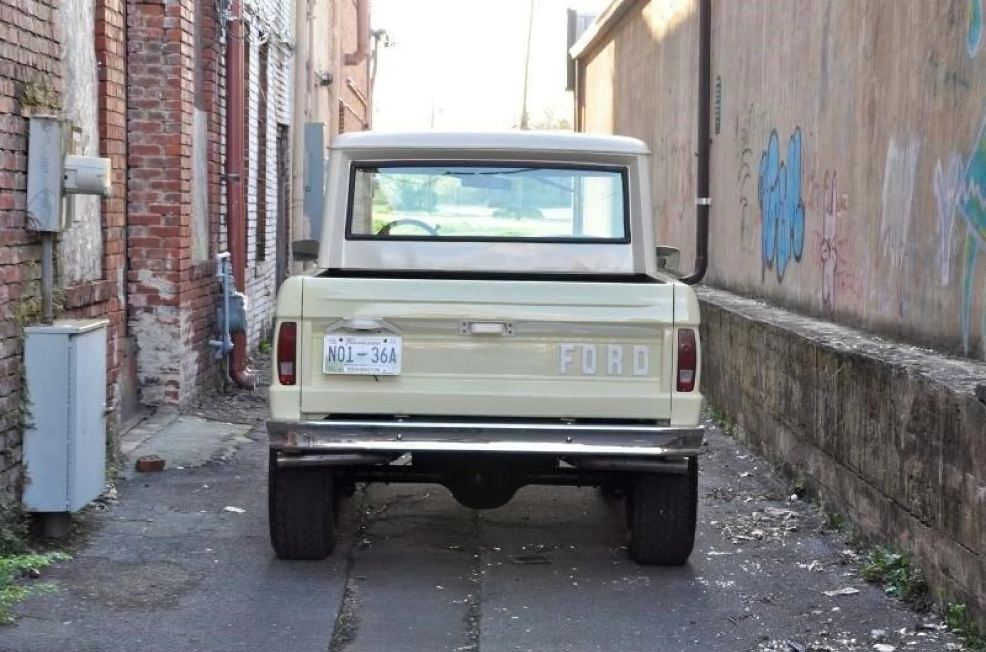

Well, it's all a matter oi taste, and utility. Lot's of those were used on farms. I've seen even smaller farm vehicles from the same time period.
