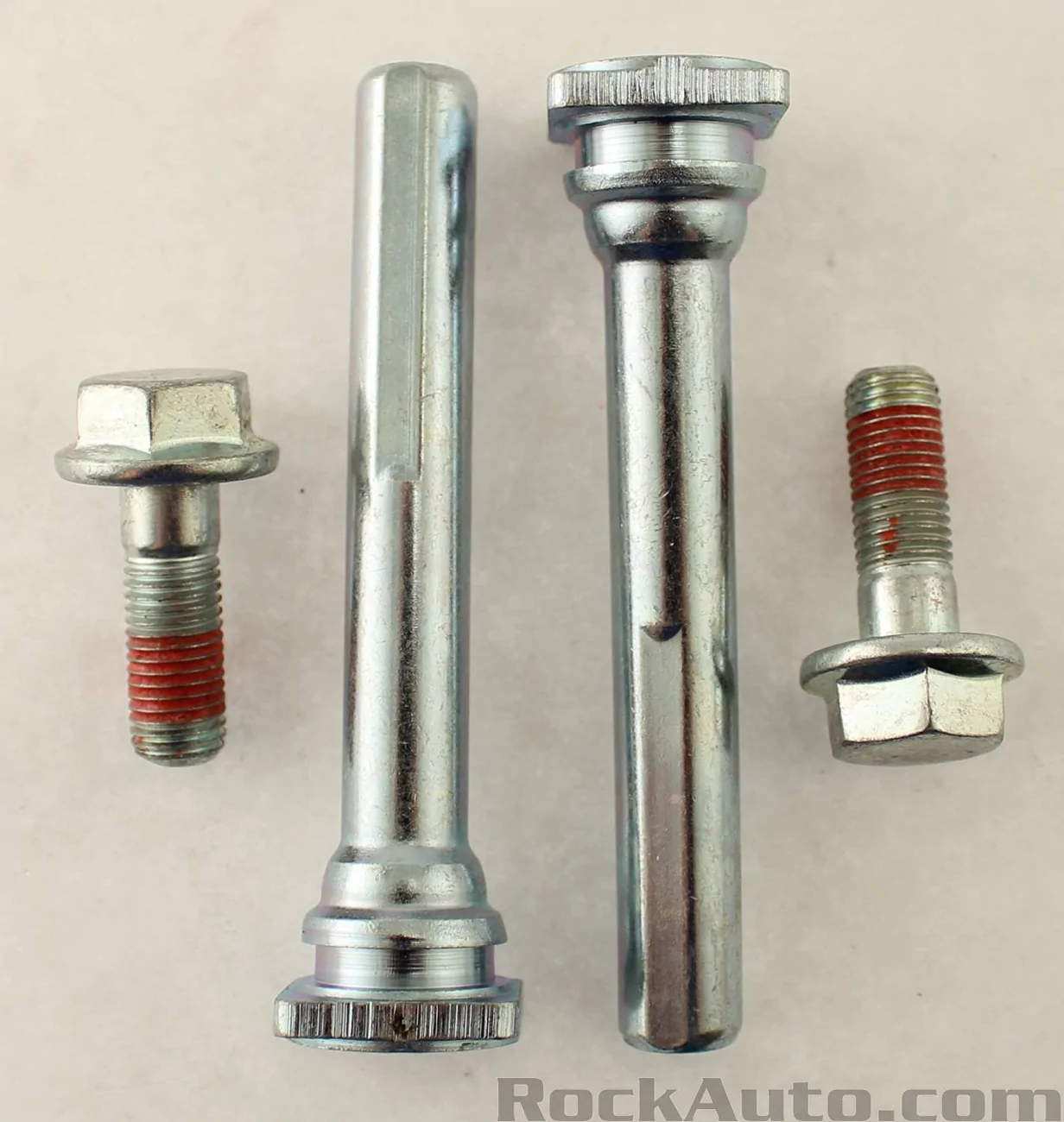

HELP!!! Snapped a bolt

I snapped a guide pin bolt on my rear caliper and ford says they don’t sell them and I have to buy the whole assembly. Anyone know where I can just get a new guide pin and bolt? Is the front the same as the rear cuz they sell a front guide pin kit.

Thanks. Looks like I’m going to have to. I was trying to get a new pin too just in case. Kinda dumb, I don’t need $150 bolt lol.

Make sure you match the grade of bolt. Not too hard nor too soft.

I would just go to any hardware store and match up an alternative bolt. Then see if you can extract the old one from the pin
Terrible advise. These are hardened, either 10.9 or 12.9. Hardware store bolts on brakes are a good way to have a catastrophic failure.

Unfortunately I have heard others making the same mistake. If you are replacing rear brake pads the torque specs are different, the guide pin torque is 22 ft-lbs not 45 as in the front.
you do realize hardware stores sell a variety of different grade bolts, right?

I find the Ace in my local town has almost any metric size or type of bolt you need. But only in 8.8.
Tractor Supply I can buy bolts by the pound and it's awesome in just about any class - so long as they are SAE. Metric it's just pre-packaged Hilman crap and very little selection.
