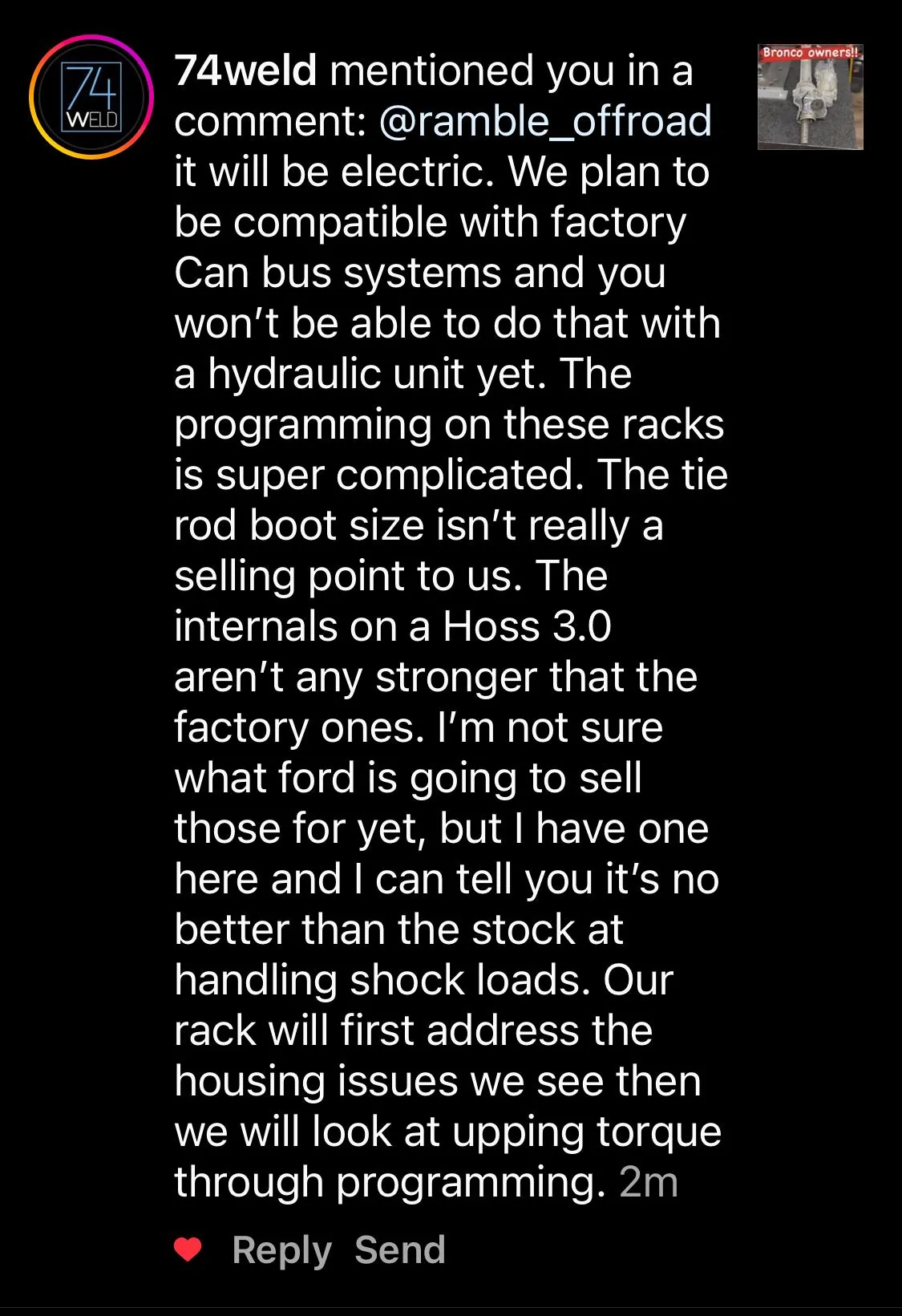

I asked the same question on IG. No reply yet. (Edit: see screen shot of reply below, electronic not hydro, etc)
Let’s just suspend the high cost potential of this item for the time being and pretend it won’t be cost prohibitive. No chatter about programming yet either which is notable.

I reached out to Tyler. He doesn’t think my rack is broken. He thinks I got mud and water in it. My tie rod boot was not seated correctly. I am seeing him Friday and we are going to fix the issue.

So billet housing, going to guess $2500 for just the housing. Hard part is going to be taking the pinion assemble with integrated control board.
They do lose a little credibility with HOSS 3.0 rack comment, definitely has a more powerful motor and metal top plate over the pinion.

Boom. Feedback from IG post.
Yeah, this was my take. Much like the Billet Housing BB has, make the rest out of Billet, leave as much meat anywhere you can for strength.
