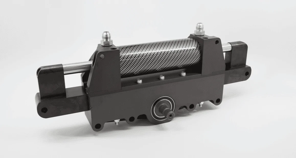

Issue is you have to have a mechanical connection per law. The other factor is the clock spring limits how many times the steering wheel can go round. Hydro steering works off engine rpm and impossible to keep centered and will eventual break the clock spring steering wheel controls.
I was thinking they ment hydro assist to the rack, not a full on hydro steering.
@BAUS67 has it right.

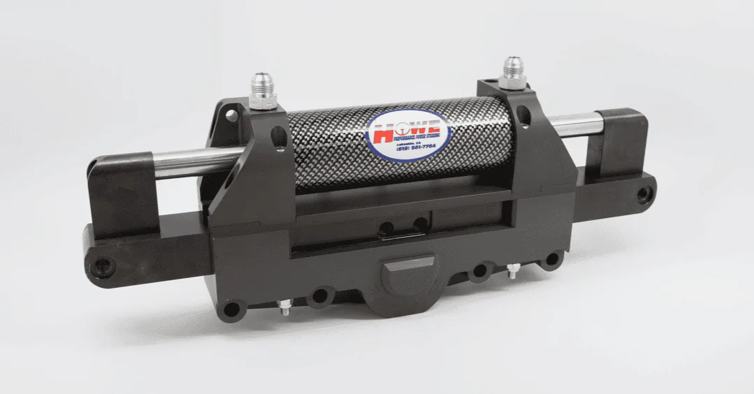

Even the biggest desert hydro race racks still have a mechanical connection, they just use an external hydro ram, instead of an internal power assist. So they would still be classified as hydro assist.

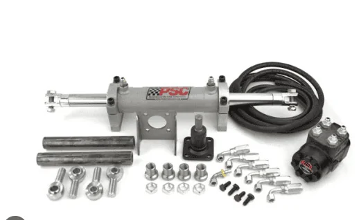

You would need a 6" bracket lift to get that to fit. I am pretty sure a psc double ended ram and an orbital valve will fit no problem. I was thinking of something that might work, not them fancy smancy stuff.
Those are the monster desert race/Ultra 4 racks. Not too practical for a stock-ish Bronco.
Adding to your 3.0 rack?

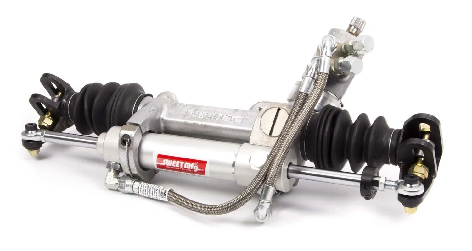

Sweet Racing does some racks with add-on assist rams. Might be a place to get some ideas for that.

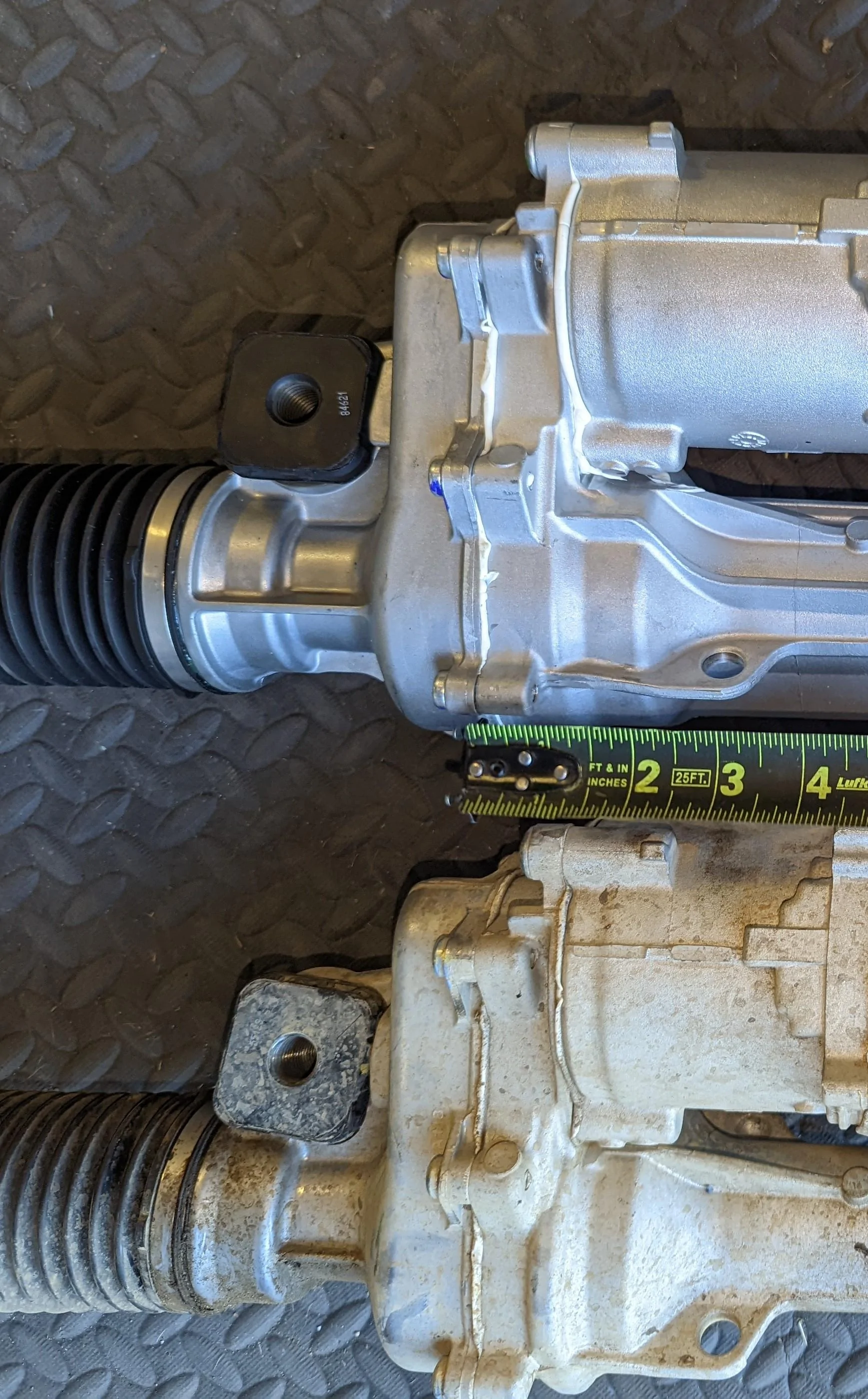

I believe the exact words were, the internals are the same......I have one here.
Oh, by the way I am home now. :ROFLMAO::ROFLMAO::ROFLMAO:
This information is just plain false....why would they say this? Simple, to stall folks from buying the 3.0 rack and waiting to buy theirs.
The electronic part is quite simple, for example Dorman has been making ford replacement racks for years, so 74weld just contracts with Dorman or similar for the electronic part.

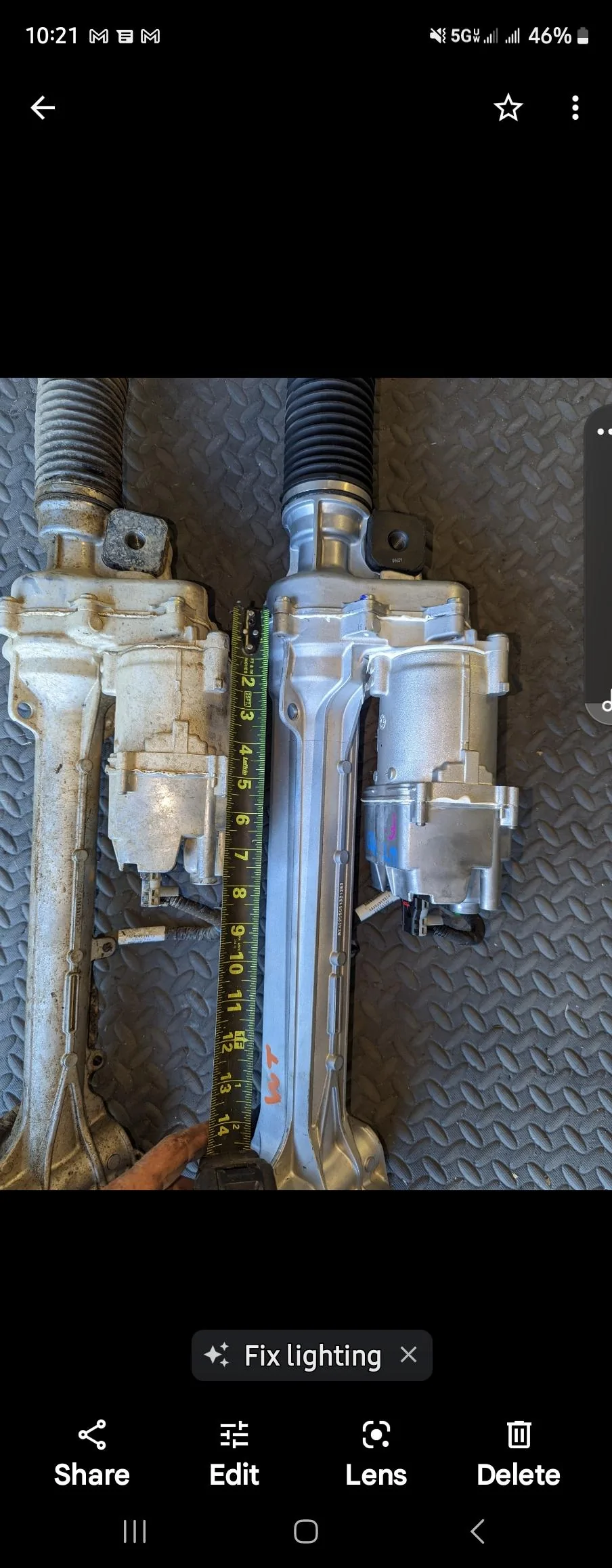

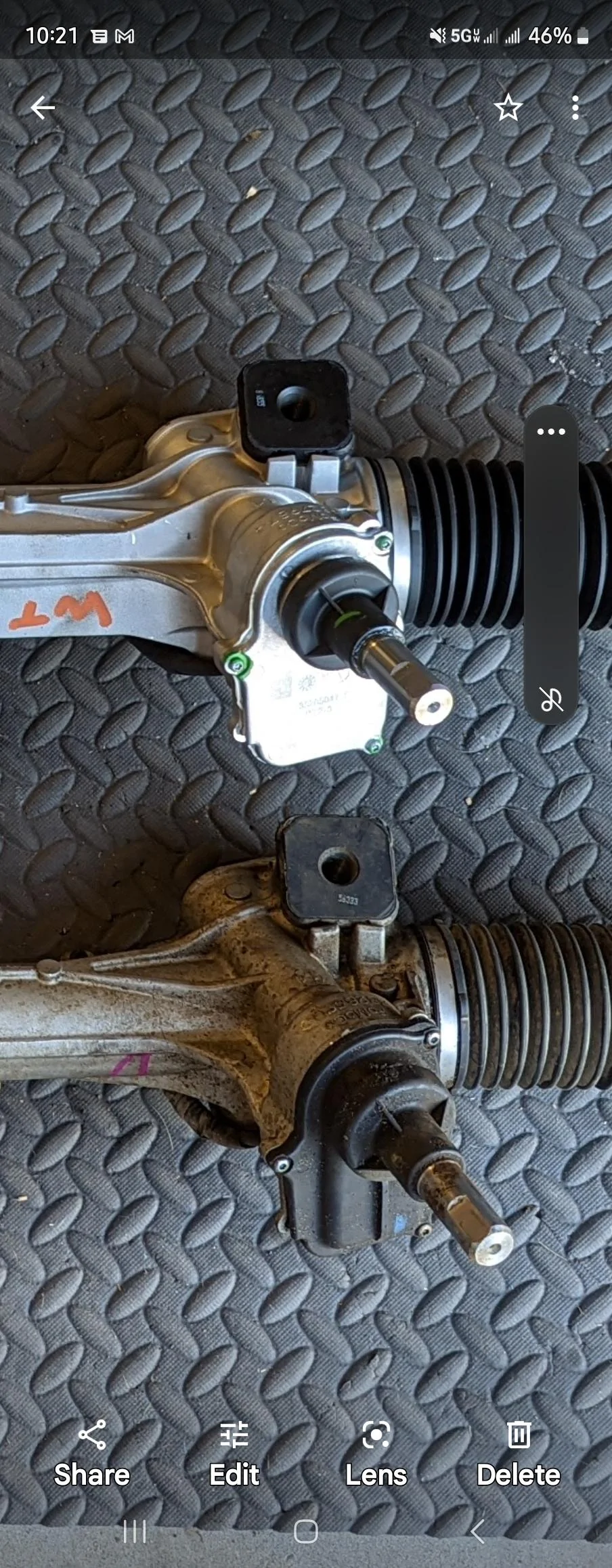

I have had both racks side by side...the aluminum housing is beefier on 3.0 and the motor is bigger, and the intermediate shaft is bigger, the tie rods are bigger obviously as well, so this statement from them only weakening there statements honesty and accuracy.
