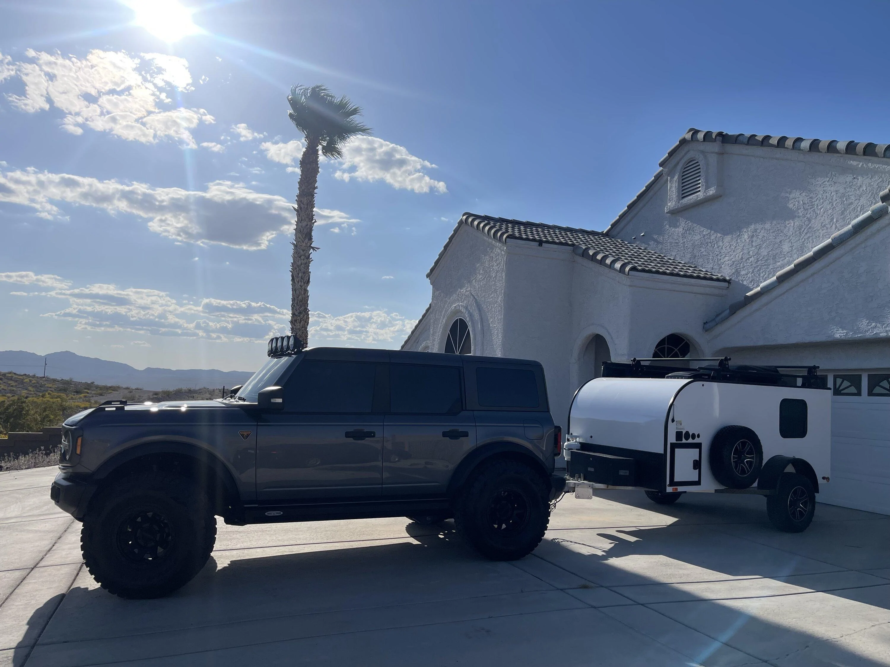

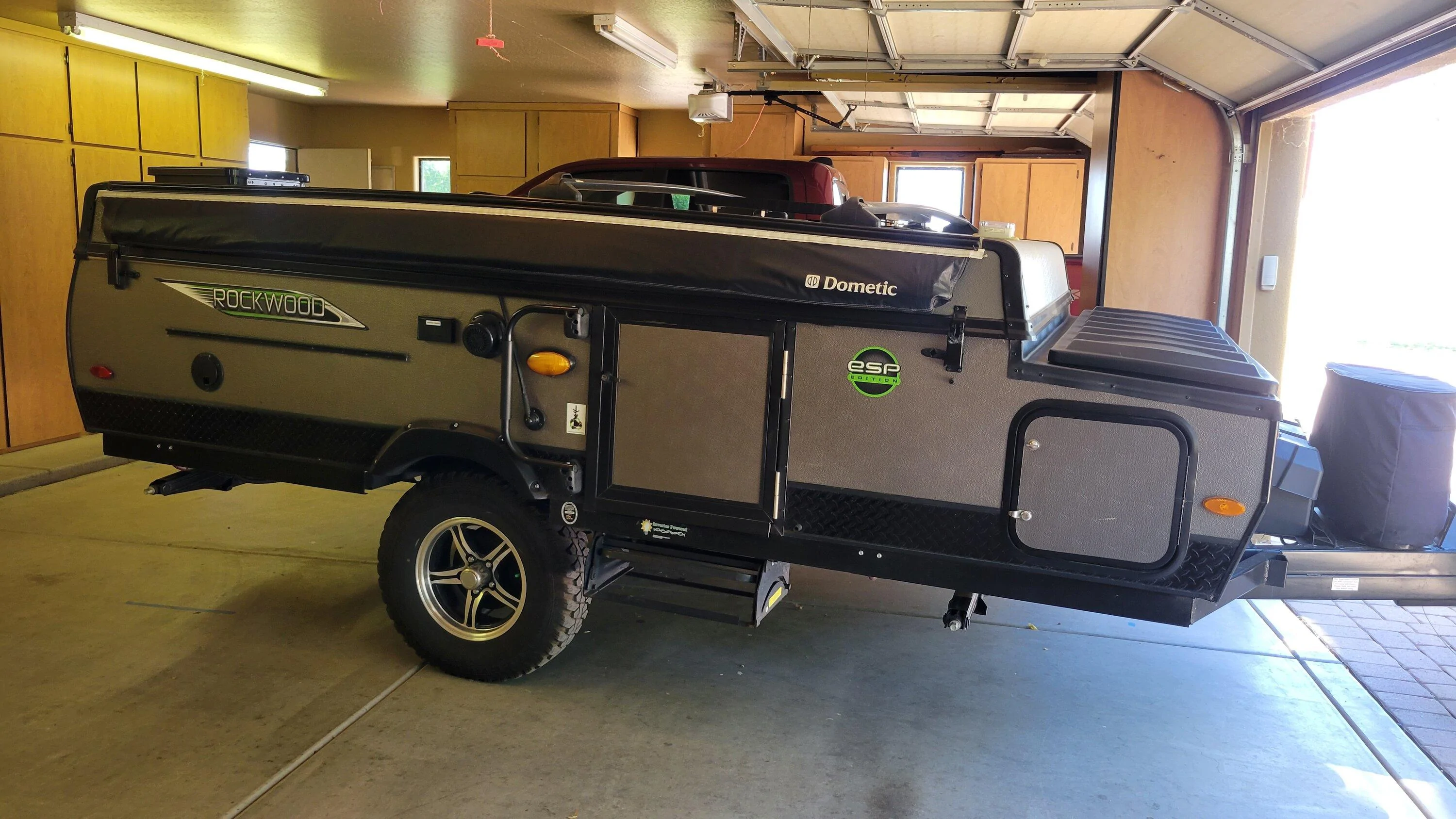

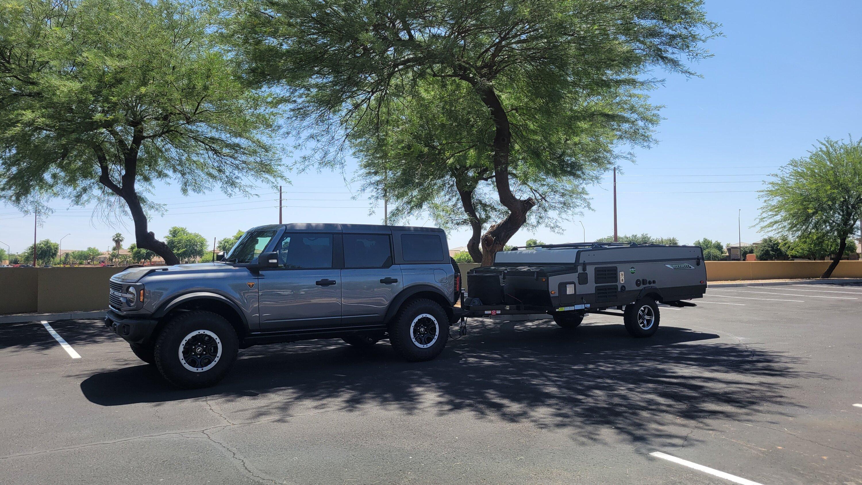

So, as you can see... there's some MAJOR squat on my girl! Part of the problem is the golf cart batteries which weigh a combination of 120lbs 😆 🤣 😂 we're replacing those with a 20lb lithium battery before I hook her up again! The pop-up's dry weight is right around 2400lbs which is well within the 3500 MAX.
Another issue is the spare tire, the rhino hitch is just shy of about 1/4 of an inch from raising to the top notch which would also alleviate some of the squat.
Any thoughts on carrying an air compressor and letting just enough air out of the spare to raise the hitch?

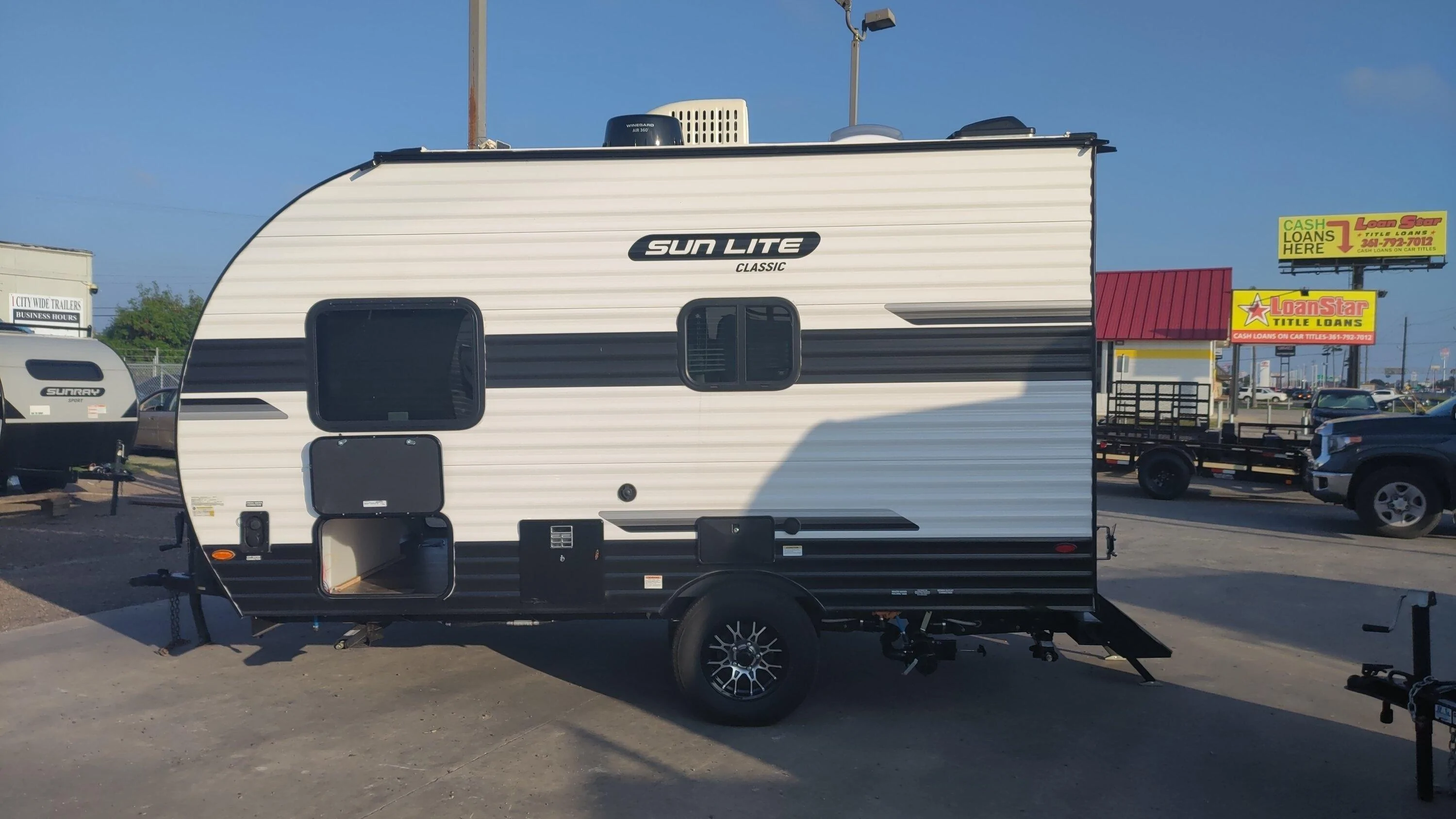

So does this look like too much trailer for a 2 door Bronco?
Ford Bronco Actual Towing Capacity (help) IMG-13df2e0ef0896bc6fe2315cf99c6ee3f-V
It's a 16 foot trailer with all the basic creature comforts including shower, toilet, AC, frig, etc. Can sleep a maximum of 4.

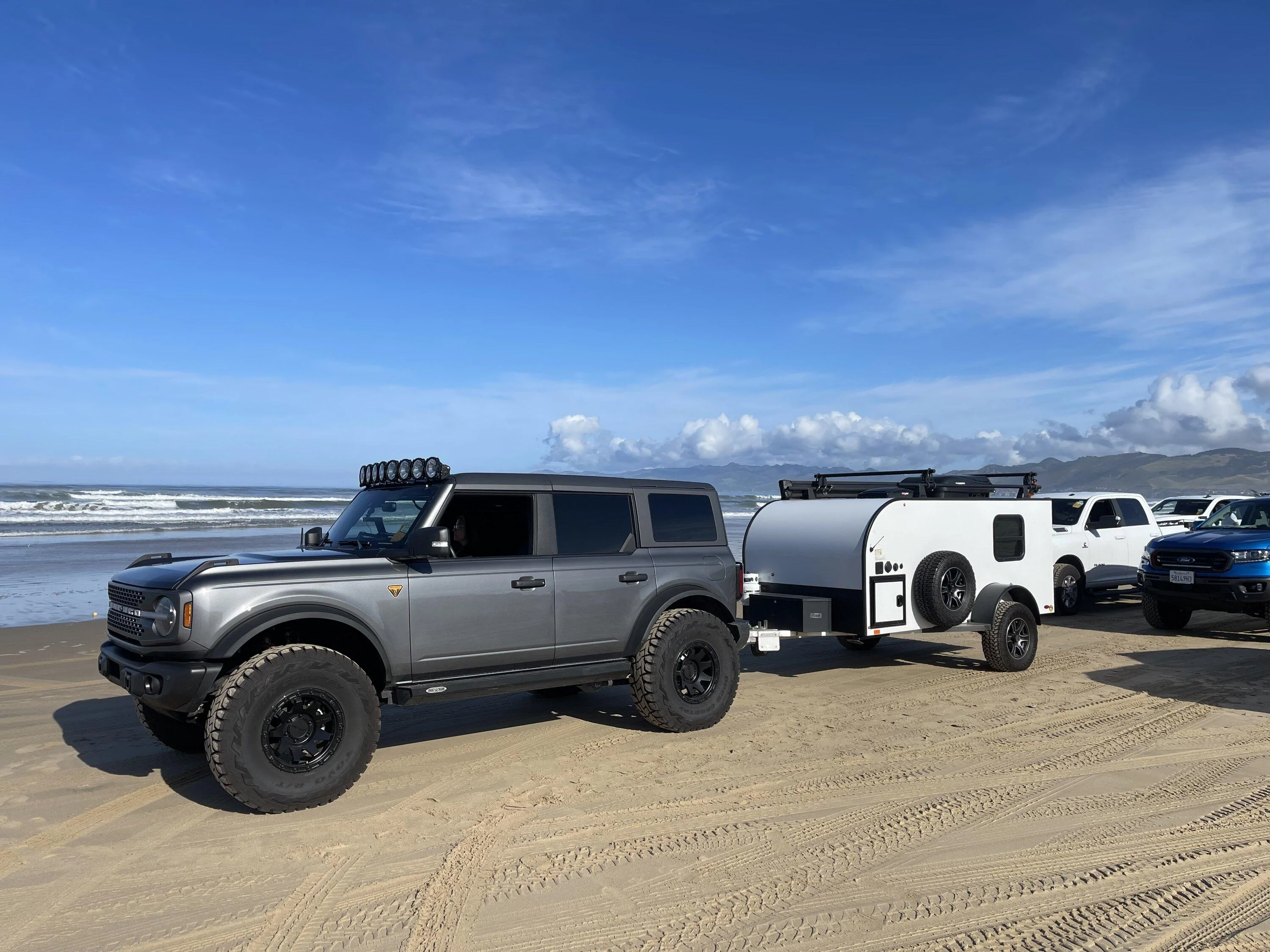

So many what if and well maybes , so after doing some research and losing the rear spare tire and replacing the coil overs and adding a little preload to get a not so sqUATTED ride. I settled for a 2021 inTech flyer pursue . Loaded down tongue weight rolls in at 350 plus or minus 15lbs depending on how loaded and well I’ve burned off a few thousand miles and let me tell you. Its tows amazing . Running the lock and roll hitch with a bit of a riser on it it seem to tow the same wether its up or down. However i totally agree with everyone on here who has said it. BRAKES BRAKES BRAKES … THEY SUCK so before you run out and try to max out the load protect yourself and make sure you have electric brakes. I’m in the process of reaching out to the great guys in lasvegas at EBC and see what they can do to help me stop the bronco. I did it on my jeep and it was night and day literally…. Safe travels everyone and thank you for all the posts that helped me get on the road…. Mountain pic was before lock and roll and preload adjustment.
I"ve been looking at similar. But I need ability to carry kayak, a cpl bicycles, a 250 quad or 2 small motorcycles (not all at once). SunRay is an option and so is Dune Sport.
Also, most of my towing would be local (under 300 miles one way) and I wouldn't be filling up on water until I arrive at my destination. A weight distribution hitch will also be needed.

What is the total tongue weight of your setup with batteries n propane. Weight distribution hitch might help even things out. Broncos only have a 350lb tongue allowance.
THANK YOU for responding!!!
We were over 400lbs... Those batteries are really heavy, 120 lbs. Once we switch those out for the 20lb lithium, I will weigh again, hopefully I will be under 350. Can you recommend a decent
weight distribution hitch?

So, we changed out the battery yesterday and switched to smaller propane bottles... went from a 2-inch squat with over 400 lbs of tongue weight to 3/4 of an inch of squat! What a huge difference. My friends that I share the pop-up with have a RAM with an astronomical tow rating, so we weren't too concerned with weight since the Bronco took so long to get. We knew we would have to make adjustments... I am still looking into a weight distribution hitch. Keep me posted if you find one you like.
