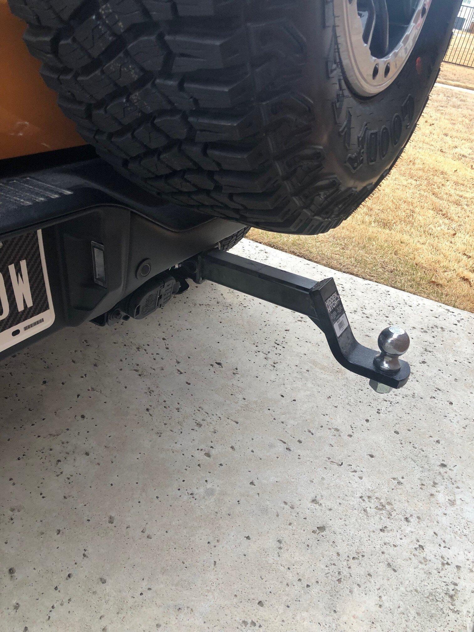

Whatever you do,you will need an extended hitch bar to clear the spare tire. Mine has a 4" drop and it makes everything sit nice and level.
This however makes the capacity go down 50%:
However, when you use a hitch expander, you must keep in mind that your tongue weight capacity will be reduced by 50%. For example, if your hitch has a 200-lb maximum tongue weight, it will be reduced to 100 lbs.
Ideally, you hook as close to rear axis as possible even if you need to raise or delete the spare.

Properly loading your trailer makes this a moot point. You should not be loaded to the tongue weight anyway. Just tongue heavy enough to keep the trailer tracking properly.

Agree but sometimes the "anatomy" of the trailer does not give you all the options:
Tongue Weight- 280lbs
https://mammothoverland.com/amenities/
I am solving the puzzle of the articulating hitch weight (ARK), avoiding the spare, tongue weight increasing with the load of propane tank, hitch etc.

You should have a minimum of 10% on the tongue. Given that the Broncos listed maximum tongue weight is only 350lbs, every bit that extender adds to the tongue weight, also decreases maximum towing capacity. Not a moot point, if someone wants to pull a 3000lb trailer.
It is a moot point. If you do the math a hitch that's 2.5" longer only adds about 13.24% of the leveraged weight, not 50% that was quoted elsewhere. I saw almost no difference in the ball height from the pavement with a normal bar verses the one I have now with the same trailer loaded the same way. But it is much easier to hitch and latch. The towing capacity remains the same. The bar length does not affect this. BTW none of us has addressed the OP question.
What length is that extended mount?

Most trailers are likely going to require a drop hitch on the Bronco so they sit level. I’d try one of those without an extender and that’d likely get most trailer tongues to clear the spare (but I could be wrong…). To my knowledge drop hitches don’t have much impact on towing capacity of the tow vehicle. I’m open to being proven wrong on that too. ;)
Anything I tow is with my truck and not my Bronco so I admit I’ve never tried hooking anything up to my Bronco but I’ve towed a bunch of different things the past 30 years with several different 3/4 and 1 ton trucks.

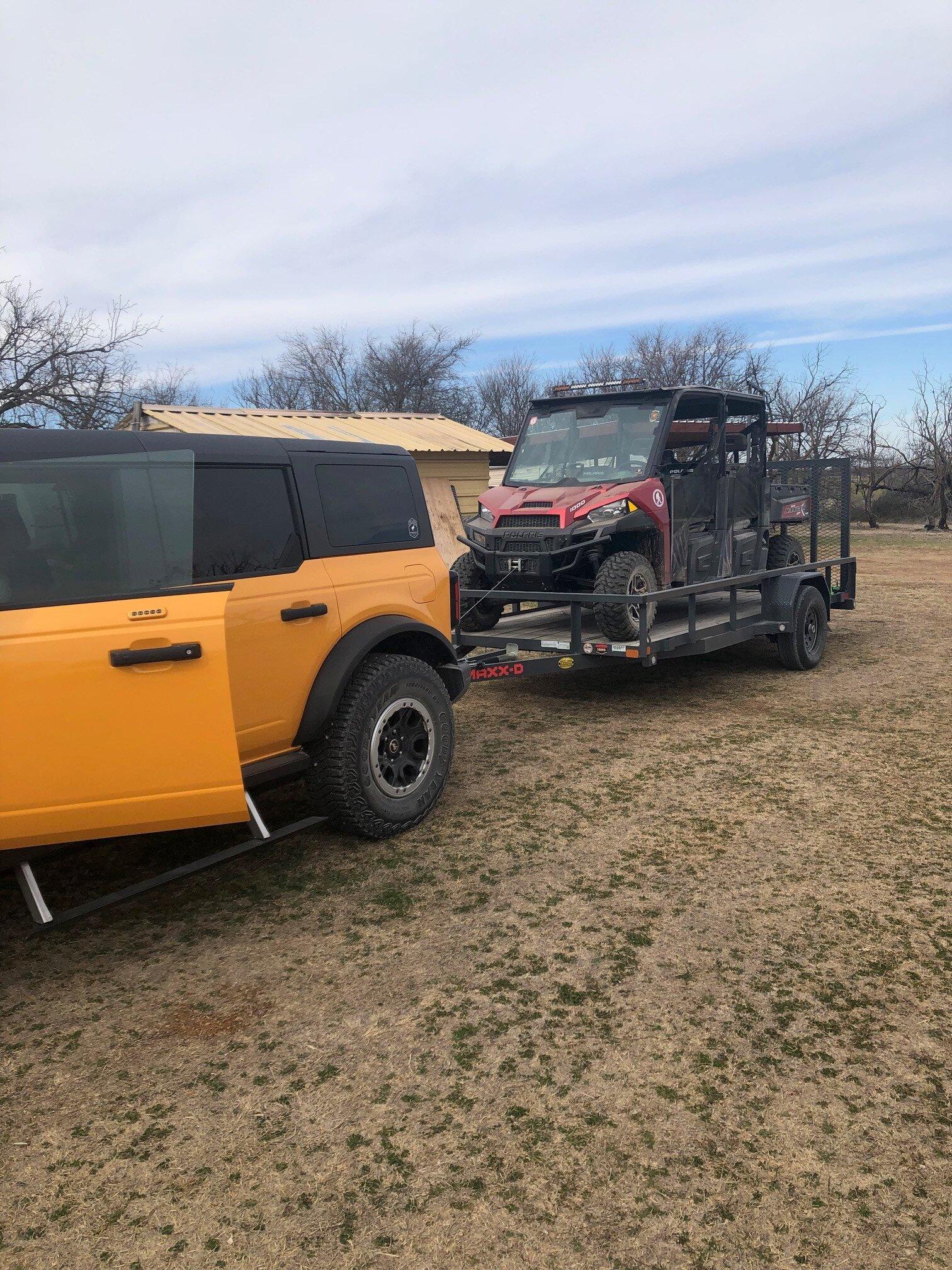

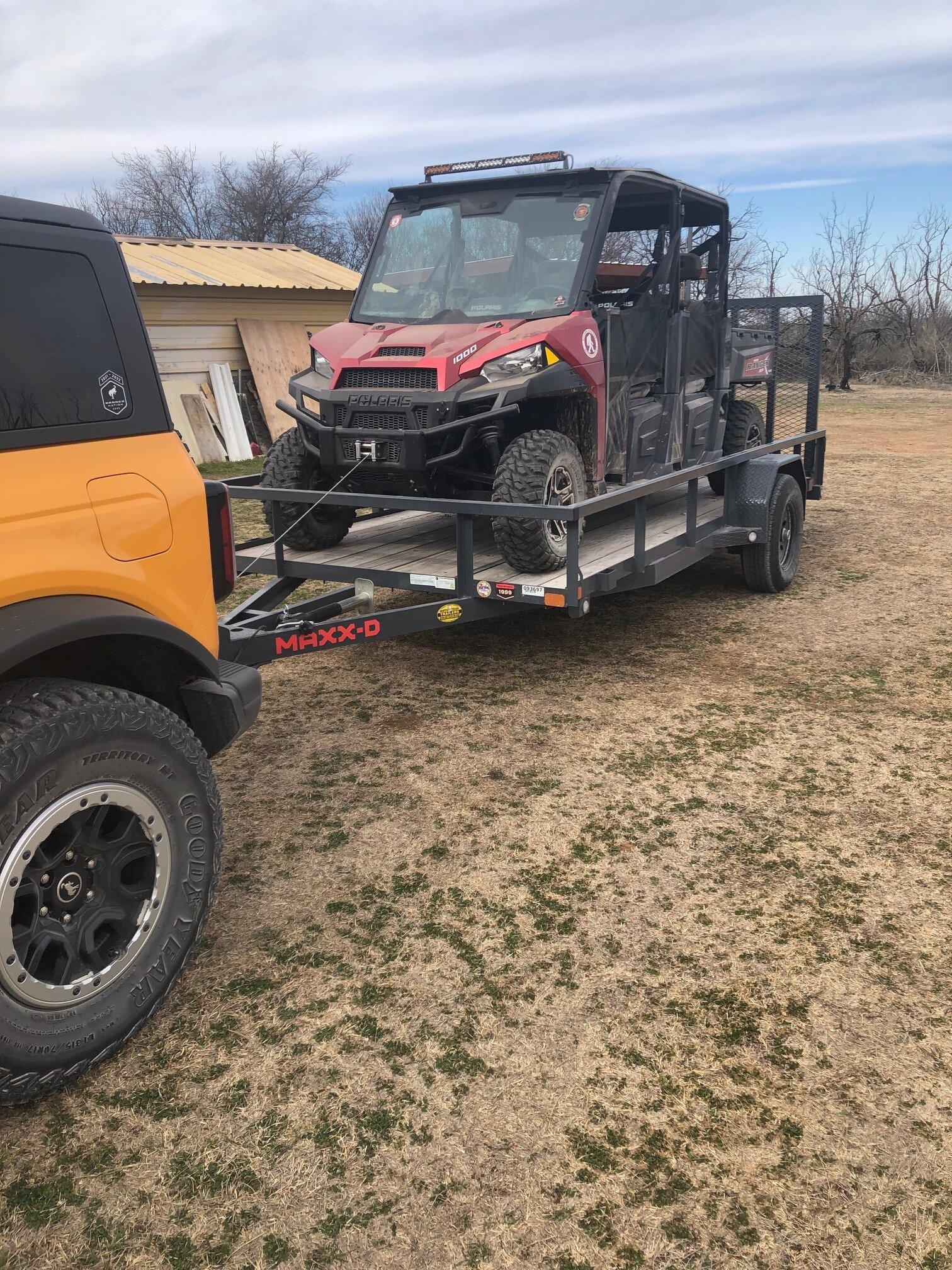

I drag this setup around with no problems. Weight is approx. 3,600# trailer with Ranger on it.
I pull this same setup with a 2dr and it pulls good

5" lift and 37s running a 6" drop hitch. Doesn't take a physics wizard to understand how the leverage from the drop hitch could bend the receiver.

I would probably move the spare to my trailer before I ran an extension like that. Even with tongue weight properly adjusted I'd be worried about lateral forces leading to things getting squirrely. I err on the safe side when it comes to towing and vehicle extraction, though, so maybe it's fine.
