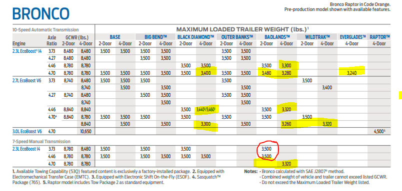

Not every Bronco has a 3,500 pound towing capacity. Badlands and Black Diamond (due to the skid plate weights) generally have lower capacities.
Of course, this guide has errors. Even Ford doesn't have the correct rear axle for a 2 door Badlands with a 7MT. The only rear axle is 4.7 gearing. It should be 3,500 pounds of towing capacity for a 2 door 7MT Badlands. And they forgot about the ManSquatch option.
