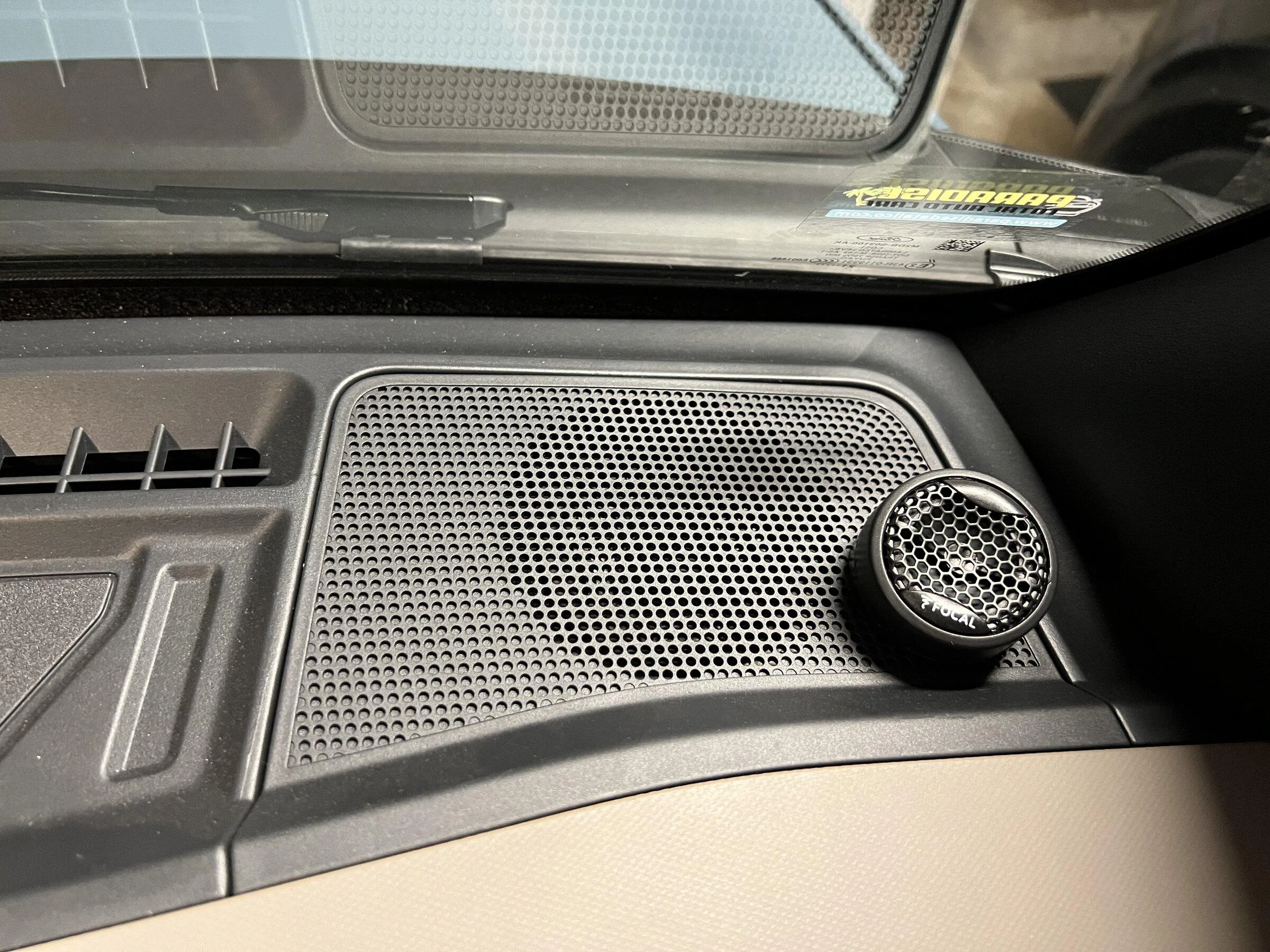

I installed JL Audio VX700/5i amp (which has an integrated DSP), Focal Performance 165AS3 component speakers in the front,
Where did you mount the tweeters?

1991 Chevy, 2004 Cooper S
Bottom outside corner of dash speaker grill.
Ford Bronco Base Audio Upgrade and Forscan ADF3042B-A174-4AFA-AF64-510A2175E61B
Oh thanks for the pic....looks good! I have a set I need to fit in when I get a bronco
