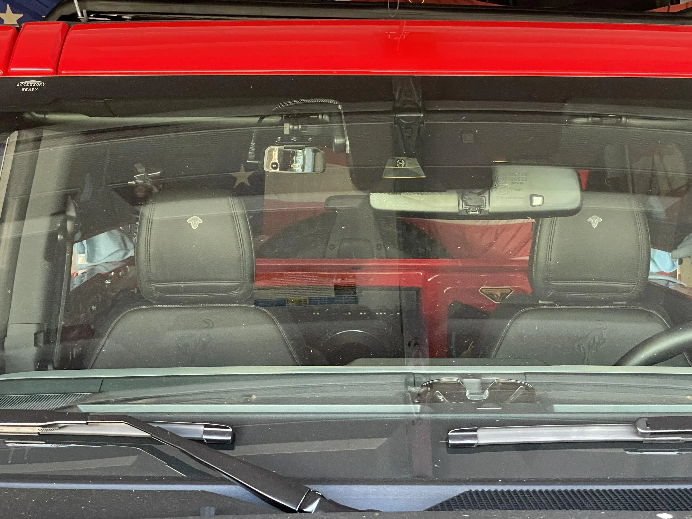

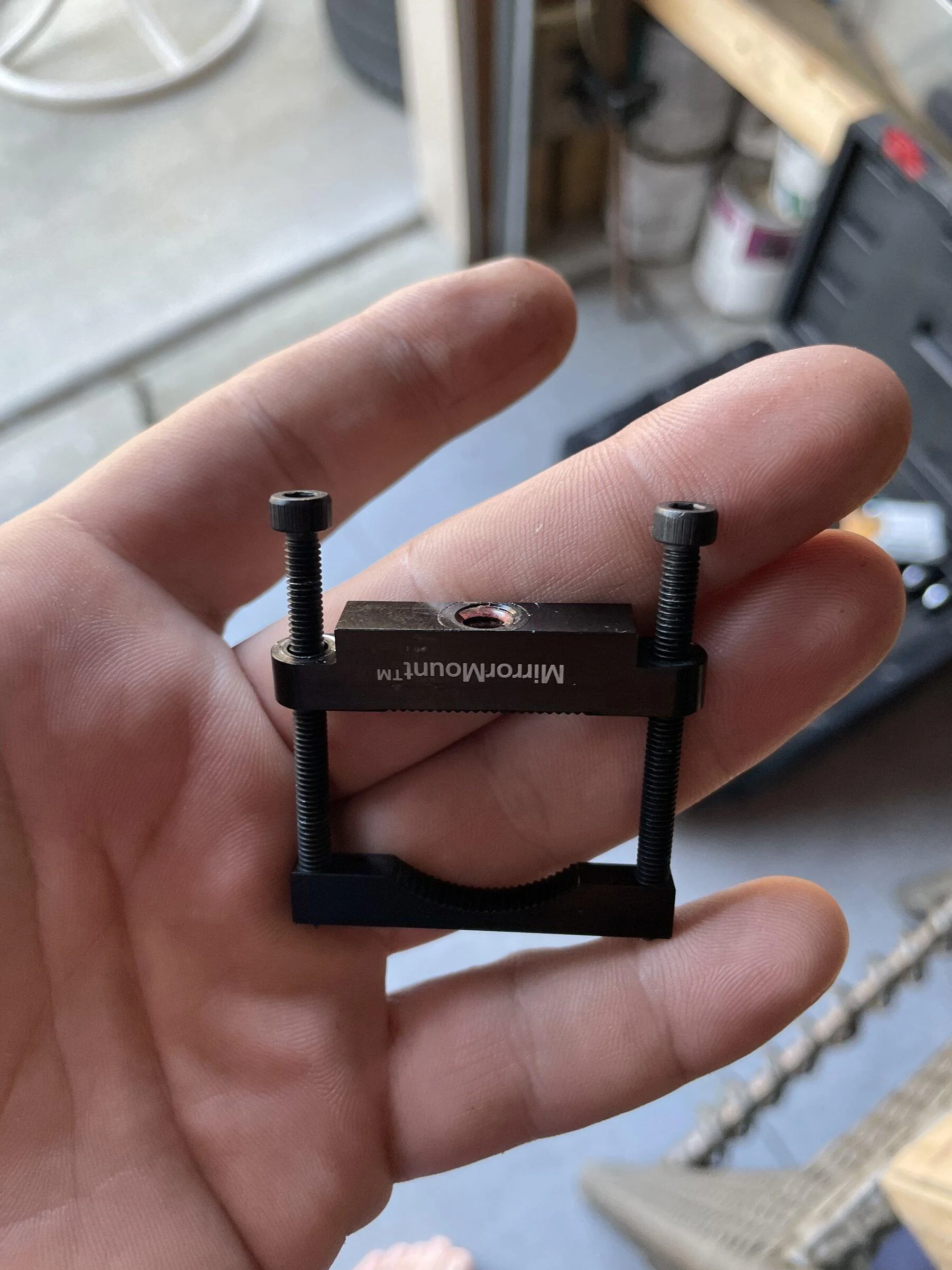

Can’t stand cords hanging. Took a bout a week but figured out a clean install. This was for a k40 install but they have the parts for many detectors available on the Amazon.
This install takes 10-15 minutes, requires no disassembly.

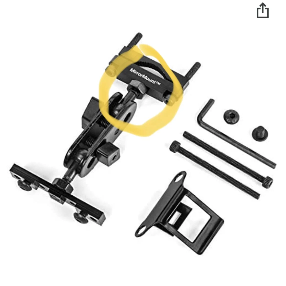

First step is to acquire the 3 parts that are listed. Wire tap with small pin adapter, detector bracket with threaded ball ends, tesa tape, because you’re a man.

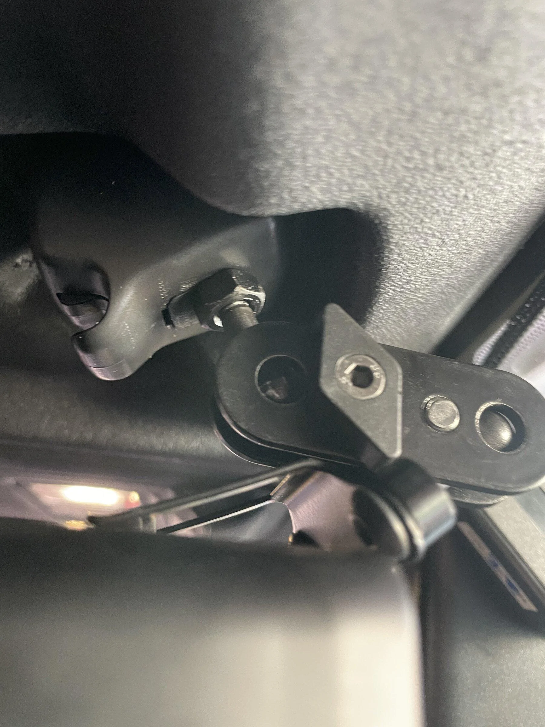

First remove the end of the bracket off of the threaded ball. Nut is 7/16.
Drill a 3/16 hole into the passenger visor mount. Then screw the stud into just before the nut touches. Then use the 7/16 to tighten the nut. Firm is good. Don’t go all super man on it. I’m old so I just put mine in the drill chuck to start it.
Use a Allen wrench to tighten the mount wing nuts into the proper position

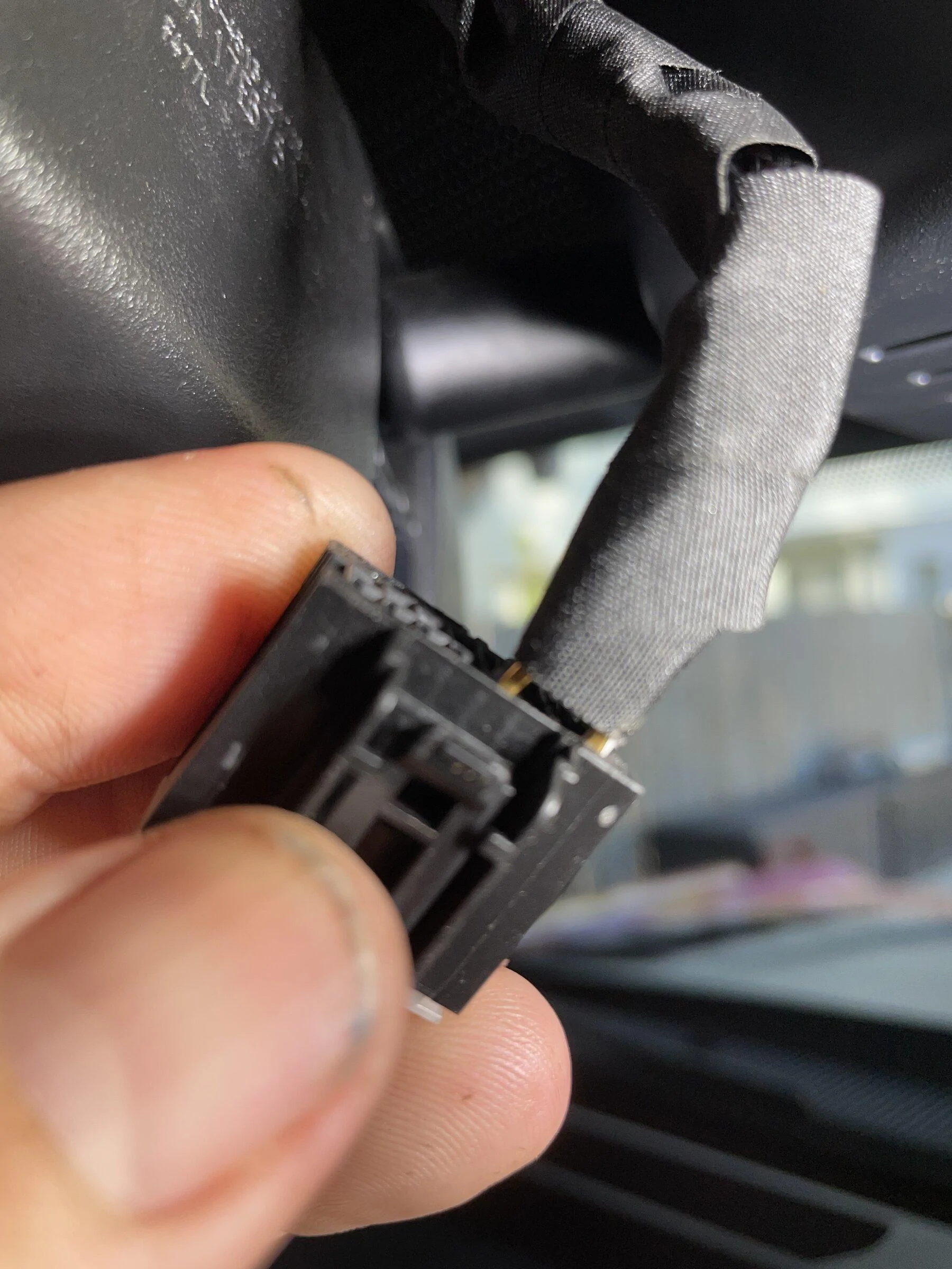

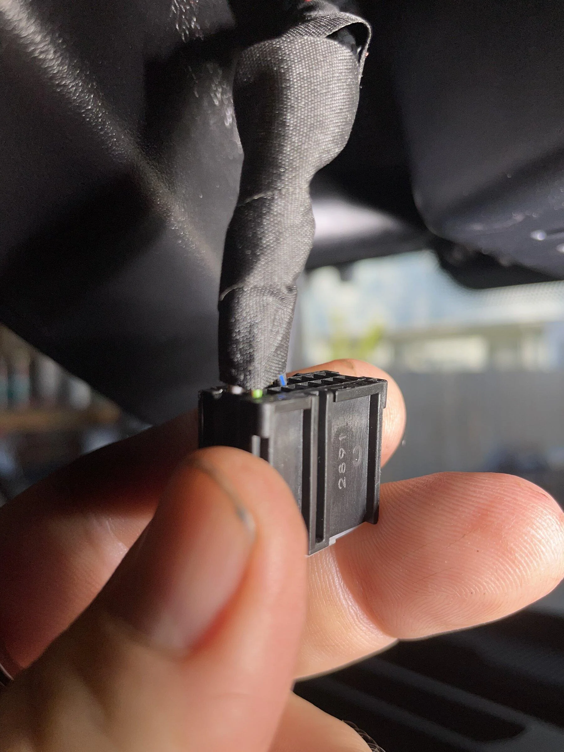

Unplug the harness from the back of the mirror. It has 3 wires. White, black and blue, green. We will be inserting the small pins into the black for ground and the white for power. This is a switched 12v off the ignition. You may have to use a set of pliers to force seat them all the way.
Use your “man tape” to wrap what’s not black.
Thats it’s.

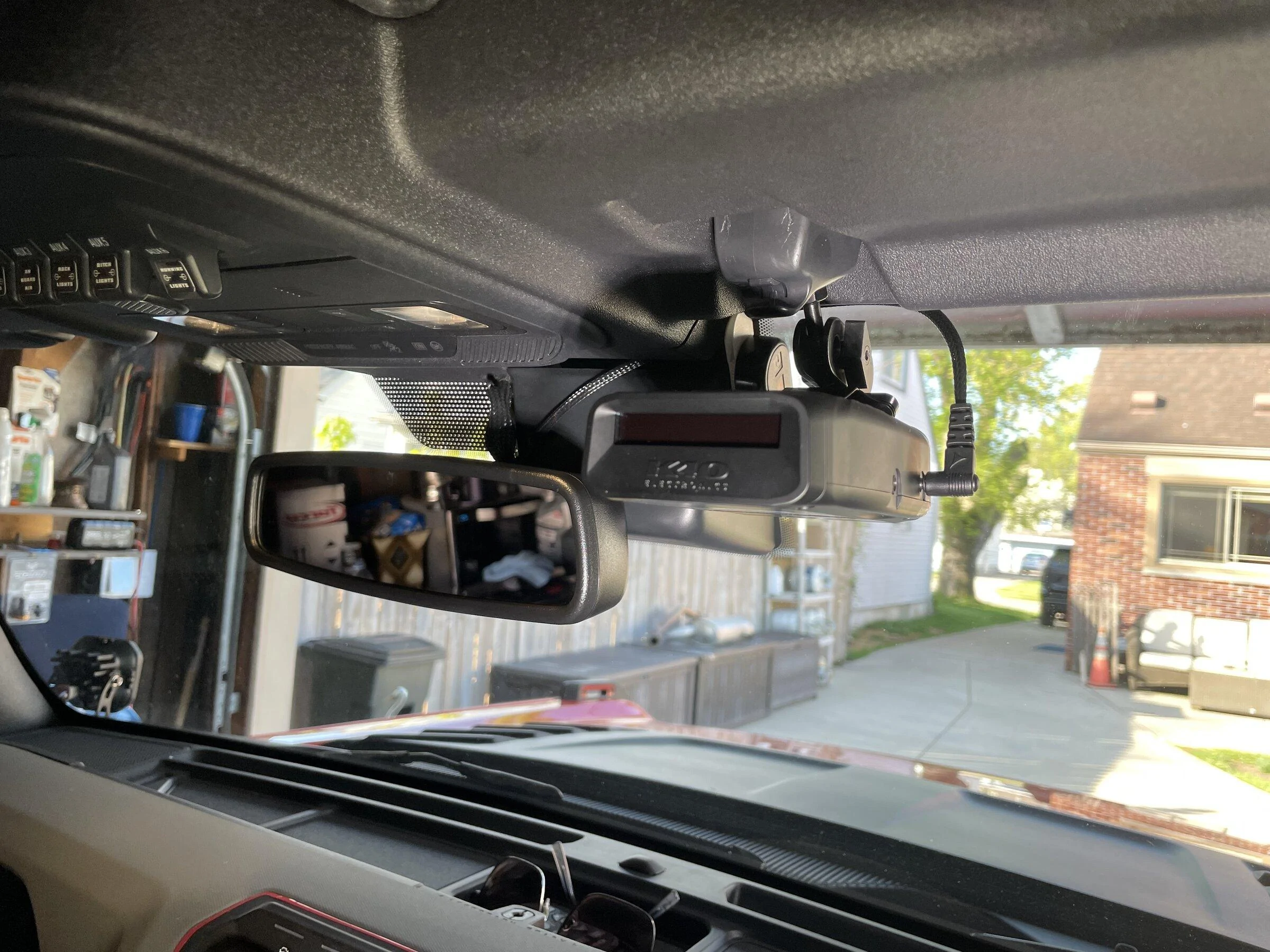

Detector mount must be this style with the threaded ball joints on the end. Just grab the appropriate one for your brand detector.
https://www.amazon.com/Radar-Mount-Detector-Bracket-Detectors/dp/B06Y2K9CC4/ref=mp_s_a_1_1_sspa?crid=JYNPZIIIS4YX&keywords=k40+radar+mount&qid=1652615875&sprefix=,aps,68&sr=8-1-spons&psc=1&smid=A4ZR0KLVOENJ2&spLa=ZW5jcnlwdGVkUXVhbGlmaWVyPUExUEpKWTBXTDRIS0dPJmVuY3J5cHRlZElkPUEwMDM0MTczMlA2M0dVSUNKUkpWWiZlbmNyeXB0ZWRBZElkPUEwODA1ODAwMU44WjZRVjcxTThHSiZ3aWRnZXROYW1lPXNwX3Bob25lX3NlYXJjaF9hdGYmYWN0aW9uPWNsaWNrUmVkaXJlY3QmZG9Ob3RMb2dDbGljaz10cnVl

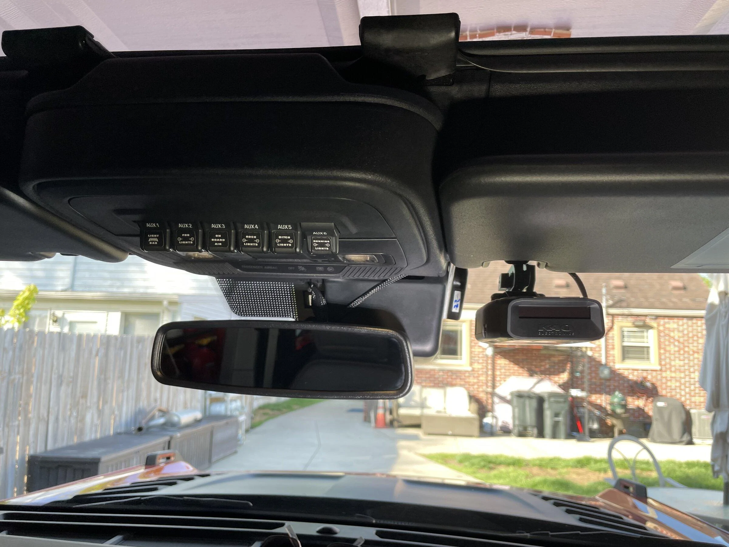

I purchased this USB adapter for my Radenso DS1, also a clean way to do it and steps down to 5v for a USB detector.
https://www.amazon.com/gp/product/B088P4VFQ7/ref=ppx_yo_dt_b_search_asin_title?ie=UTF8&psc=1
I’m looking for the clean way to mount the detector. Mine has a 1/4-20 mount on top, so I can probably use your idea for tapping a Ram ball mount to the visor mount and a ball on the detector.
Nice! That plastic was pretty thick and mounted good. Detector is real stable compared to the suction mount. Took me about 30 minutes running down options for mount locations. Plus it has some depth behind it.
