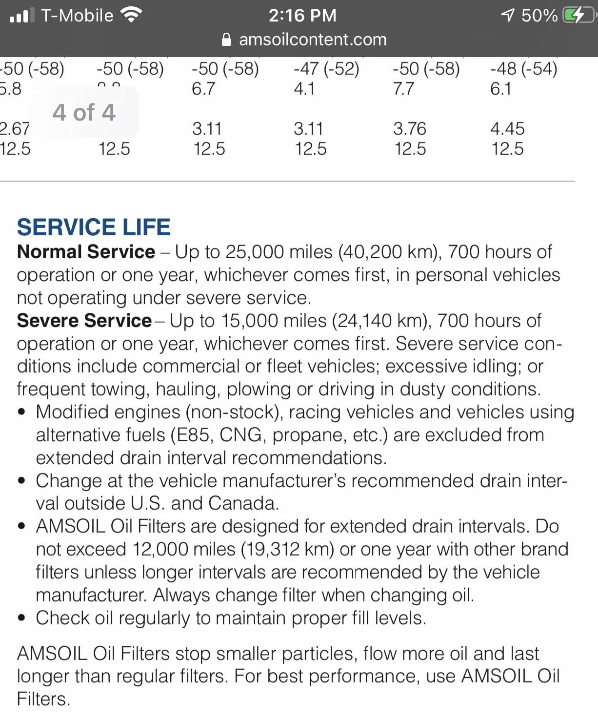

If you are looking for the best protection, performance and durability, nothing beats a full synthetic oil. It is going to help immensely on 10k+ oil change intervals being as 10k miles could be roughly a year or so worth of driving for most people. So the amount of start ups, especially with the stop/start system and the climate changes over the course of a year, a full synthetic oil is the best. Now if you want my opinion on oil change intervals, I highly recommend 5-7.5k. Simply it’s the cheapest insurance money can buy.
Thank you. Here is the ams oil 100% synthetic signature series service intervals below. To make sure I understand you correctly, you recommend changing it every 5k miles? Or was your recommendation for an oil that had a shorter interval than the one I just attached the picture of?

If you go full synthetic, 7.5k is the max I would go. Reason being like I’ve said before, if you wait until 10k sometimes you get lazy and it gets stretched to 12k and beyond. Also if your going that long on the oil, it’s probably been in the motor for 12 months or so and to me that’s a lot of key cycles, start ups and climate change depending on where you live
Thanks for the reply. 6 to 7k is where I push it. I use Amsoil Signature Series 5w30 in my 2012 Mustang GT that has 51,000 miles on her. I know Ford recommends 5w20. But I've read some through lubricating oil analysis reports that recommend the Amsoil Signature Series 5w30, even if the Manufacturer recommends 5w20.
