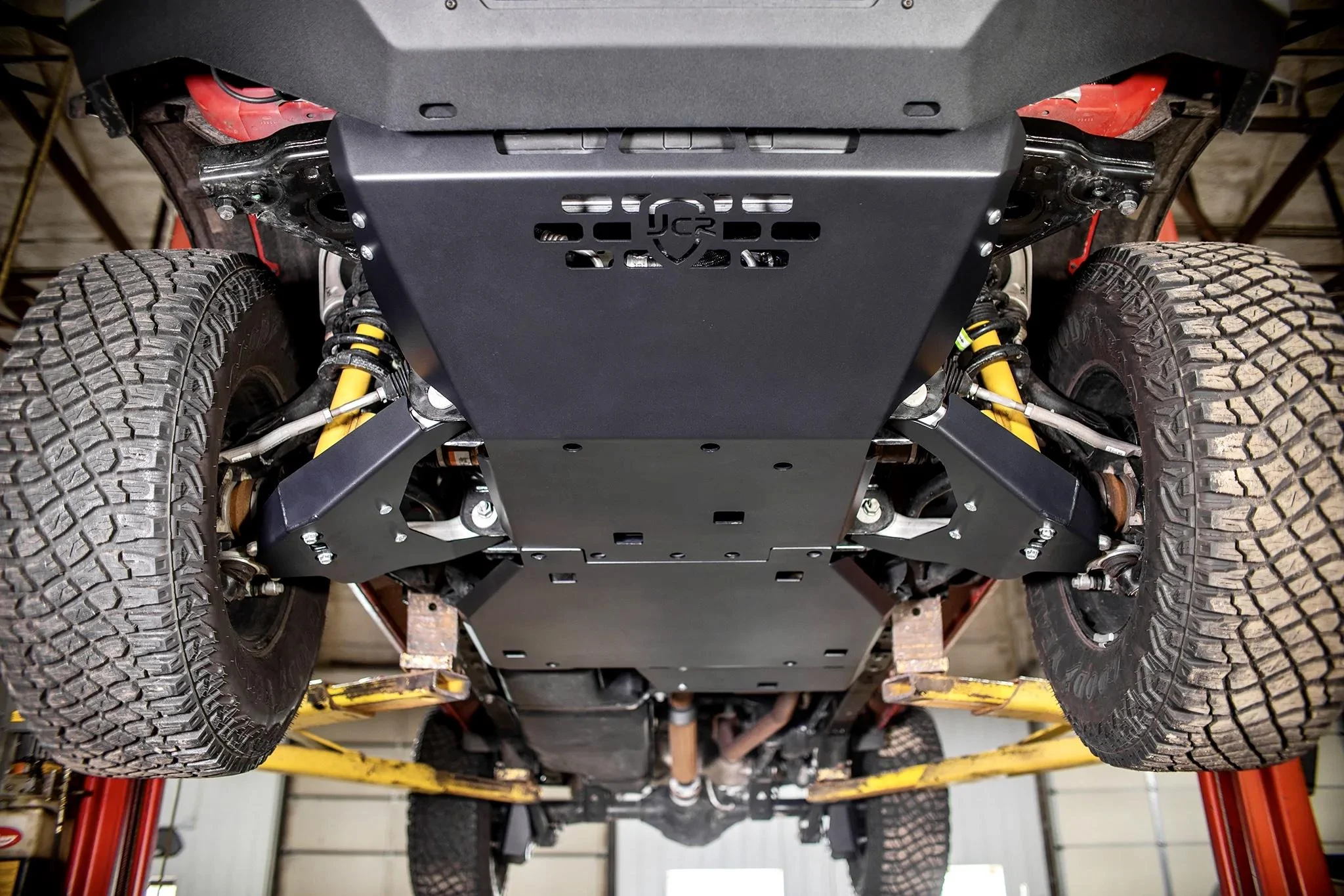

I don’t think there’s an oem transmission plate. Check 7m 51s into this LiteBrite video. Notice theres a small plate covering the sway bar that I don’t think you have, but it’s still not covering the transmission either. I think you need to go aftermarket. Asfir’s is less expensive than JCR, but also much smaller. Earlier in the video he talks about the low cross members. I could be wrong but I think JCR’s skids sit below the cross members and cover them, making it a smooth surface. If that’s right, it would also be a little lower but I suppose it would solve getting stuck on them. He also goes on to show how the oem transfer case skid bends up. Asfir sells a bracket to strengthen it, but shipping is expensive. Instead of buying oem transfer case skid plus the bracket, I think I might just get the Asfir plate instead.

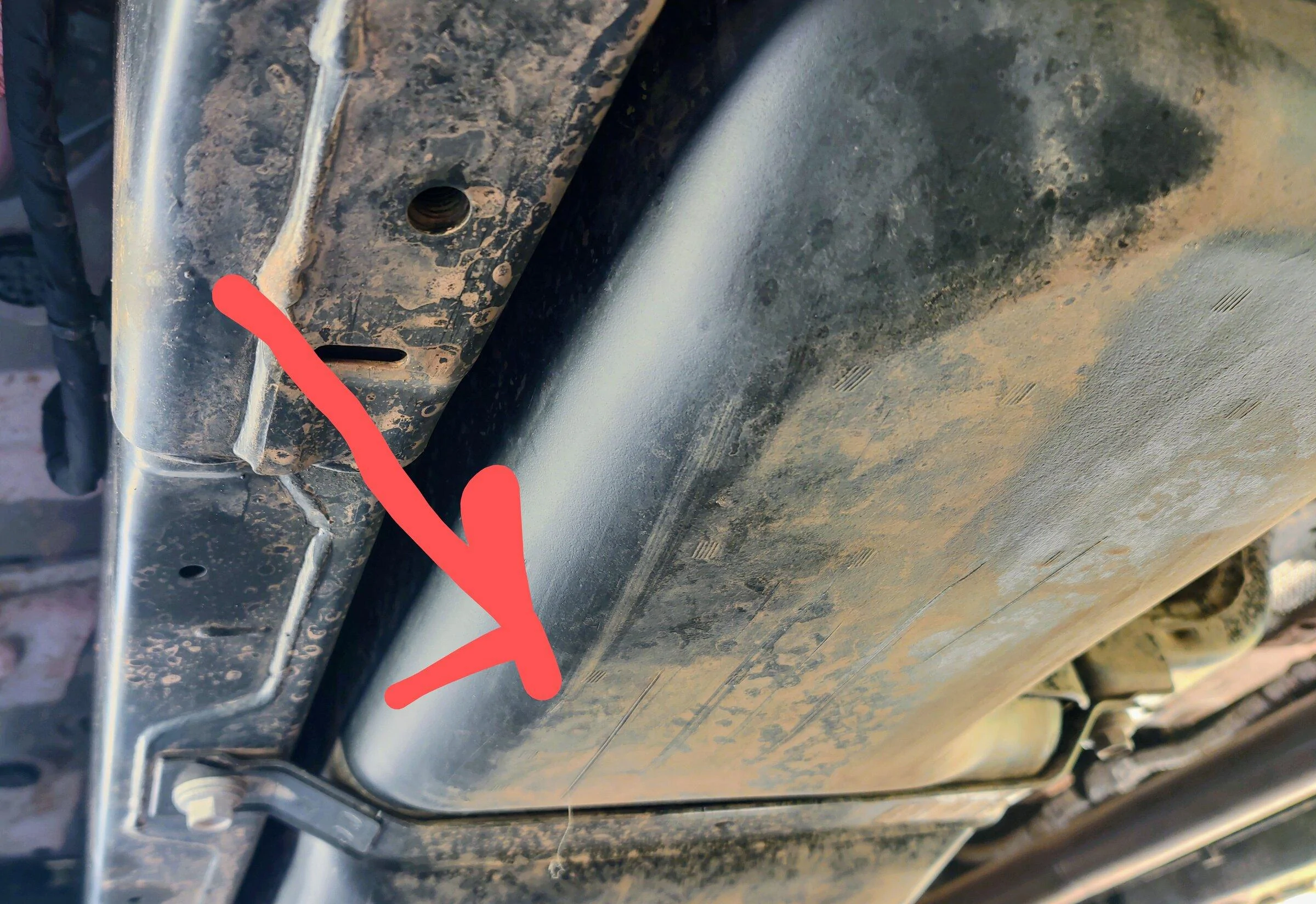

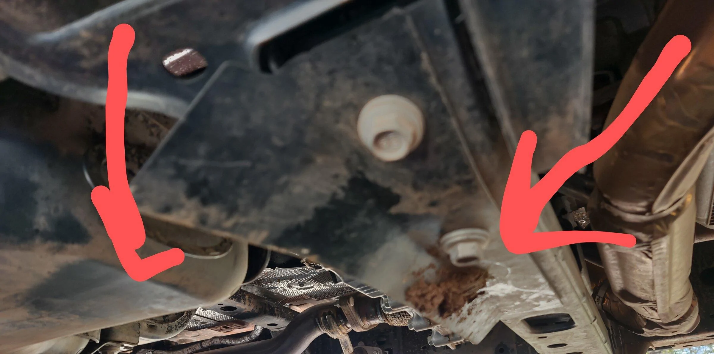

I took my base with 285/75r16 no lift off road. Was getting some scraping and I noticed that there is a little plow mounted on the frame in front of the gas tank, it still has mud stuck on it also noticed some scrapes on my gas tank, there is a strand of plastic dangling from the back of one of the scrapes. Definitely need a skid plate before going out again. Been shopping a few brands of Skid plates for the gas tank and am leaning towards Asfir at this point.
