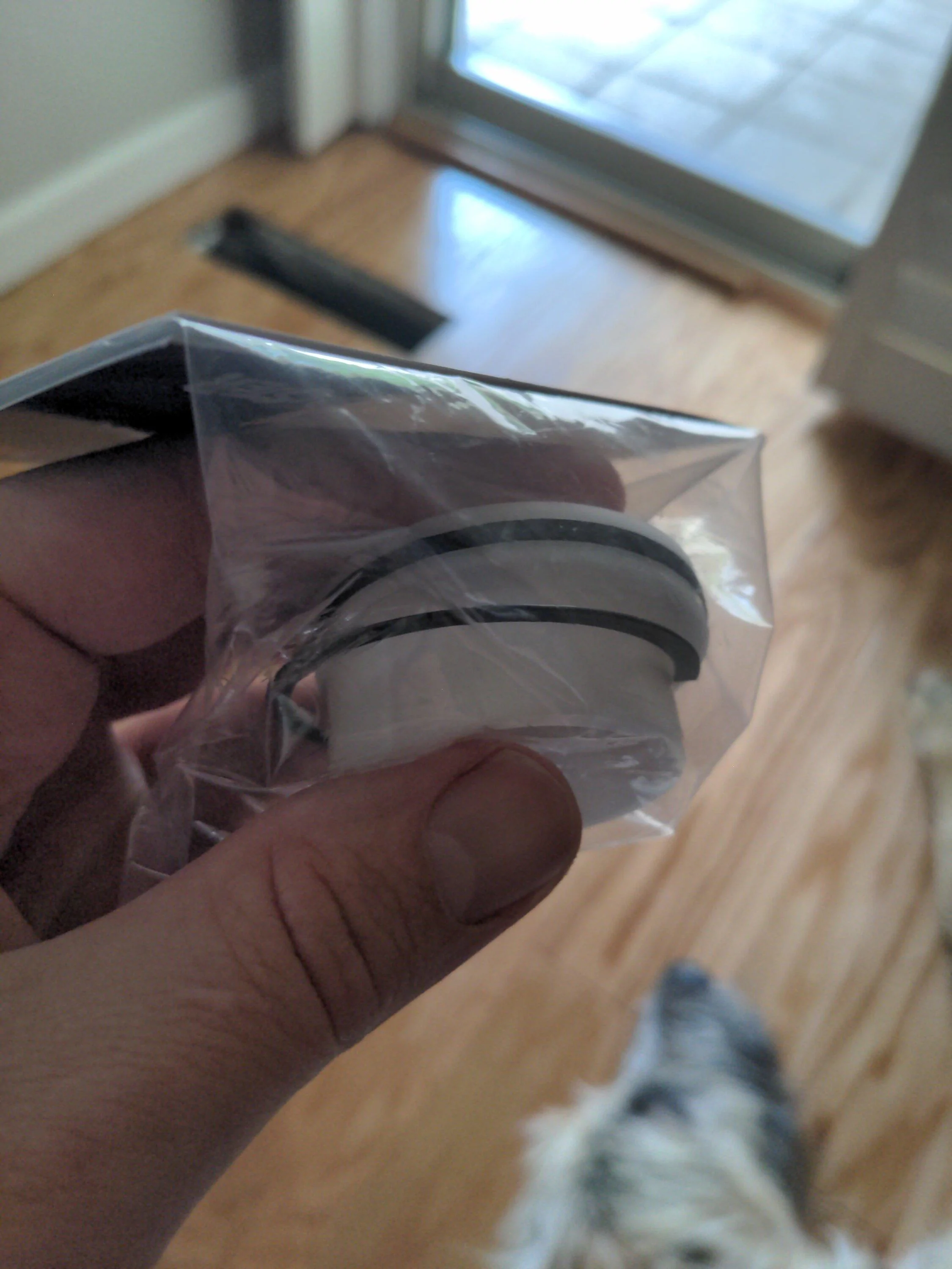

It's so cute! Can't wait to see what the factory bushing looks like.
Wow you finally did it. Mine has held up for the past 14 months
