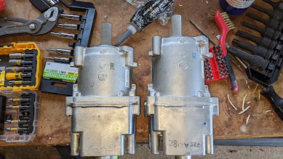

Started a thread asking the same question.
In the comparing the two photos below the top is my 3.0 and bottom one 4.0.
The only cast difference I could see is that the case ribbing going across is complete on the 4.0, see right below the two casting marks that are about an inch apart.

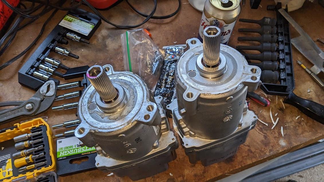

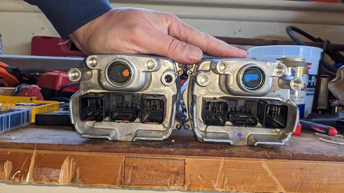

Time to pour some fuel on the fire!

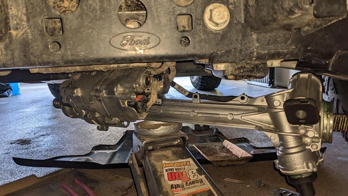

Presenting the one and only HOSS 2.5 Steering Rack brought to you by @NORCALGXP and Hamm's an America's Classic Premium Beer Born in the land of sky blue waters.

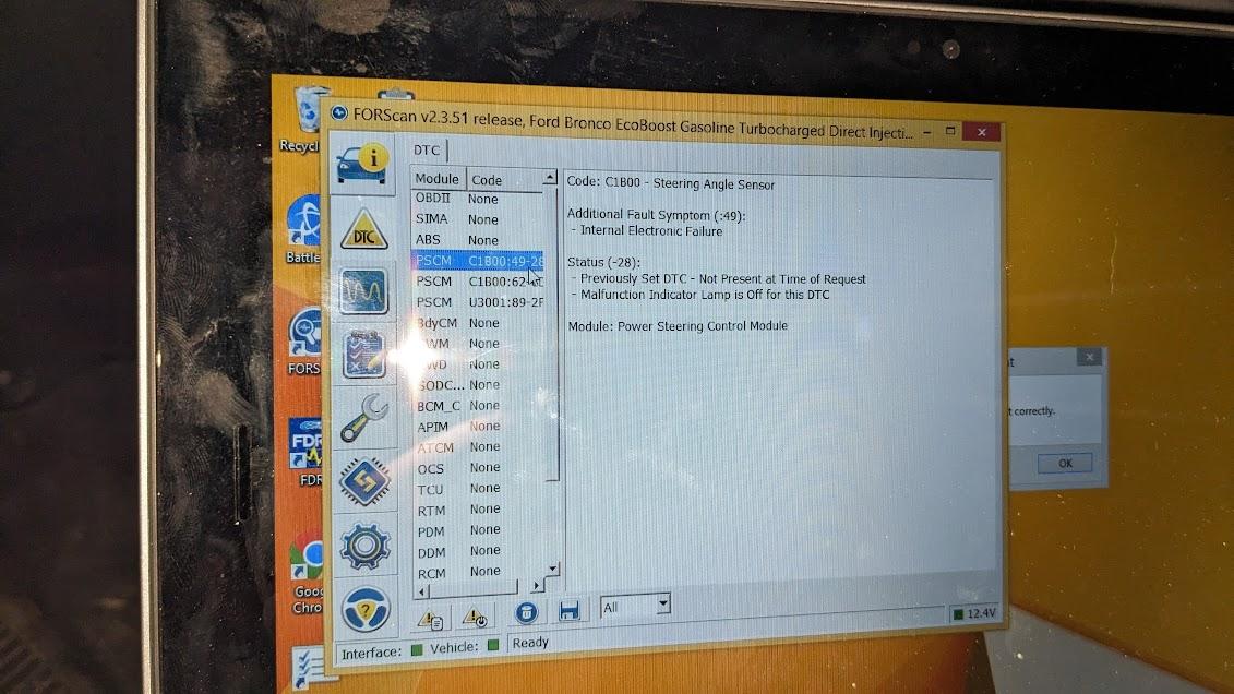

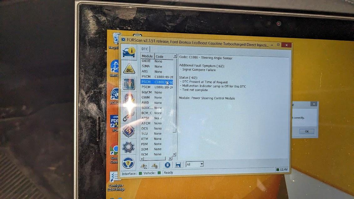

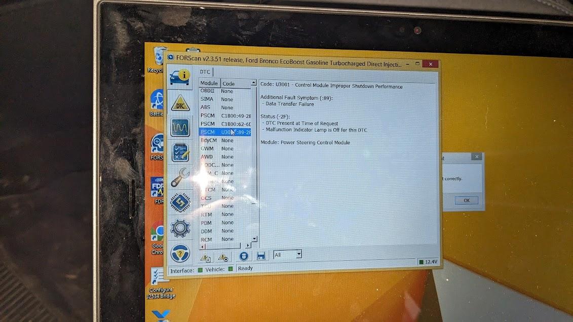

Hoss 1.0 Motor bolted to a HOSS 3.0 rack. Fault codes are below and looks like there is a steering position sensor inside the clock spring. I think this is a very important discovery as there are 2 separate clock springs for the bronco. I have a feeling this is related to why HOSS 3.0 the rack works in my bronco and not fancy those fancy broncos. FYI I Plugged the HOSS 2.5 rack into my bronco for testing.
Next phase will be a full install, since discovering the codes are related to the steering wheel clock spring. So at this point if you do a motor swap you may not need to program the rack. This is pretty big as it will allow more flexibility with a trail repair or make your own HOSS 2.5 rack.
