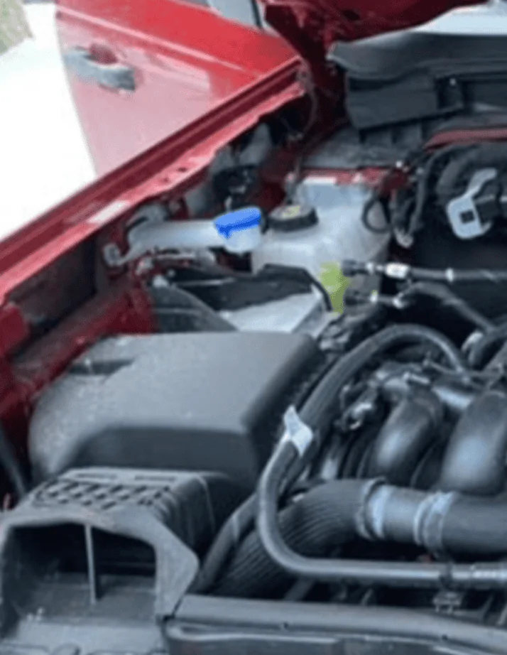

How do you install a snorkel on a Bronco?

Seems like you have to cut into the frame of the car? how does this work for jeeps and other cars?

On Nissans and Toyotas, you are cutting a hole in the sheet metal to move the intake from its original location to the fender.

Yup, have to cut a hole in the fender, not frame. Then there's usually an adapter of sorts to connect to the air intake box. Need to have the entire snorkel pipe water tight.

You cut a hole. That's why you need to be sure you really need one before you get one.

See that gaping thing at the front of the truck? That's the air inlet. Already higher than what most will ever need and it only sucks in cold air.
But if you really want a snorkel, then someone is going to have to make a kit to adapt to the factory air box, you'll run the pipe under the hood, drill a hole in the fender, and run the snorkel from there.
I'd surprised if Volant doesn't have a replacement airbox/adapter on the market before the end of this year. Luckily, it looks like it would be a pretty straight shot out ot the fender. Then maybe the location of the old inlet could be used for an ARB twin compressor.

Given how easy it is to remove fenders, I wonder if there will be slick snorkel+fender option available in the aftermarket. That way you don't have to drill your original panel.
I suppose you'd have to have it painted to not look weird, but the modularity of the panels does open some new ideas that aren't available for other vehicles.
