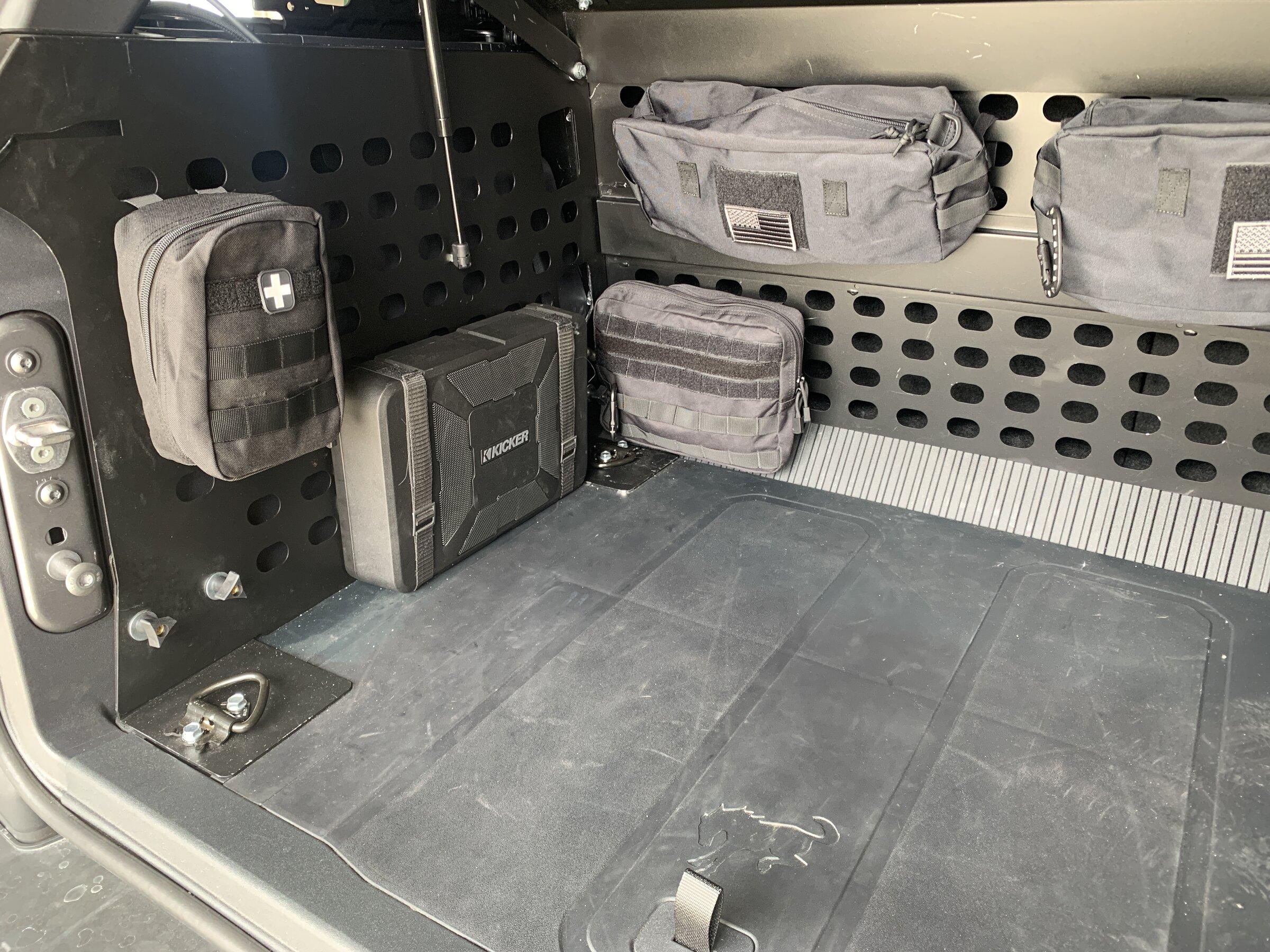

Kind of defeats the safety purpose of the enclosure though, yes? I have the enclosure and the HS8 and plan on mounting to the side or rear molle panel inside for added theft protection. 🤷🏻‍♂️
Is that the 8”? Enough bass? Also, did you upgrade anything else like 4” speakers or add amp for factory speakers? Not originally B&O, right?

Excellent. Would you be able to pull back a bit for another pic? Hard to see the perspective of the sub’s location. Thanks!
Has more bass than I will ever use. Yeah upgraded all speakers to Kicker. Not a B&O.

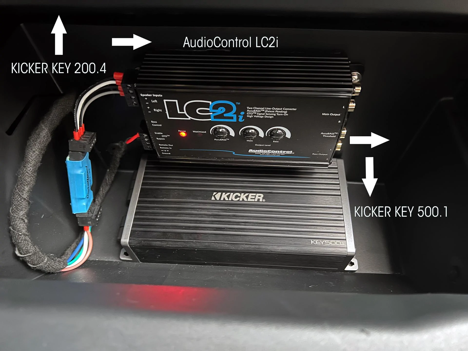

I posted this in another thread as well but, figured it really belongs in this one.
As I previously posted, I purchased "kit 14" and I'm super impressed with the plugnplay kit.
This kit comes with the harness, 200.4 and also an AudioControl LC2i. I installed the 200.4 in the same location as the OP and that worked out great.
Speaker upgrades:
(4) Kicker KS (with 300 hz bass blockers on the fronts)
(2) Sony XS-GS1621's in the kick panels
I decided to mount my LC2i in the glove box and just purchased the KICKER 500.1 which will live in the same place. I'll be finishing off my system next weekend with the amp install. It actually fits perfectly in the bottom of the glove box and it will be velcroed in place. I did drill a few holes in the back of the glove box (added some rubber grommets) for the wiring.
I like this because it keeps everything pretty much self contained to one area. Outside of running speaker wire to the rear (for the sub) all of the wire runs are nice and easy. I also like that I can lock the glove box for that little bit of extra perceived security.
I know it's not for everyone... but my glove box is generally just filled with junk and this is much better usage of the space (for me).
Ford Bronco Kicker Key Amp 200.4 Install DIY Video - Do this first! AMP-SETUP

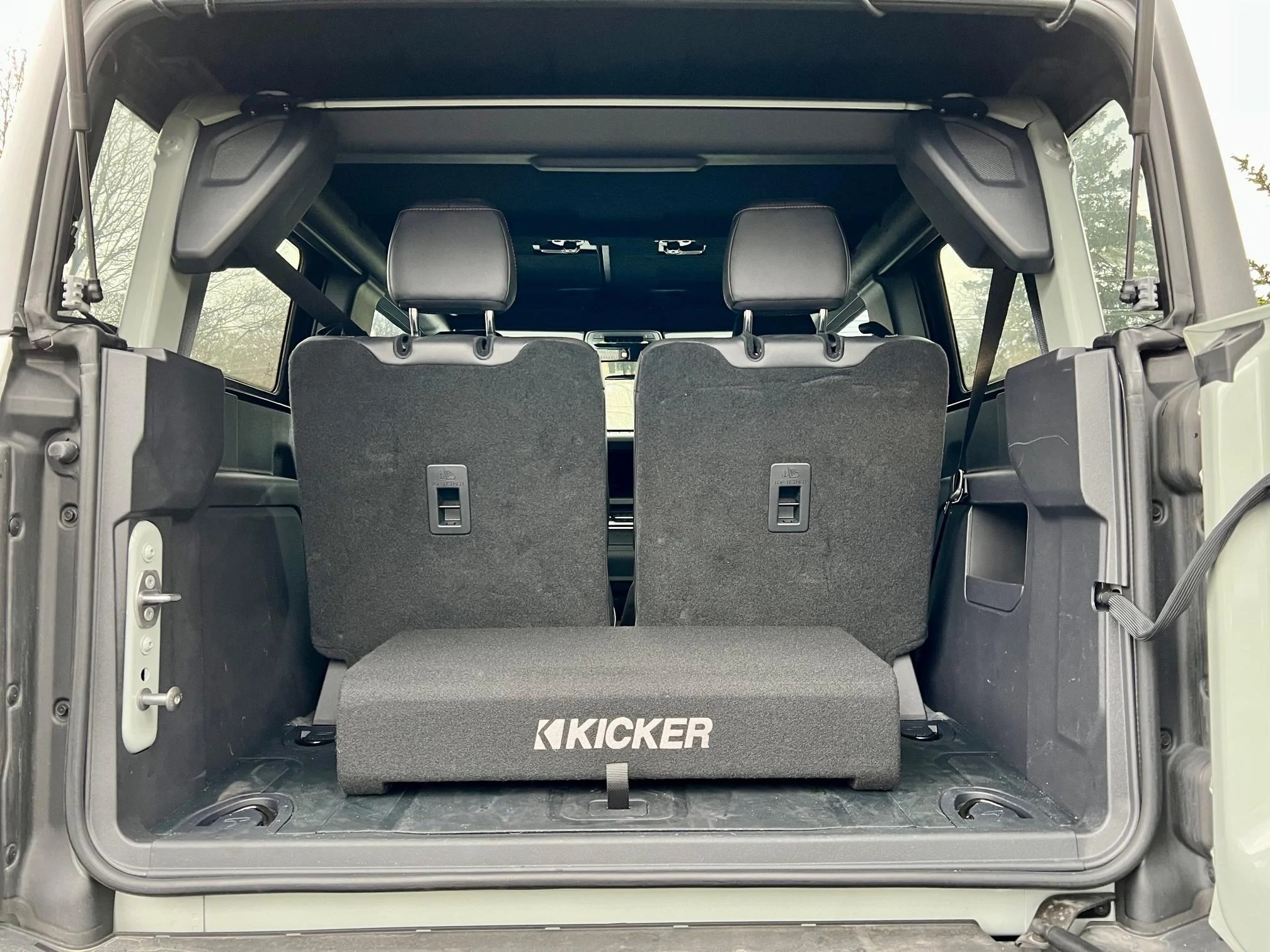

As for the sub, I ended up going with the KICKER 48TRTP122 for the rear of my 2dr. While it does take up a lot of floor space, it doesn't really take up a ton of cubic space. I like this box because you can stack items on top of it, if necessary.
Ford Bronco Kicker Key Amp 200.4 Install DIY Video - Do this first! IMG_1400

Didn't think you'd really need the LC2i since the Key 500.1 has DSP built in. No?
