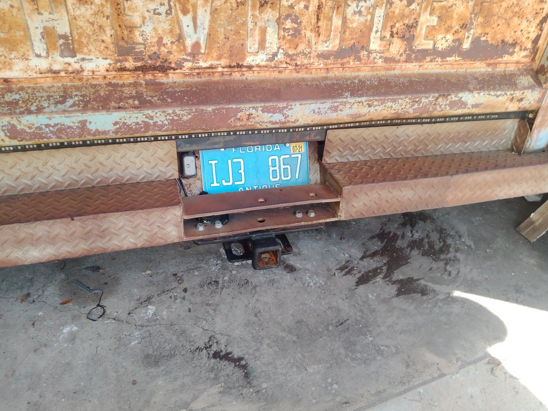

That looks like a class 3 hitch???
Agreed, looks like 2" receiver, so it would be a class 3 at minimum, and 3500-6000 pound range (for class 3). So if Ford is limiting it to 3500#, it must be because of suspension?

With the suspension trickery this thing has, the drive line, gear ratios... there's absolutely no reason you can't pull 5k with it. Even if they leave the rating at 3500lbs. My only concern would be the hitch itself. But, two 1/4" thick plates, welded to the hitch, that followed the crossmember, and bolted between the tow hooks and frame, would fix that concern.
Or of course, an aftermarket bumper with integrated 2 inch receiver could be made stout enough to pull 6k relatively easy.
