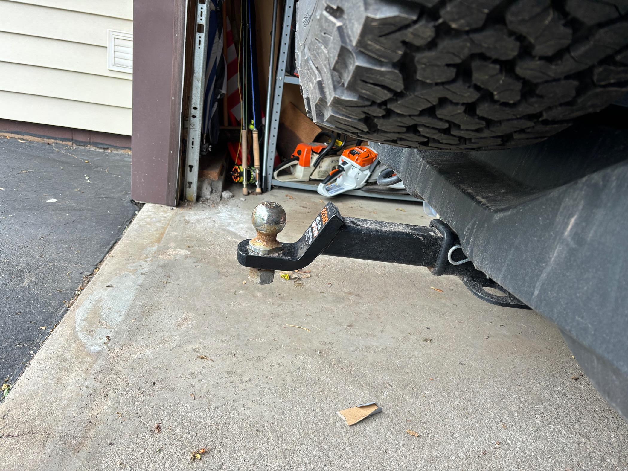

My money's on the tight clearance between the spare and ball if the receiver doesn't have enough drop, which requires him to remove the spare. Same issue I had.....until I bought a receiver with more drop.

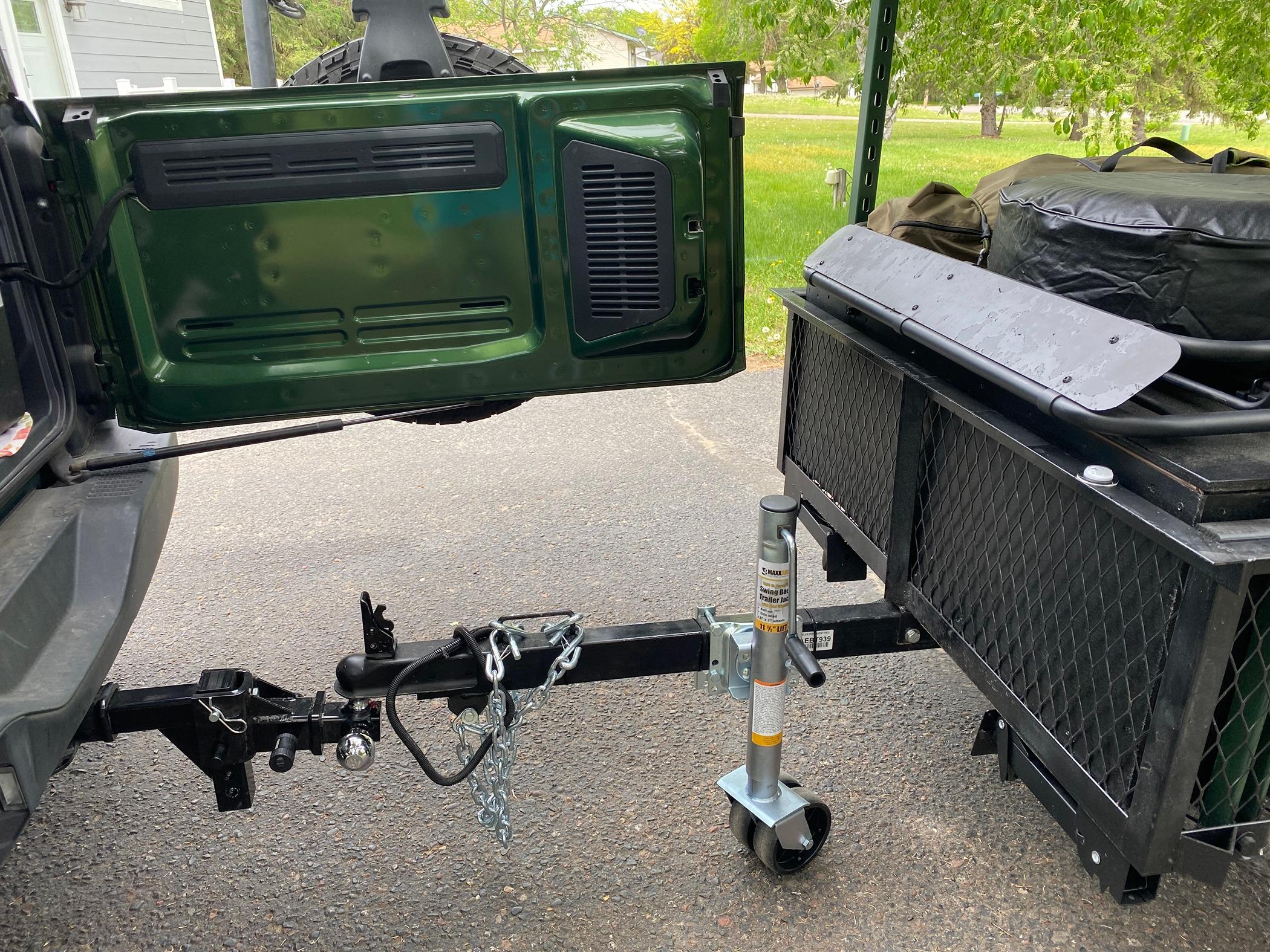

I’ve towed thousands of miles in my Bronco with no extension or problem with the spare tire. I’d guess trailer choice matters.

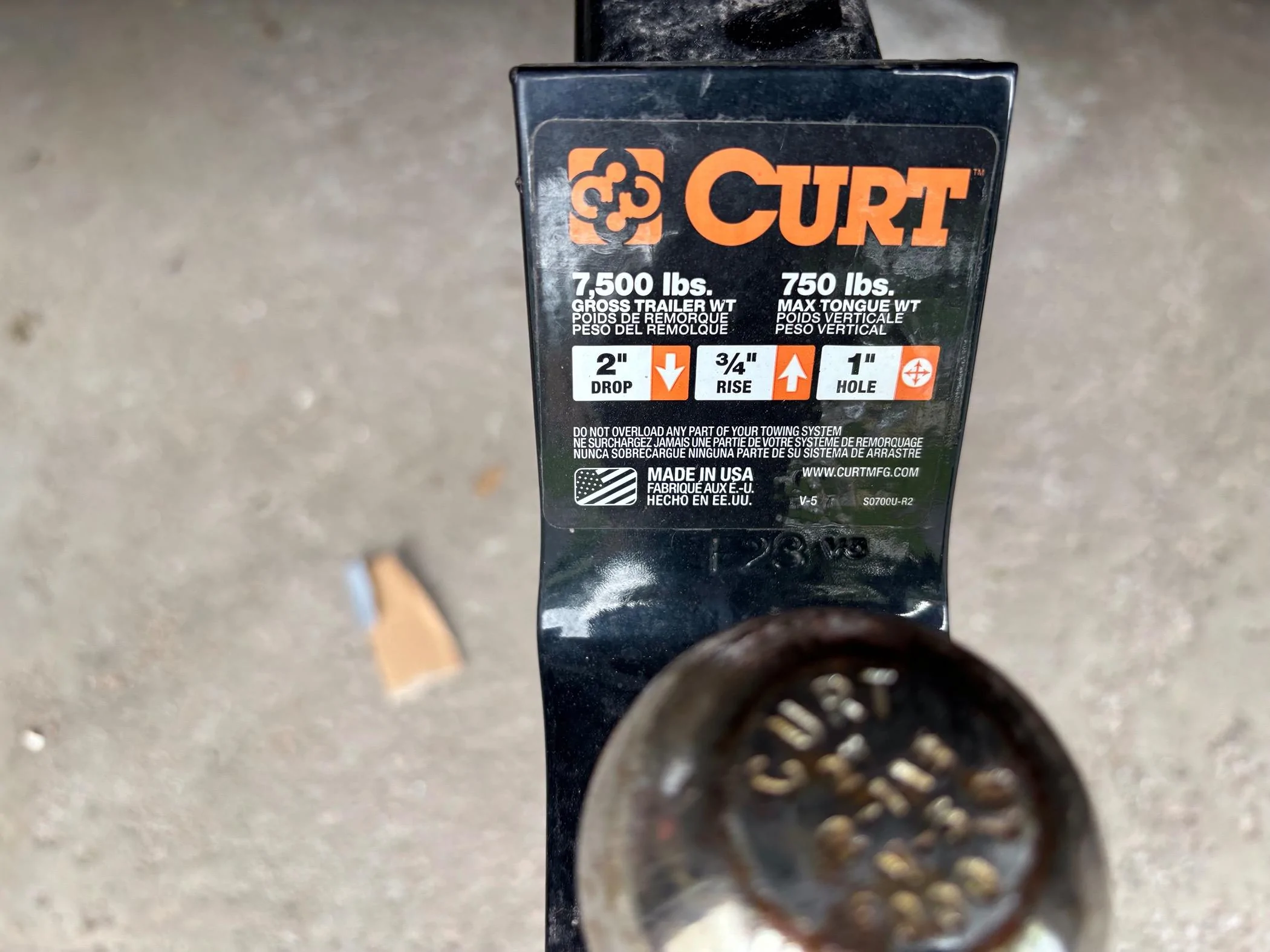

With a 2" drop draw bar, I have to open the door to hook up and latch the lever on my trailers. With a 4" drop draw bar it works fine without opening the door. These aren't the best tow vehicles, but work great for small single axle trailers with minimal tongue weight.
