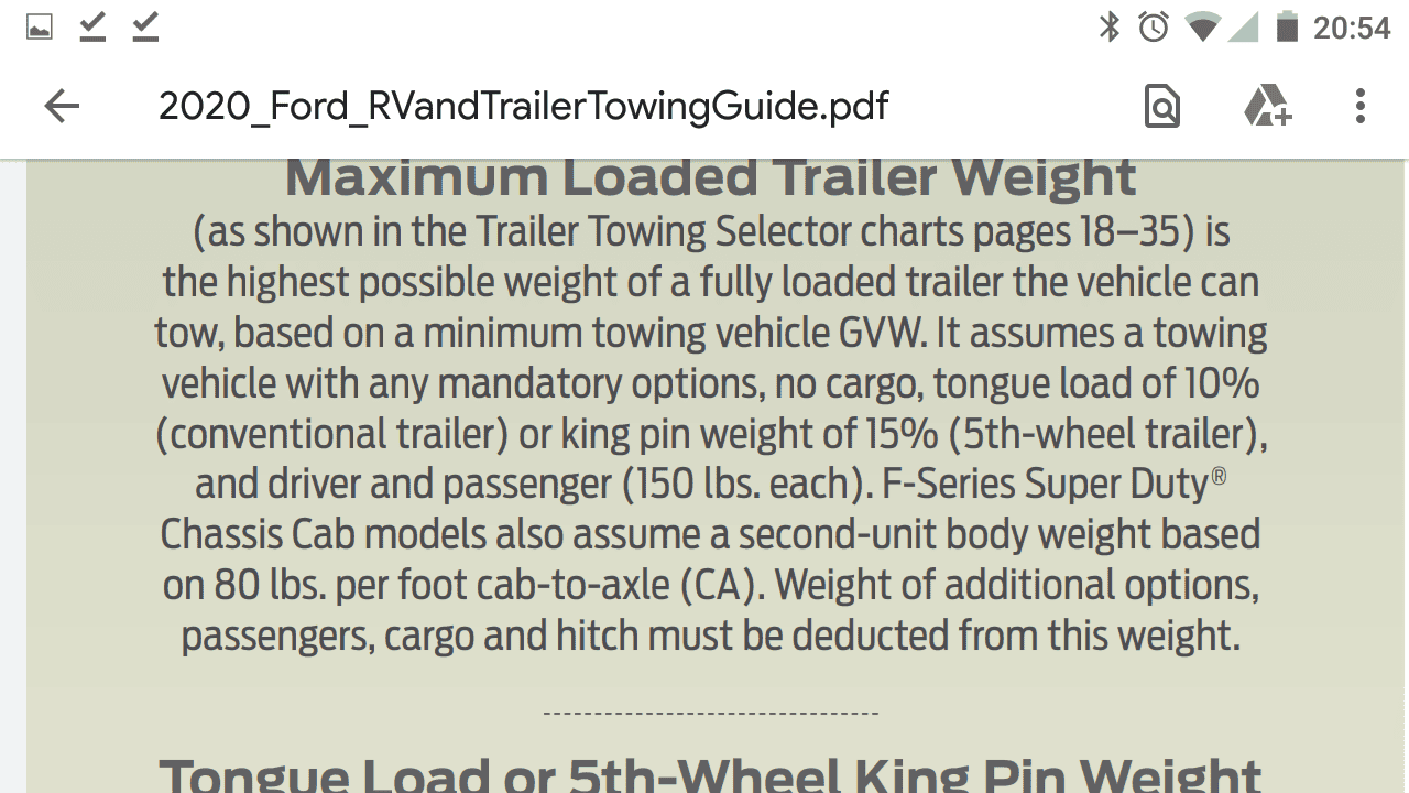

Say what? Why would payload be deducted out of the max towing capacity? The way you're describing it, it has a max towing of 3500lbs but then for example subtract 2 adults (300lbs) + 2 kids (120lbs) + fuel (126lbs if 18gal) + gear (150lbs) = 2,804 max tow capacity.
Shouldn't it be:
GCWR less GVWR = towing capacity? or GCWR less (curb weight + weight of passengers, fuel, and cargo) = towing capacity?
For payload:
GVWR less curb weight = max payload (people, fuel, gear, additional options/equipment add-ons that are supported by the vehicle's suspension & trailer tongue weight)?
This sounds complicated. What are the chances Ford puts out some guidance with recommended trailers/campers with remaining payload weight of towing capacity with each trailer/camper they recommend?
They have a general towing guide for all of their vehicles. It is the small print in this guide that clarifies the concern above. And for people who would be towing a trailer with their family in the Bronco it is definitely a concern.

10% tongue weight is a very liberal calculation. The more commonly & conservative recognized tongue weight estimate is 12-15% of the trailer weight.
I suppose if you only have a driver (no passenger) who is not corpulent then 2-5% of a 3500lb trailer is probably taken up by the passenger allowance, but in any other situation that reduces that ACTUALLY available TC of this vehicle even more.
So for those whose trailer alone is pushing the boundaries of whether 3500lbs is enough or not the answer is likely no.

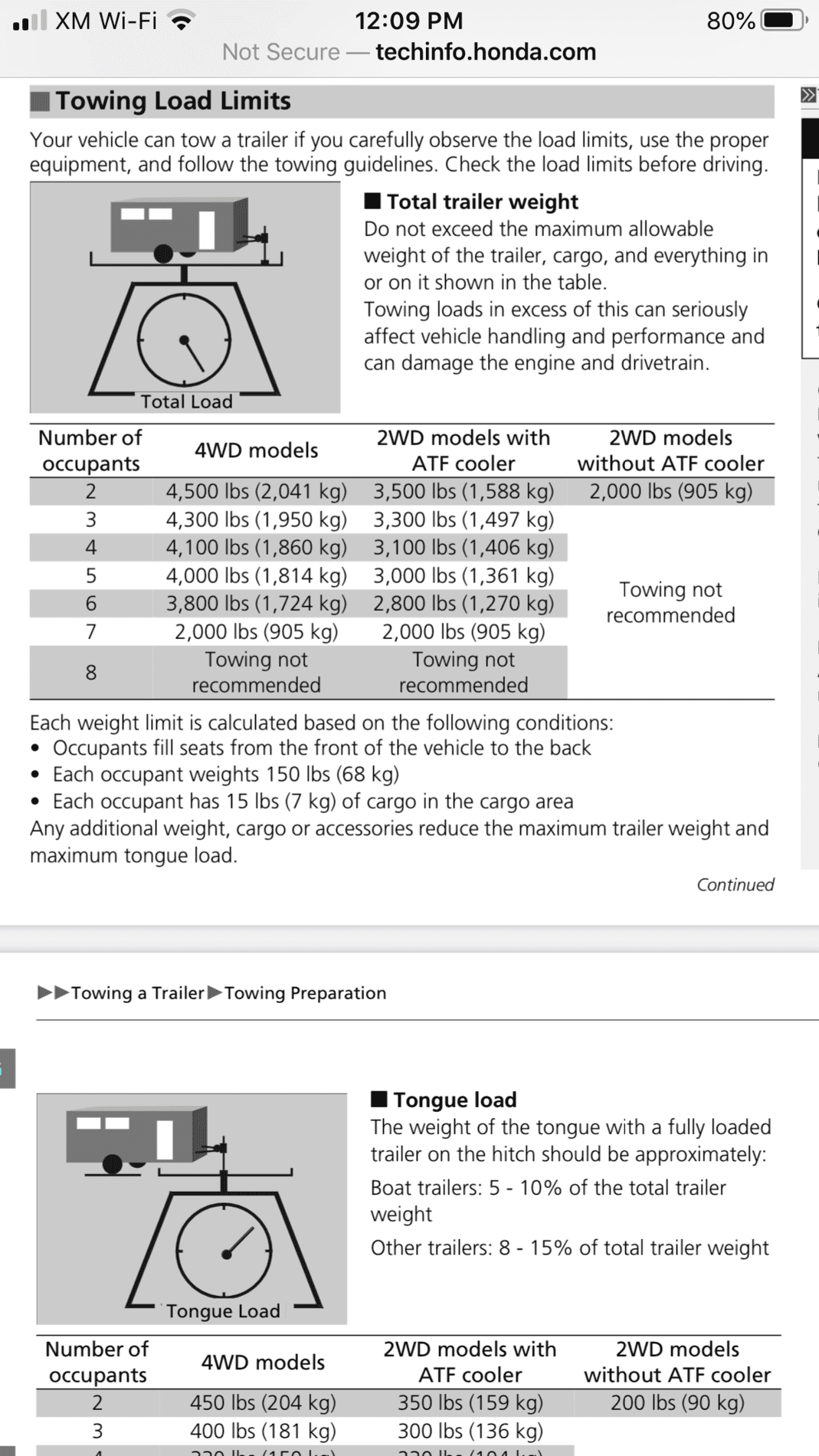

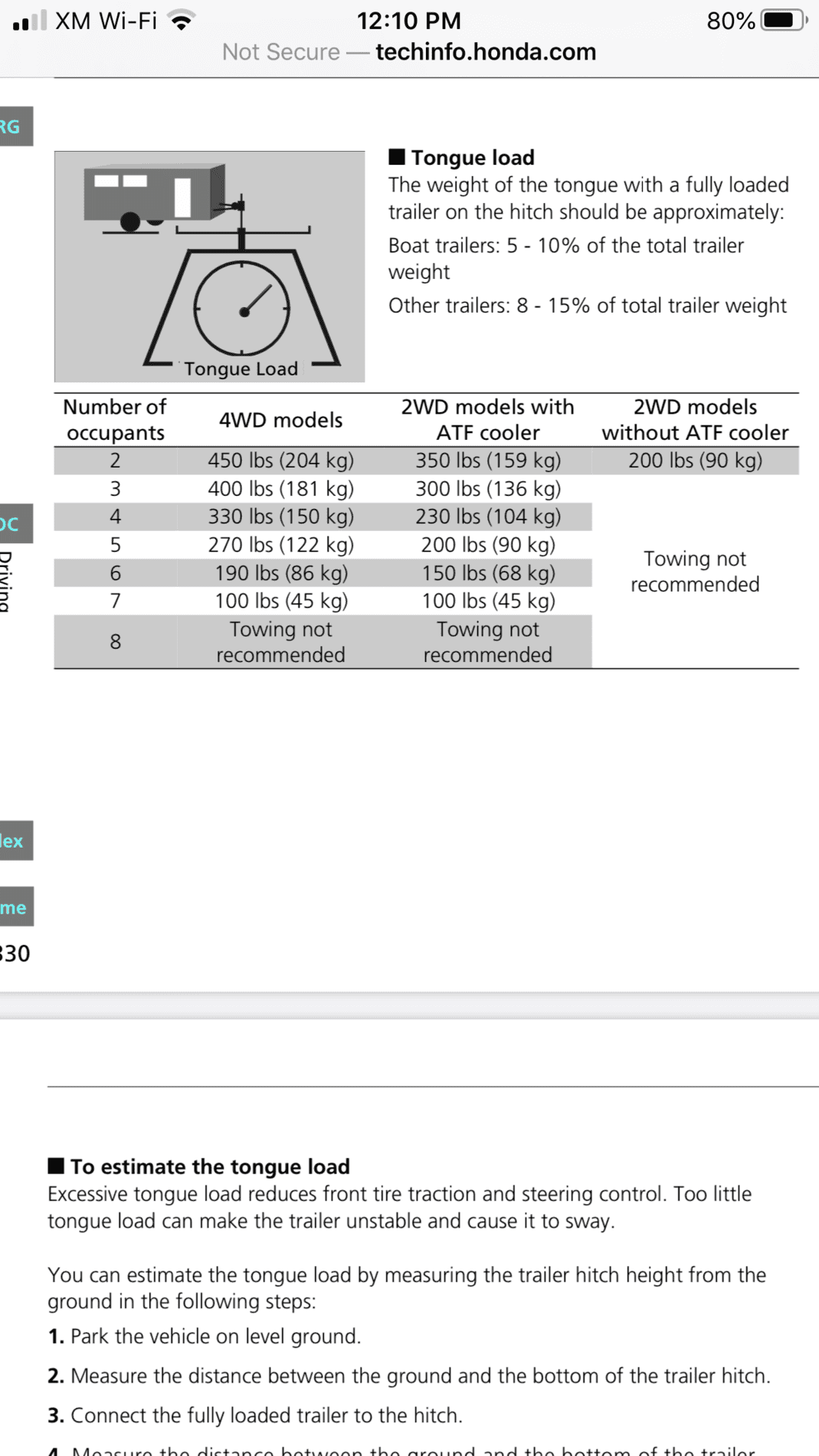

The number/weight of passengers inside the vehicle carries no bearing of trailer hitch weight, but it affects the maximum towing capacity. It’s about the weight balance distribution of the trailer itself. An unbalanced trailer weight distribution Makes for dangerous towing, much like weight and balance issues in an airplane affect its quality of flight. The chart from Honda on my 4WD Pilot is one of the better descriptions of trailer towing in an owners manual
What I meant was the TC assumes 300lbs worth of people and 10% hitch weight, so even if hitch weight is actually 12-15% on a max 3500lb trailer then if you have only one person in the vehicle it should be pretty much the same overall load. These are pretty generic assumptions made to go along with what in this case is most definitely a very generic tow capacity.
Yeah that Pilot towing guide is very good! More vehicles need owner's manuals like that. Most people are completely unaware that load in the tow vehicle affects your available tow capacity. I wonder if this information posted at the head of the wanted/needed tow rating poll would have affected some people's choices.
