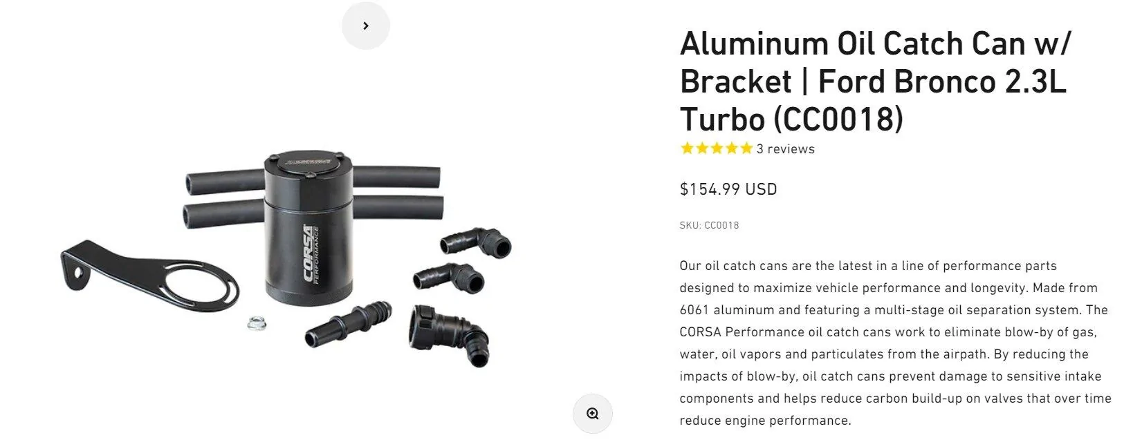

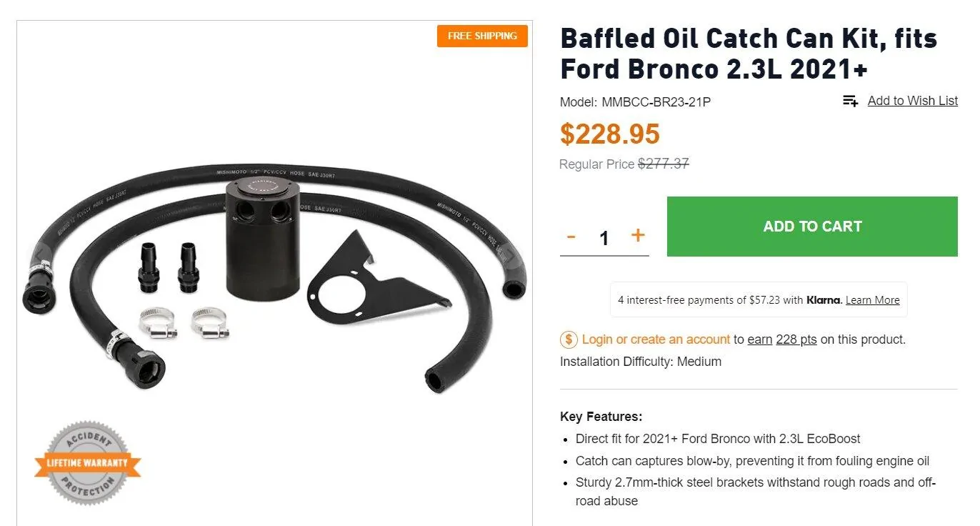

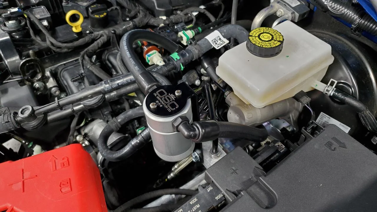

It certainly won't hurt having one installed! I installed one on my 2.3 as soon as I got it and change my oil every 3k miles. I have a little over 16k miles on it now and it's collected about an ounce of oil, 1 ounce that isn't turning to charcoal on the backside of the valves!
Im reading people arent really "catching " anything tbh
https://www.bronco6g.com/forum/threads/2-3l-catch-can-results.61209/
Whats the best one to get?
theres the OSC
https://www.mishimoto.com/ford-bron...pj6Y2tmut8DpPcB3MAL5Y3FJBUjb3t3hoCFgAQAvD_BwE
CORSA
https://www.corsaperformance.com/pr...h-can-w-bracket-cc0018-ford-bronco-2-3l-turbo
There are several on the market but I went with the one from Mishimoto. Some people don't like that it's mounted behind the engine on the firewall, but with all the congestion in the engine compartment the last thing I wanted was it up front! It's not that big of a deal to reach over the engine to get to it. You want the catch can on the same line as the air/oil separator, it will catch oil. The one that Ford performance sells is on a different line. I get confused on all this crap these new engines have but if you do some research on this forum you will figure it out. You can also get ahold of Mishimoto, they will set you straight. A lot of people here will tell you they don't work because Ford has the air/oil separator already, all's I can say is mine catches crap I don't want going into the intake!
