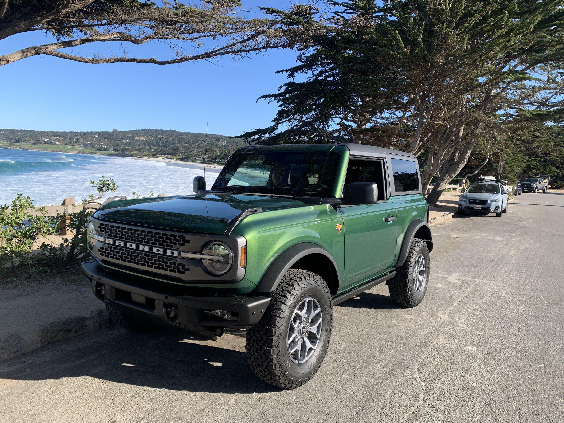

Ford Bronco 2.3L turbo boost issues 1646500654256
Same exact issue I had, and coincidentally actually i have the same exact Bronco! 2.3L Manual EG 2-door Badlands non-sasquatch, standard wheels.
Happened to me at 50 miles, dealer replaced the entire turbo. Mine seems okay now.
