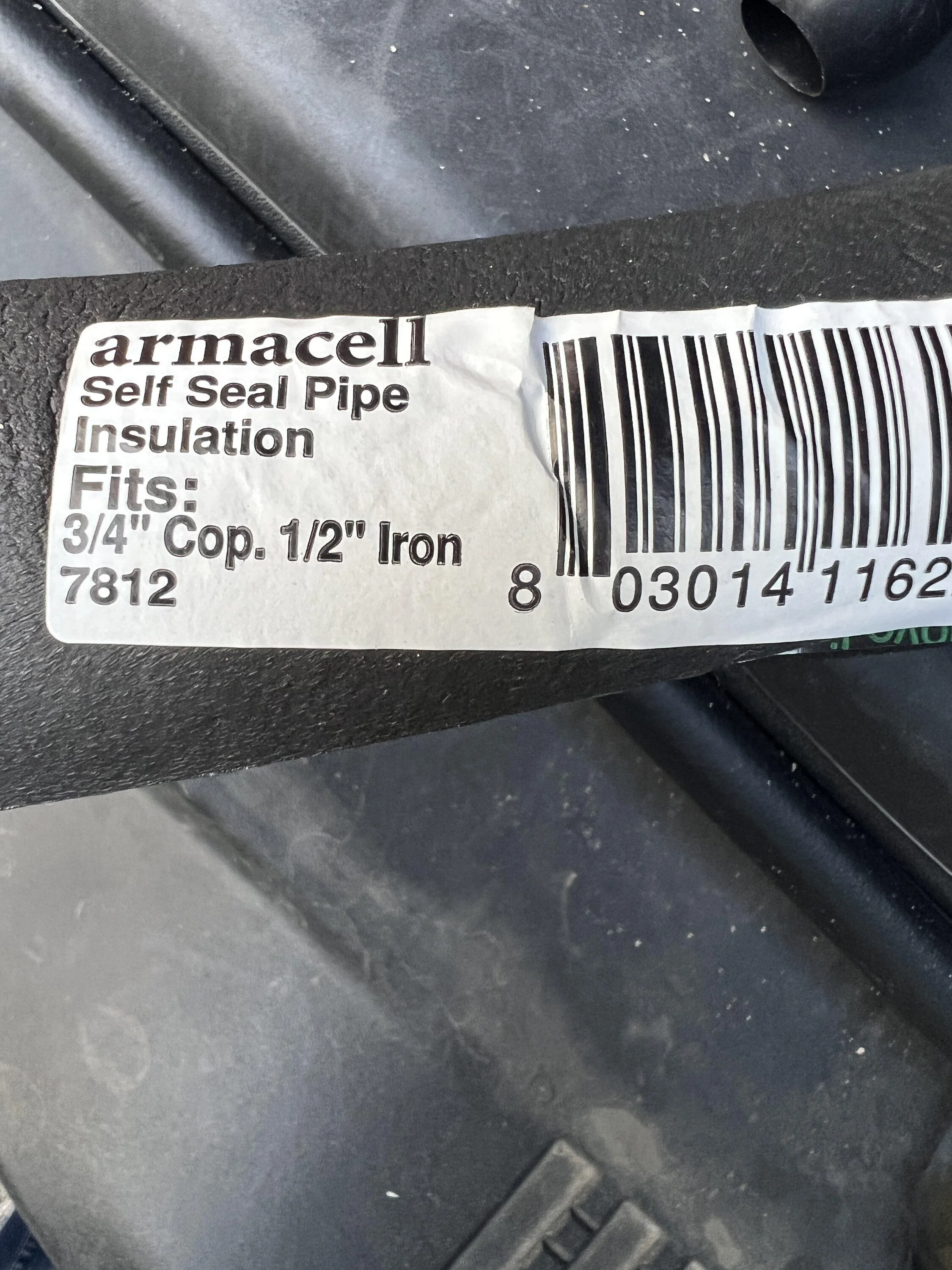

Can you share from the home depot site exactly what you purchased? I have the same Bronco as you and plan to go to home depot this evening.
Tarheel_Wes
Wesley
Feb 10, 2021
1,245
2,249
FJ
It’s this one
