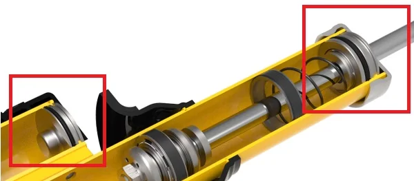

From what I've seen on cut-aways of the OEM Bilstein units, they do not look serviceable.
The end gland and reservoir end both look to be swaged on.
Also, no Fill/Schrader port on the Reservoir end.
That wouldn't stop people in the Know from opening them and converting them to serviceable though. We used to weld shader bungs onto 5100s as to open/re-valve/re-pressurize them.
Technically there isn’t a shrader on the Fox shocks for the Raptor, but it’s an easy add-on. The swaged on ends would definitely pose as a bigger hurdle to overcome, though.
Yes. The Fox Raptor shock have a needle fill port or pellet. Can be charged/discharged with a special tool. Looking closely at the the picture above and there is no port leading though the cap to the inside. That means they are most likely filled and assembled inside a chamber at 100-200 psi. Usually automated assembly as well. 5100s are built this way.
Drill your own hole and hope for the best?
disclaimer: don’t do this.
