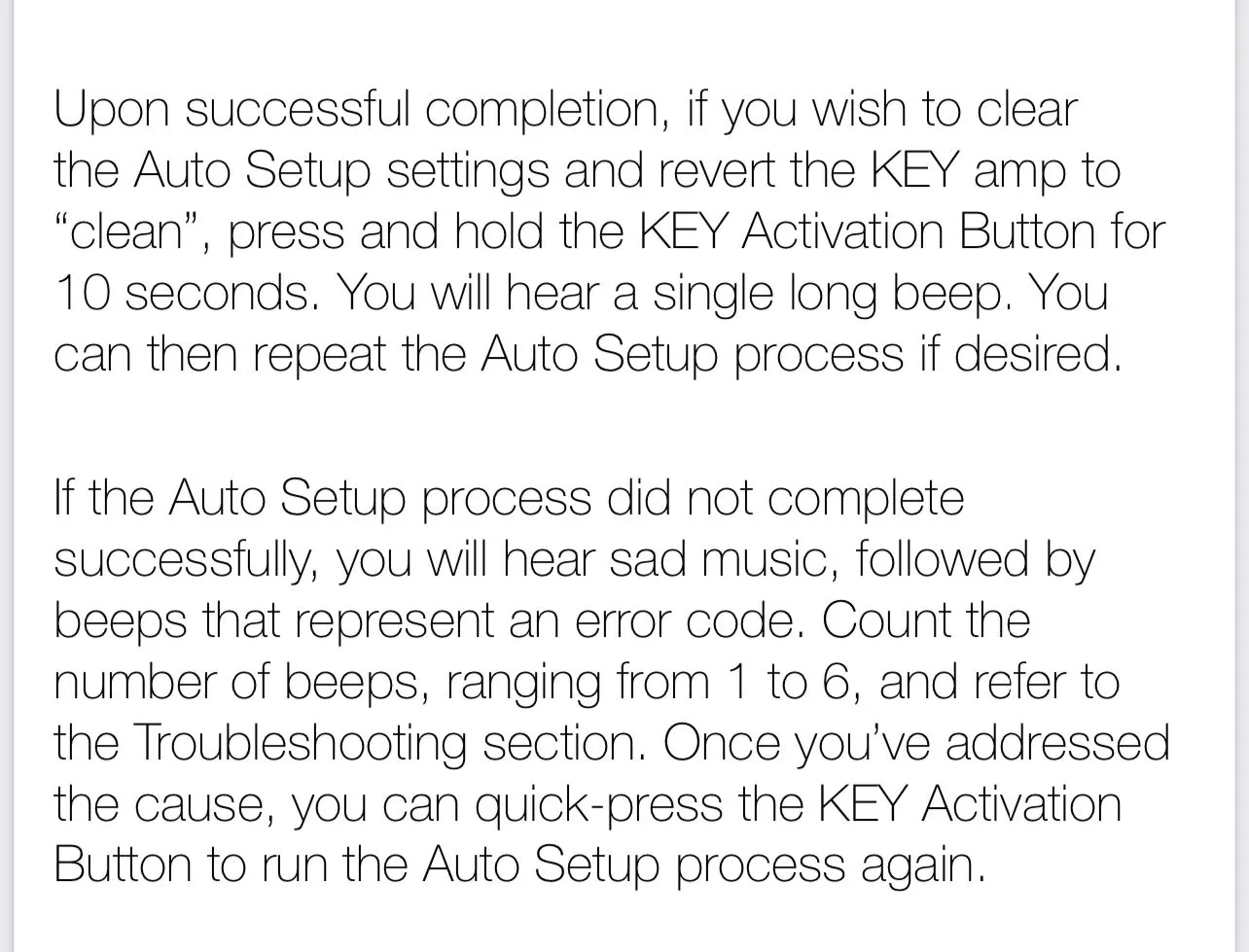

Are you powering all 6 speakers with the Kicker KEY? If so I don't think the DSP will work correctly. In order for the DSP to work correctly, you would need to bi-amp the fronts. If you are running all 6 speakers with 4 channels, there will be a compromise. The DSP works by automatically adjusting the crossover and time delay to each speaker. When the front stage is wired in parallel, the amp is trying to adjust time delay and the crossover points to 2 different speakers on a single channel at the same time. Someone correct me if I am wrong, but I don't think this is possible which is why it sounded better with it turned off.
How do you turn off DSP on the kicker 200.4?
