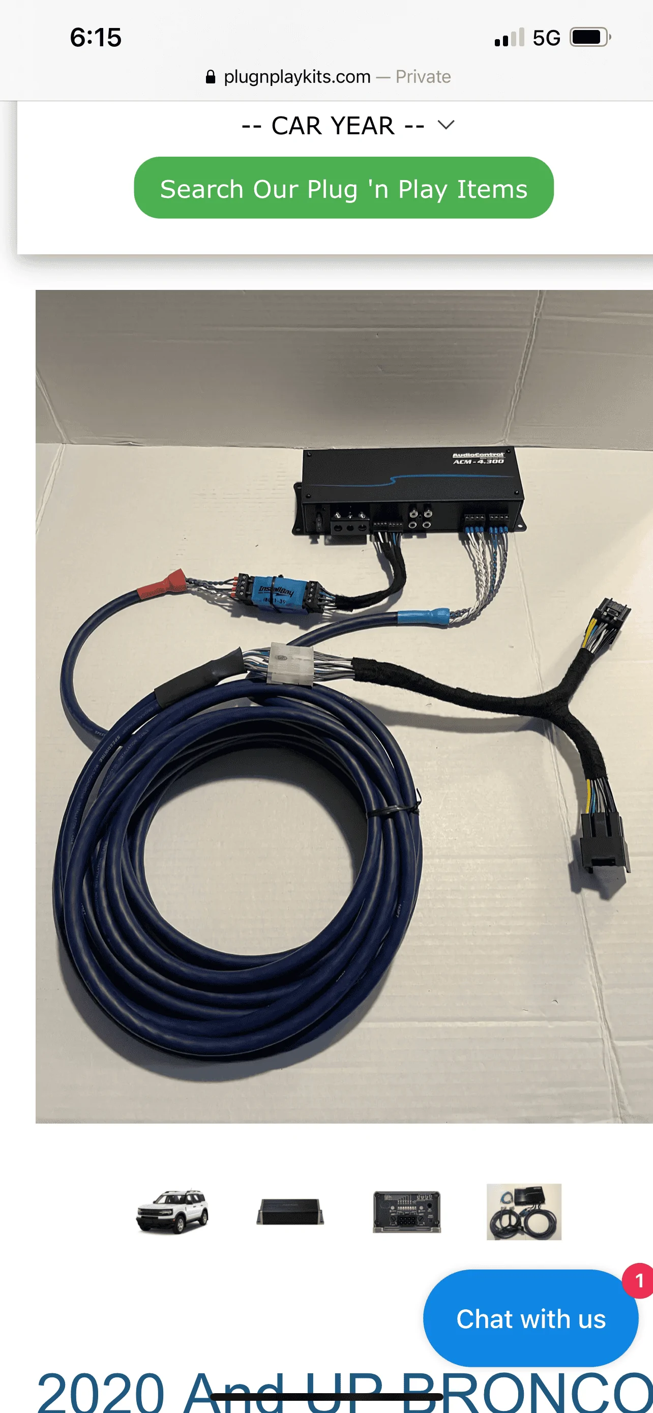

Just placed my order. These guys were awesome to deal with. I chose the following:
  • Kit 11-4 (harness plus 17 ft sub amp cable)
  • Kicker Key 200.4 (PNPK was out of stock so I found and ordered one on Best Buy's website for $269)
  • AudioControl ACM 1.300 mono amp
  • AudioControl dash remote
  • Kicker KS 4" speakers for the dash (going to wait on kick panel speakers based on everyone's comments that the stock speakers work well with amp install)
  • Kicker 10" down firing sub (in my 2D, the rear seats stick up ~5" off the floor when folded down. The sub is 5 5/8" tall, so if anything it should give me a flatter surface across the whole rear)
I bought my Bronco used and the original owner installed the JBL sound bar. I'm going to wait to see how the system sounds before deciding what to do with it. Supposedly it's rated for 100W/channel so we'll see if there's decent improvement.
