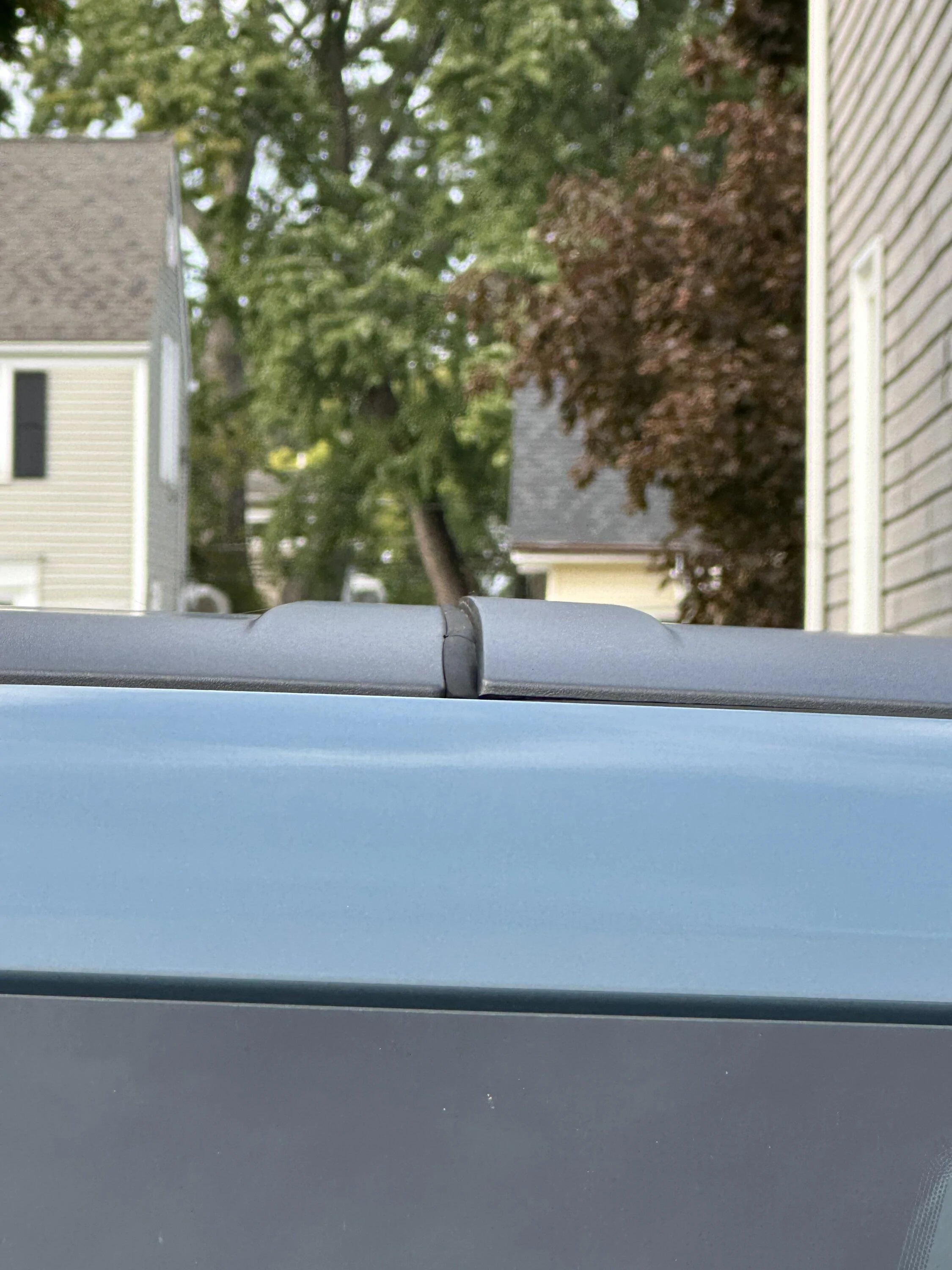

Will report back tomorrow but tonight I did the front panels. Reinstalling them made me realize how the piece of Number 1 along the driver side raises bumps caused my panels to sit uneven. No word yet on how this will impact road noise and possible water intrusion. I might change the location of that insulation strip so it’s sitting on the side of the panel indent instead of on the two humps as shown. Stay tuned….
this doesn’t look correct. There shouldn’t be any raising of the panels. Make sure it’s only on the indented parts of the roof and not the raised sections.

im not sure what you mean by indented vs raised but I followed what you had shown in the picture. I applied it to the two bumps and not the flat part of the roof like the passenger side

Basically, you're looking for it to form a seal between the panels- shouldn't really get stuck on top of the other panel. It's not actually applied on the two bumps- it's on the perpendicular surface that comes vertical from the bumps.
