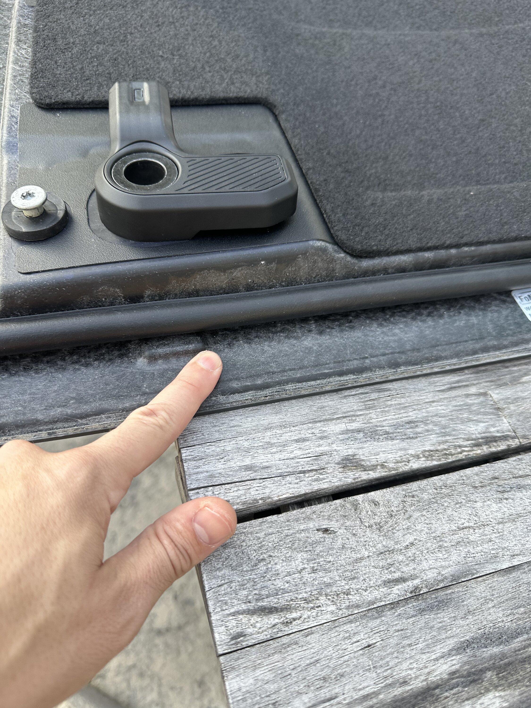

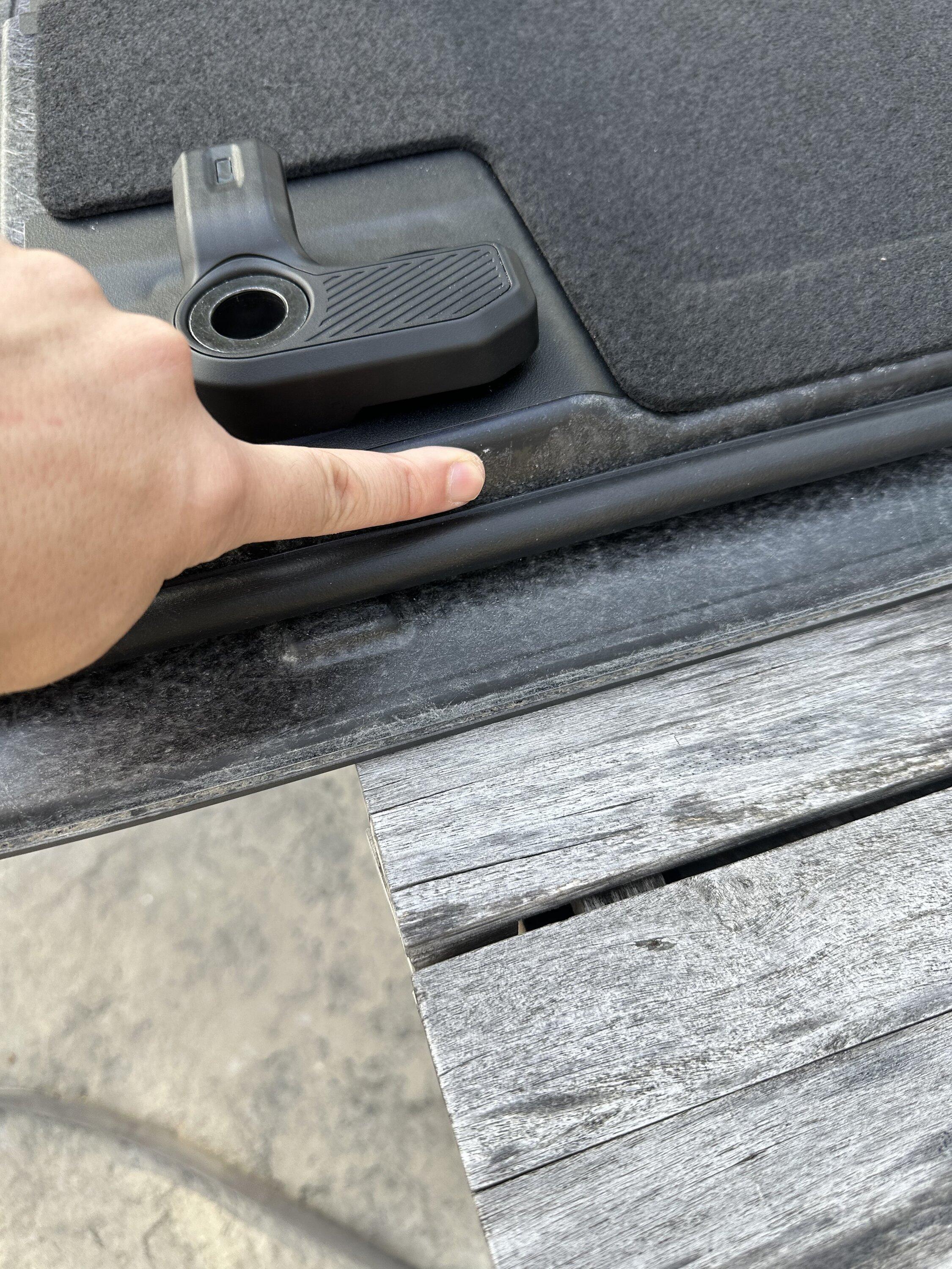

Basically, you're looking for it to form a seal between the panels- shouldn't really get stuck on top of the other panel. It's not actually applied on the two bumps- it's on the perpendicular surface that comes vertical from the bumps.
got it, that’s what I figured what you meant after I reread your post. Appreciate your response!
original placement
Ford Bronco MIC Noise Reduction Guide - wind sound- aka more (or less) cowbell please F44A32DD-9E99-4B11-9A35-DF0FE54A1B66
new placement
Ford Bronco MIC Noise Reduction Guide - wind sound- aka more (or less) cowbell please 9D555AB1-1565-4169-965B-F4EEB138437E
original placement
new placement
Hope that helps! You can also experiment with the other seal if it’s better. I was thinking of trying one of the softer seals to see if it fit less snug.
original placement
new placement
This looks like the same placement to me? What am I missing here.

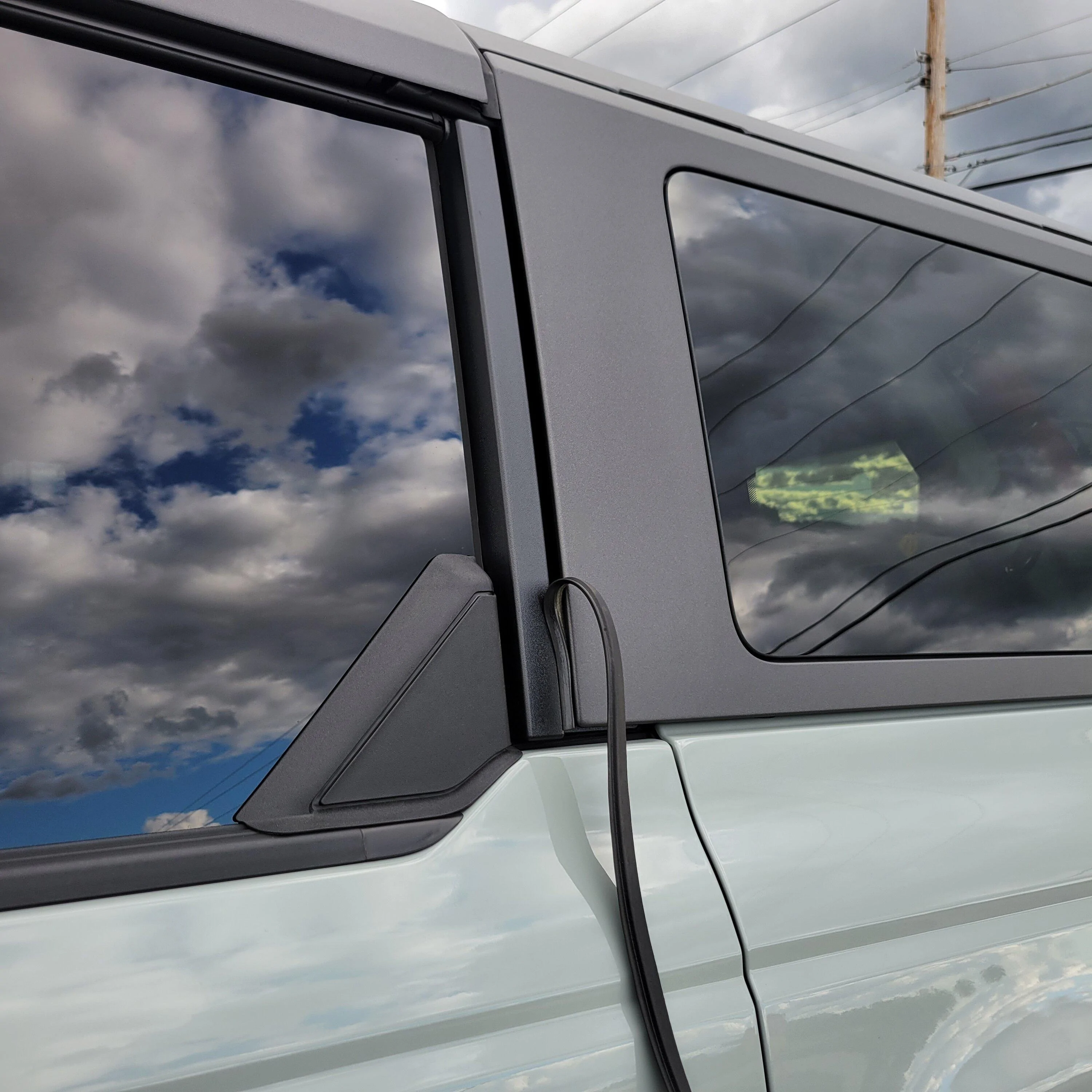

I did all of these mods on Sunday, hopped on the highway for 20 minutes on Tuesday and noticed a real difference talking on the phone, very pleased.
Was on the highway yesterday for about two hours and the below happened. Not quite sure what to do to make sure that z-strip adheres to the rough MIC texture better. Maybe glue it?
Ford Bronco MIC Noise Reduction Guide - wind sound- aka more (or less) cowbell please 20220922_165518
Based on what I can roughly see- wondering if you can get it tucked "behind" the window vs overlapping- maybe the wind caught it? I also was wondering if it would come off. Mine, though, is "behind" the middle piece so wind doesn't catch it.
When I redo it I will see if it will tuck behind.
