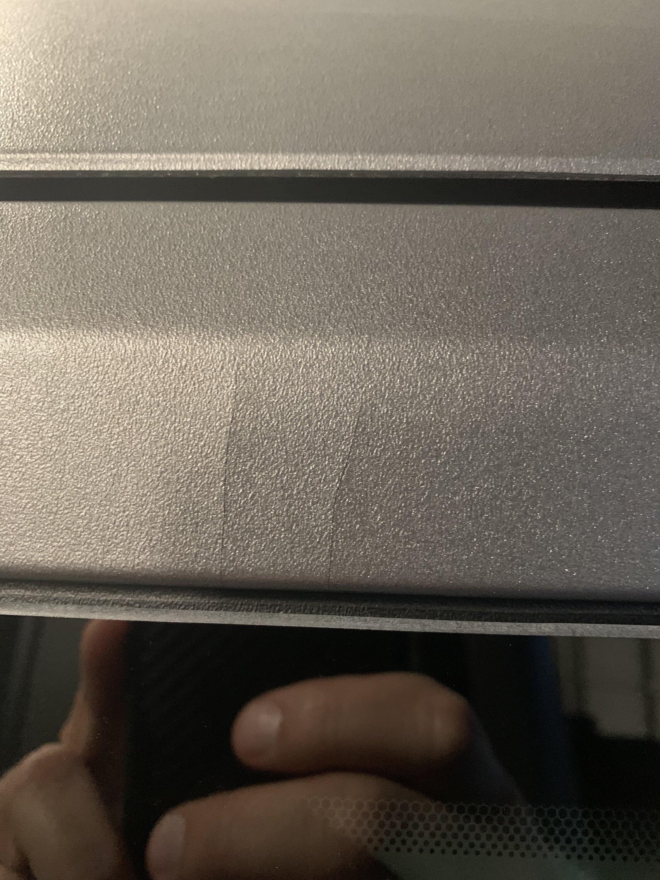

I think it’s worth noting in the poll if you have a 2 door or a 4 door. I believe the rear side windows of the 2 door are longer than the 4 door. Not sure if it makes a difference, but a key metric to track if it does.
I have a 4 door and took 5 months for me to develop one hairline crack. My fear is more are coming.

Yes I had hair line cracking on both sides. Took it to the dealer last month for warranty.
Ford approved a full rear section replacement same day. Dealer ordered the full back half that day. Took 9 days for it to arrive. Took Bronco to dealership this morning and dropped it off for them to pull my windows out of the old top along with rear window to install on the new top. Should be ready tomorrow.

My WT is fine (so far). My wife’s OBX (2k miles) is cracked. Waiting to hear back from the dealer on it. Edit- stock suspension. Only driven to work and back. Garage kept.

My one and only hairline crack “opened up” more after my first time off-roading. Stock SAS suspension and wheels. Still shouldn’t happen though. I believe there are plenty stock suspension Broncos that are cracked and haven’t even been off-road. But you do bring up a good point about altered suspension mods having an impact, but again something we shouldn’t even have to be talking about.
