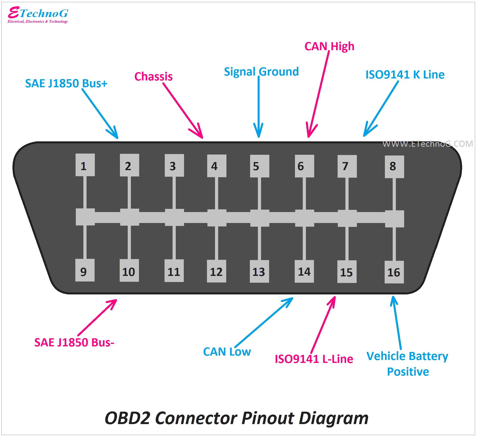

Hereā€™s you a quick 5 second way to disable your truck from the comfort of you driver seat with no modificationsā€¦take a paper clip, jump the hscan+ Terminal on your obd2 connector to ground. With the can network shorted to ground itā€™s never gonna start, since the BCM talks to the PCM on the network. The pcm sends the start request to the bcm to crank.

You have a picture of this?? All Iā€™m reading is a bunch of alphabet letters lol
