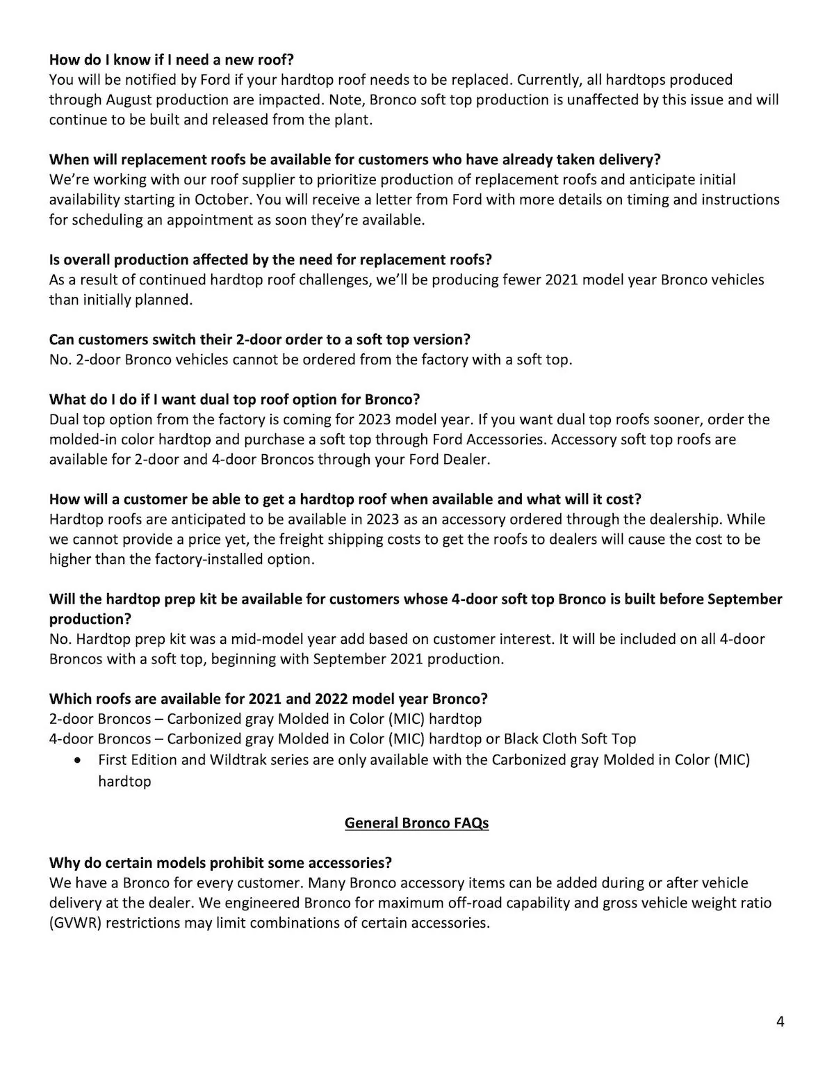

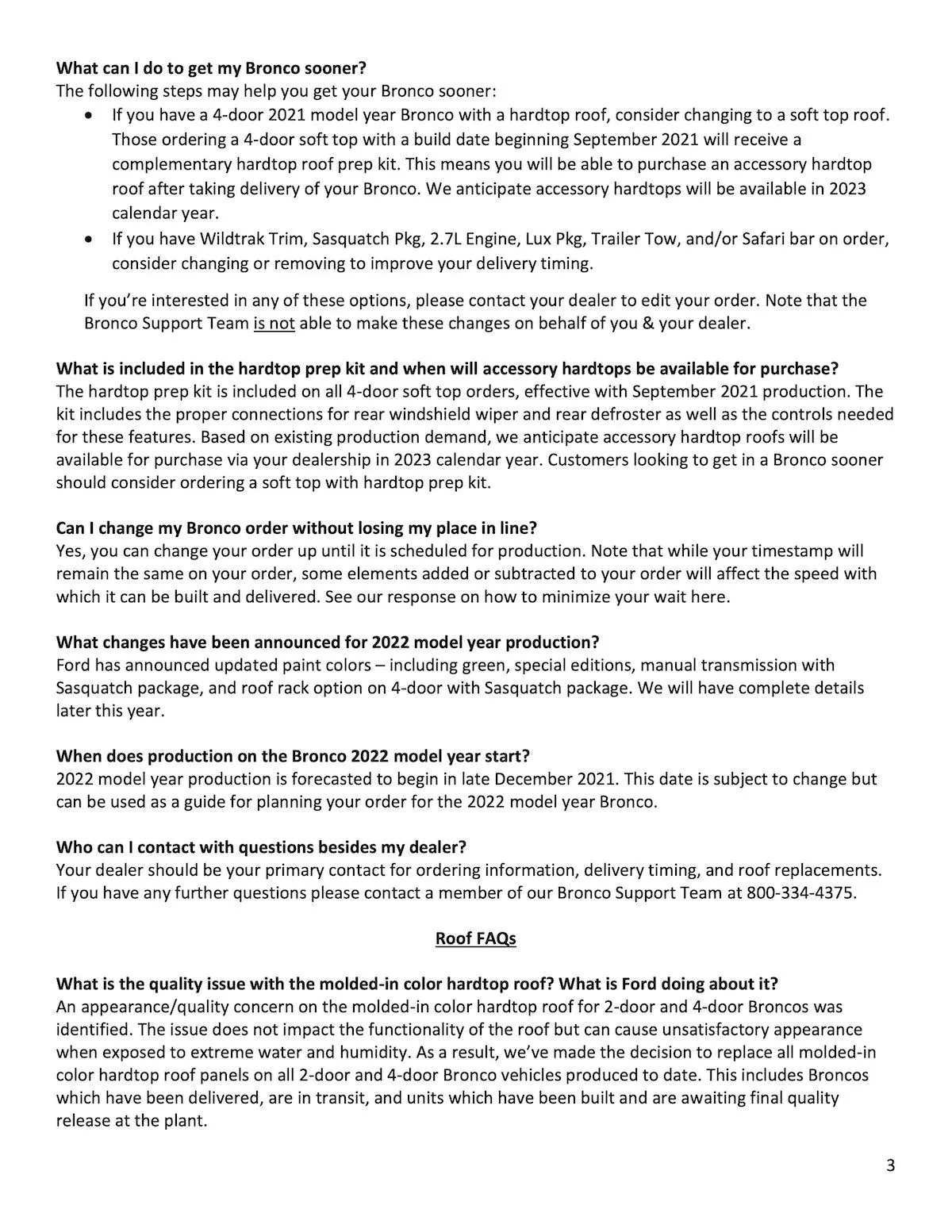

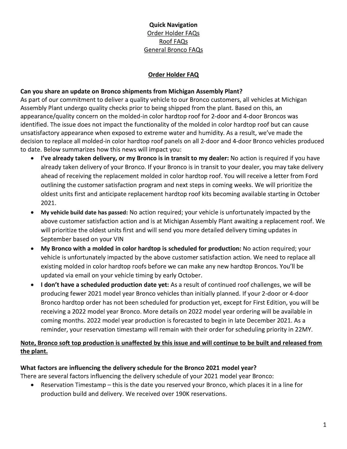

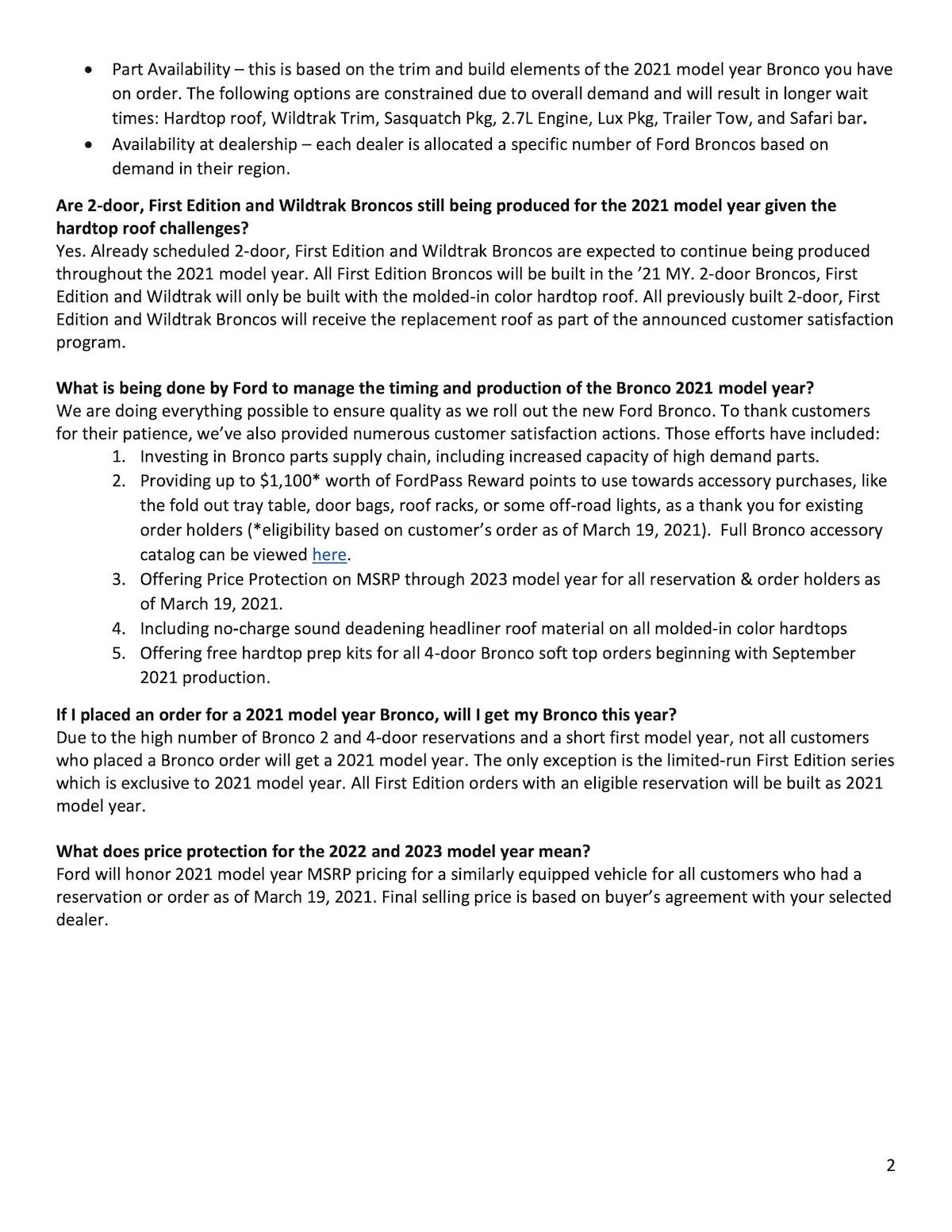

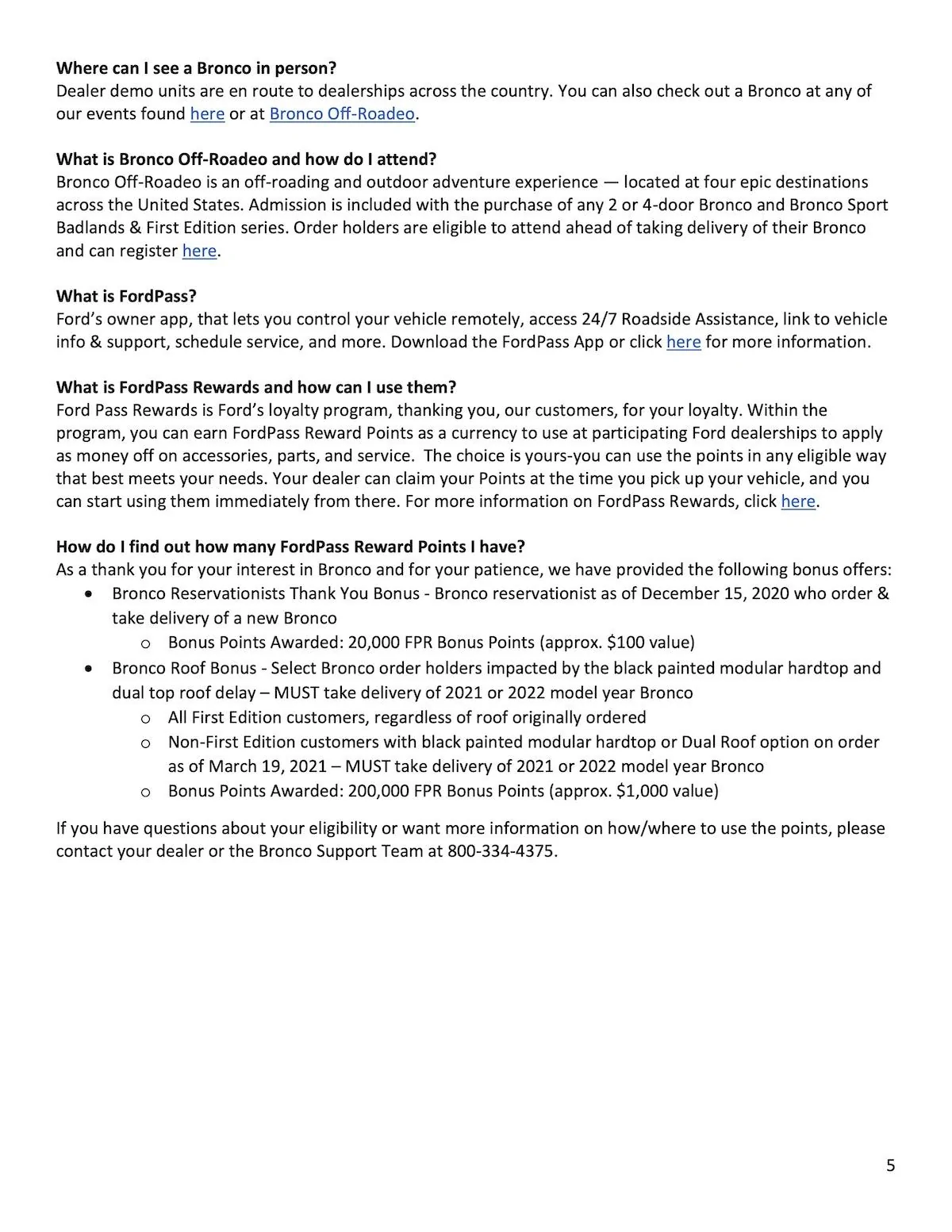

Full Order Holder FAQ:

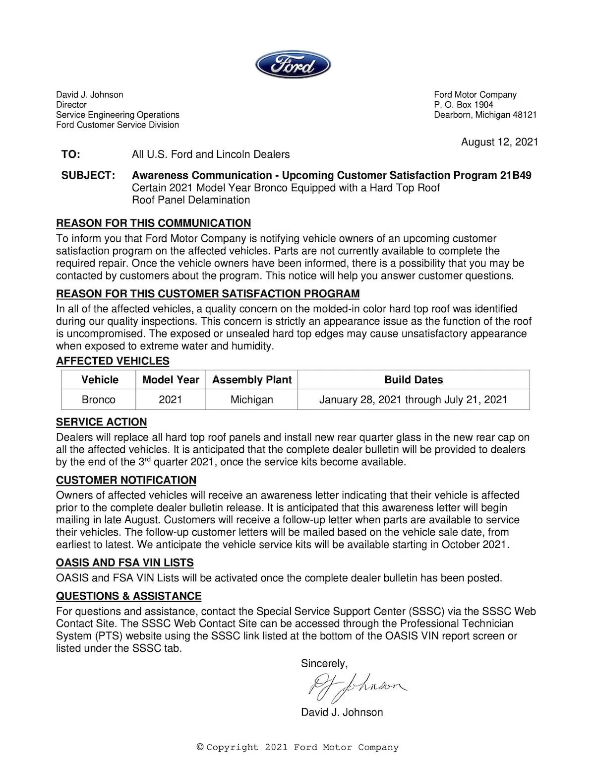

Awareness Communication - Upcoming Customer Satisfaction Program 21B49
(Certain 2021 Model Year Bronco Equipped with a Hard Top Roof Roof Panel Delamination)

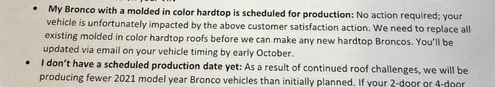

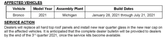

No - the entire roof assembly is being replaced. This is being described this way as they won't ship the "replacement kits" to the dealers with the glass in place. It will need to be installed in the new cap by the dealer.
They are only switching out the removable panels and the rear quarter glass (not the cap).
