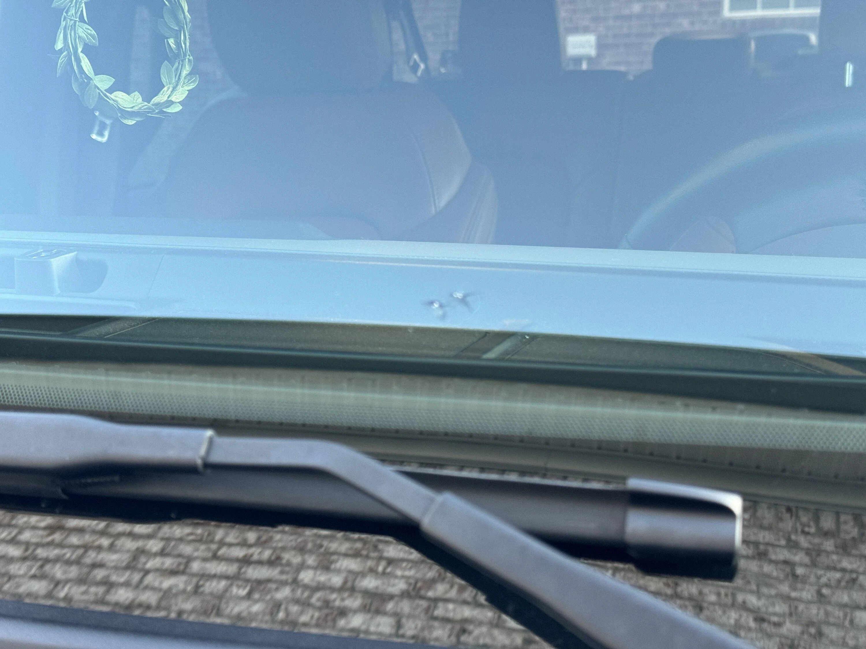

Only had my bronco a few weeks and I already got my first rock to the windshield…. I knew it was likely but I’m still bummed. My insurance covers repair or replacement …. So my question is - should I try and repair? Or replace? It’s two small pits with itty bitty spider legs from each. Not awful yet (above driver side wiper)… I’ve never had a rock in a windshield in my whole life. Advice please…. (Also I think the windshield is not orig… I bought a 21 with 17k miles on it and it doesn’t have Ford logo on glass so I’m thinking it was recently replaced).
Thank you for any tips or recs. Cheers.

If they are bigger then a quarter replace, if not fill and move on. I have one of these on mine and it seems to help. Wind Deflector

Since you believe it’s not the original window I probably would want it replaced. I have filled similar cracks to your description in the past. Never was overly happy with the fix. They still are somewhat visible, and if your eye regularly sees them, it may be an annoyance while you’re driving. That’s just my opinion. Good luck.

It's wintertime and changing temps may increase the size. If you are still driving along a rock chip prone route, then I would hold off as long as you can. You don't want to replace it, especially going through insurance, and get a chip in that next week.
Those deflectors or changing your driving routes are the only ways to prevent those cracks. The windshield is a rock magnet.

Get big chips filled. That keeps the moisture out and helps from developing into a crack which means it’s toast. Most insurance covers this with no deductible or charges.

Sign up for windshield coverage from your insurance policy provider. Mine is about $7month for 2 vehicles. Replacement deductible is $50. I bet most provides have similar plans.
Enjoy the chips for as long as you can stand it. Your chips are not in your line of sight, just obstructing the view of your hood.

If it were mine, i would definitely get it repaired before replacement. Living in Buffalo, NY and all the crap on the roads (mainly during winter), I've had multiple replacements and repairs over the years. The repairs were always really good and you could barely see it, if at all. Yours is low enough where you probably would just look past it anyways. A replacement, obviously, is much more involved and higher probability of "issues". Look on the bright side, if you don't like the repair, no worries, I'm sure you'll get another opportunity to replace it soon enough....👍 If you do decide to repair, you need to do it asap before it cracks.

You can DIY the crack/chip repair. The kits are very good. Save the replace for when you really need it. Most insurance cover windshield replacement/repair at no cost or minimal deductible. Still it qualifies as a claim on your insurance. File enough claims and your rate increases or they just don't renew the policy. Do the repair before they get worse and you are forced into a replacement.

Given the damage is not right in your line-of-sight and our windshields upright position, (meaning more chips to come), I’d wait for more serious damage down the road. Repair it, and take satisfaction knowing that you have a “road tested” windshield you don’t have to worry about😉

Glass places around us repair them for $50. Cheaper than new glass. The sooner they are repaired the better. Ours got a big dinger driving home from the dealership at 91 miles on odometer. Oncoming semi kicked up a rock.
I also carry a glass repair kit that I've only used on a Corolla. It was $10 and seems to have worked as good as the $50 pro fix.

I'd try DIY repairing that with a Permatex or similar kit.
Recently did that for the first time on a rental car after not noticing a chip on check-out since it was rainy out. Worked surprisingly well.

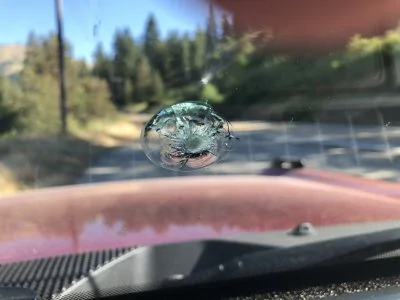

Mine was beyond repair, so I had it replaced. Safelite came to my house to do it and after watching them remove the old one and install the new one, I'm convinced that the quality of their installation was better than what the Ford factory did. More than a year later and no additional chips at all.
Ford Bronco Advice on windshield crack please…. RCJJwOm
Was the 250 for full replacement or fix? Generally they would rather pay to fix it than to replace it because as soon as it develops a crack, you are SOL. But I must admit, I don’t know much about high deductible car insurance.
