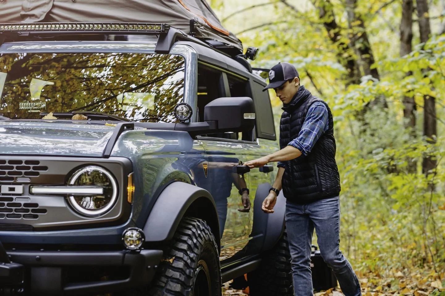

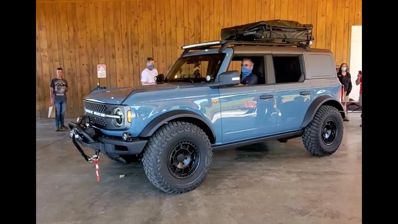

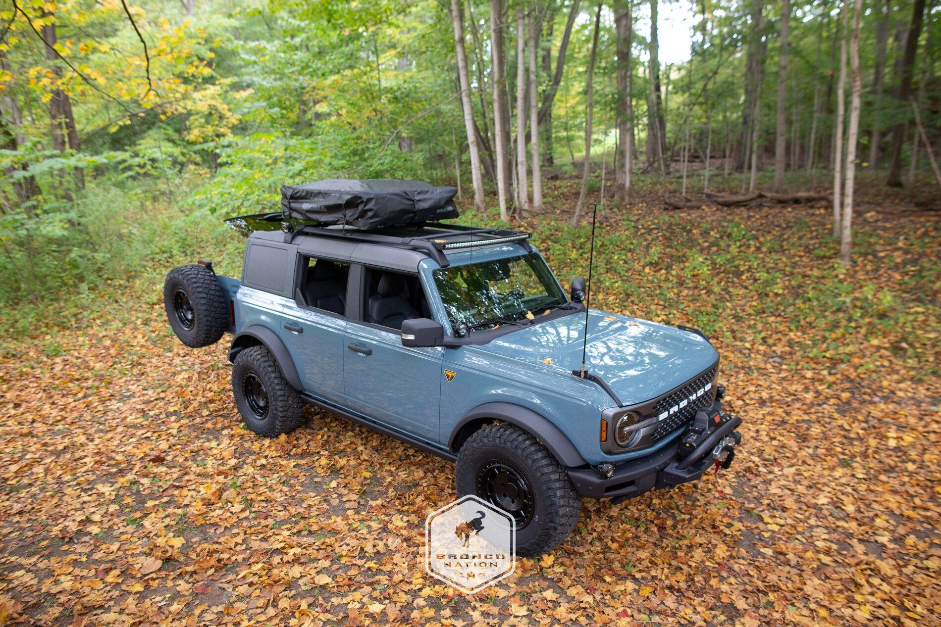

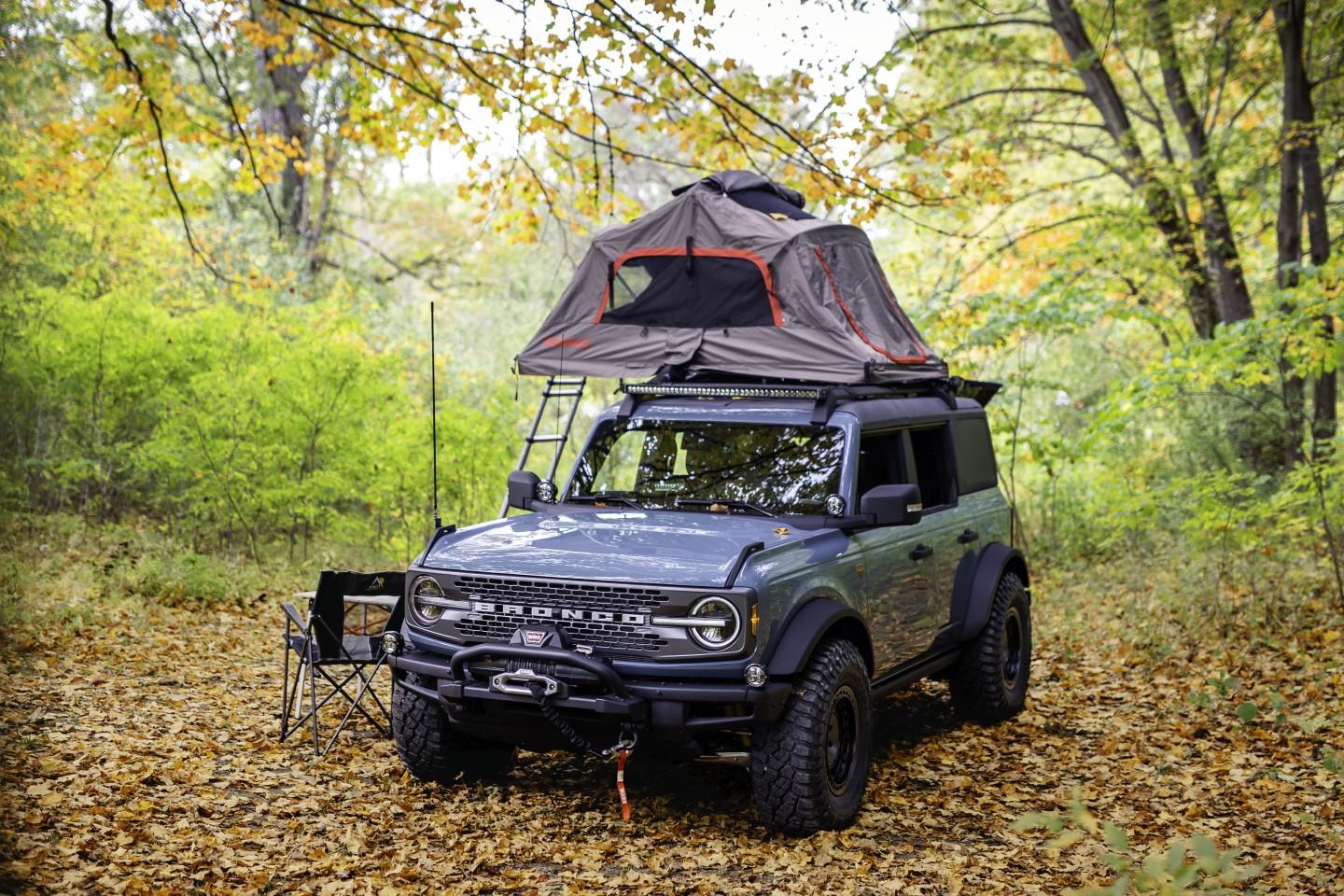

This is a NON Sasquatched Badlands with 35's.
Looks like they added the wider Flares as well. Don't know if these are 17x8 or 17x8.5?

Can you clarify this, in the walk around youtube video of the overland build I thought the guy says this is the squatch suspension, they just switched out the shoes.
No, because if it was squatched they wouldn't have been able to put that roof rack on it...due to GVRW. Also it's a manual transmission, and at the time of the build, there were no manual squatches.

So based on what your saying if you went 315's on a badlands you would have alittle more clearance then the overland concept right?
Depends on how you option it. A 4 door Badlands with Lux, winch, rack, swinggate table, pull out cooler, security shelf and rooftop tent would be pretty similar with 315s as the concept. (For that matter a similarly equipped Squatch should be too.)
But if what Levine and "the engineer" said is correct, if you put 315's on any non-Squatch Badlands, and compared it to a Squatch Badlands equipped the same way, theoretically the center of your hub to say the body line in the side of the bronco should be pretty much the same. Those 315s are going to rub because you don't have the bumpstop or the wheel offset, but your ground clearance should be the same.
Like I said in one of the other threads on this - until we see a parts list and find out the real answer on the springs - nobody knows for sure. Because Ford marketing people have said all sorts of things.
Me, I trust "the engineer" because he was asked a specific question and gave a specific answer (only suspension difference is 10mm in uptravel limited on Squatch).
Also for me, at the end of the day, I would lift more for 315s or even 295s and try to get a little more articulation if I feel I need to go higher than stock Badlands, so Squatch gets me nothing.

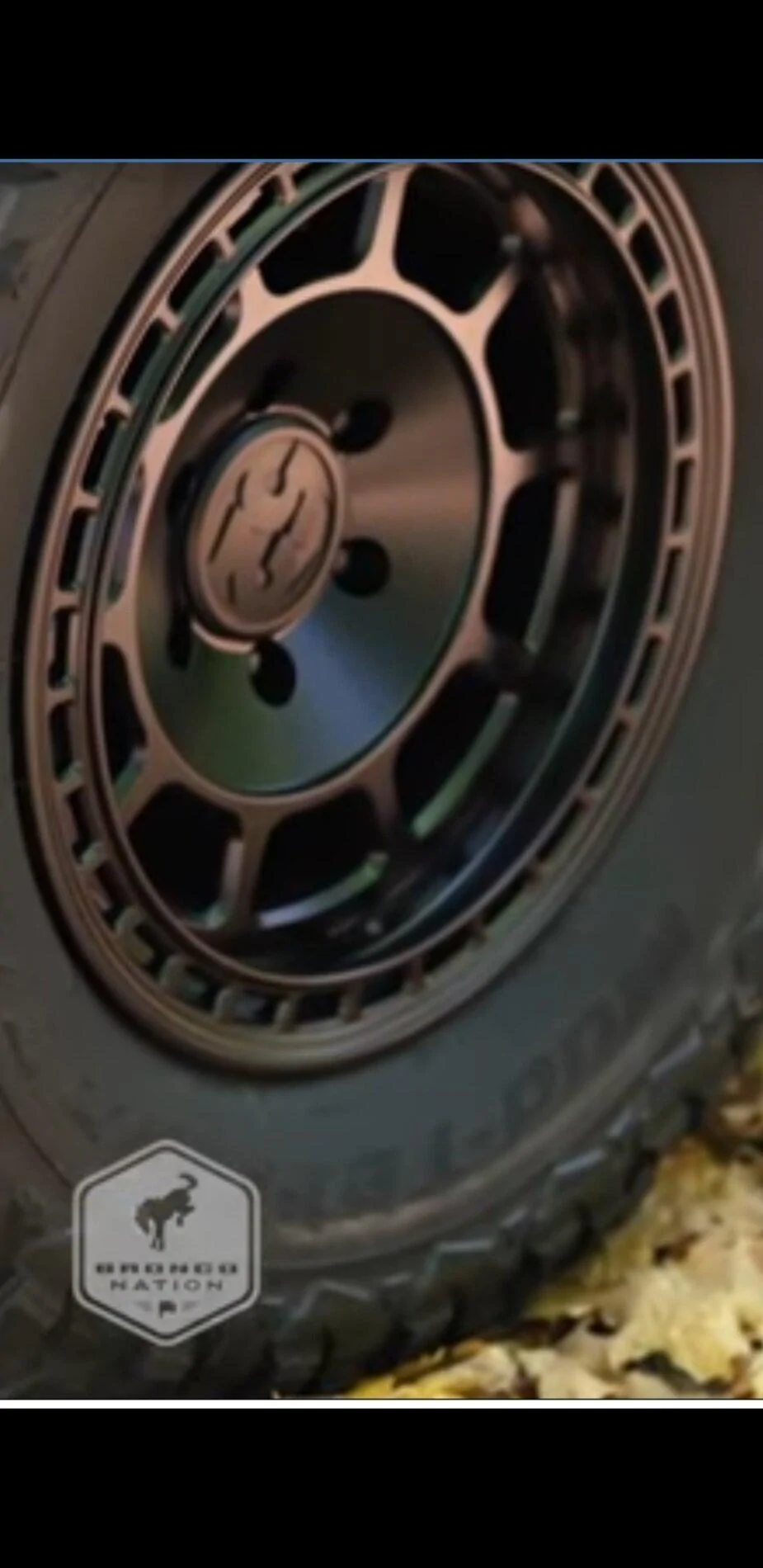

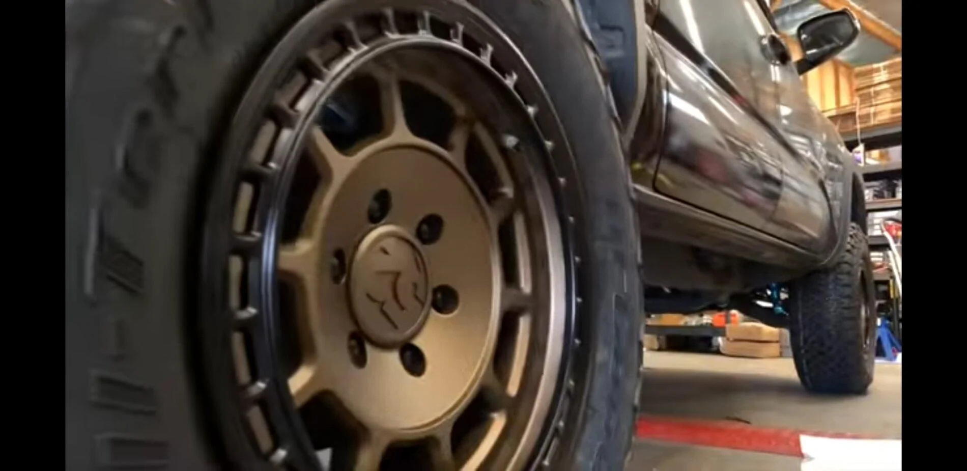

Like a lot of you, I’ve been going back and forth on whether or not to Squatch my BL. This pic finally settled it for me. I’m going with the upgraded rims, but no Squatch.
Ford Bronco {thread} {filename}
Agreed, not really seeing the beny the BL wheels are awesome and we can get another full set for less then $2500
Yes it was said by Ford that the overland concept is a Non-squatch badlands.
