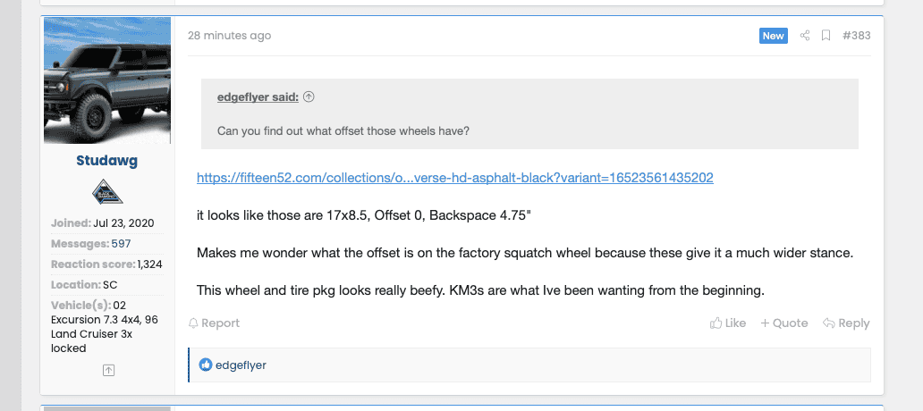

It's .5" wider but what's the offset? Many OEM rims have a positive offset. The stock Xterra rims were +30mm. The standard Bronco rims appear to hold to that trend. That's an assumption entirely from looking at picture after picture of the rims. I don't believe offset has been discussed or released by Ford in any way.
The Wildtrak (With Sasquatch included) works out to 3" (1.5" per side) wider than the Badlands. The 35s account for 1.2" (.6" per side) of that. So the other 1.8" (.9" per side or 23mm) should be accounted for by a difference in wheel offset.
The only reason that makes sense to even do this is if the 35" tires would make contact on the frame or something else if they were mounted on the stock wheels. The question I have is, do the upgraded "beadlock capable" Badlands rims share the same offset.
I don't really expect anybody to have the answer. I'm really hoping once the order guides make it to dealers there's more information available, but I don't have high hopes.

Most likely not since they are the same 17x8 size and standard badlands not 8.5’s, and we’ve never seen them with wider Sasquatch flares (which they would need if they had the same backspacing as Squatch).
Yeah, I suppose it would be too good to be true.

Those were aftermarket rims. I don't remember the brand, but the lugs look pretty deep comparative to the stock rims. I wouldn't be surprised if they were 0 offset. It's the most common configuration for aftermarket rims.

Though I disagree with their assessment. I think they look to be about the same as the Sasquatch rims/tires.
That and the likelihood that the Badlands rims don't have that offset means I'm probably stuck going aftermarket rims to put 35s on. Unless the Sas package suddenly becomes regular availability for the MT, then it probably makes sense to Sas.
