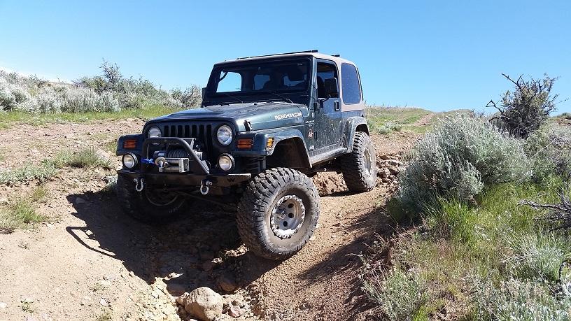

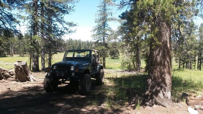

Pretty easy to do, just find neutral safety switch, unplug, install a jumper wire so the ECM thinks the clutch is in all the time. Did this mod in my TJ. Good for starting in gear when off road and you don't want to drift back.
This comment reminded me of another reason I generally prefer the automatic. I've been on some ugly off camber trails before, and if it's wet or snowy, sometimes your ass end likes to try and slide you down a cliff. When you feel the slide and get yourself stopped, it's generally inadvisable to have any sort of rearward motion.
So in a manual, after you pick your butthole out of the seat fabric, you've now gotta get that vehicle going again with no rearward movement. With a steep enough crawl gear, and provided your front end isn't against a rock or a log, you can left foot clutch, right foot brake, and slowly nose yourself forward. If you don't have a low enough crawl, you're doing some foot gymnastics running the brake and the skinny with the right foot and the clutch with the left. Coupled with the fact that below you is a very long, painful drop if you screw up. That can add up to some serious mental pressure.
Thinking about the last time I flopped my TJ on 35s into a ditch (it happened a few times), I think the 95:1 would have been enough to get me going. As it was with my 4.56 gears and stock T/C, I just didn't have the oomph, and ended up laying sideways after a couple foot drop.
#1. Always wheel with a buddy vehicle.
#2. If you go alone, a winch is not a bad idea ;)
ye 'olde TJ
