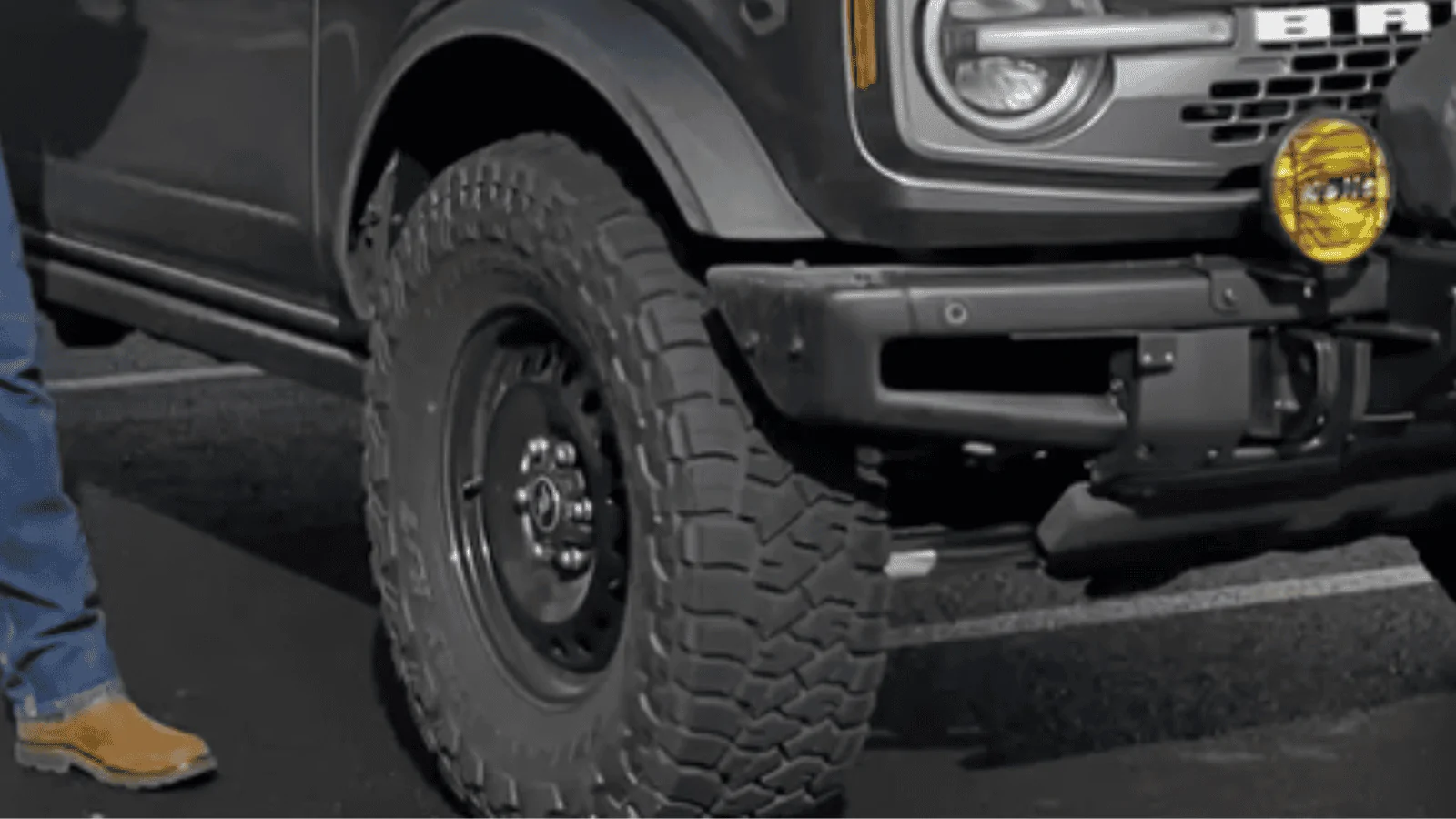

I run the new hybrid "D" rated tires from Toyo. Open Country R/T Trails. They are wonderful on the bronco and seem to ride and drive better that the factory tires. They have a reinforced side wall and much less lean during cornering. 37 psi cold. I'd buy these again in a heartbeat!
https://www.toyotires.com/product/open-country-rt-trail/
