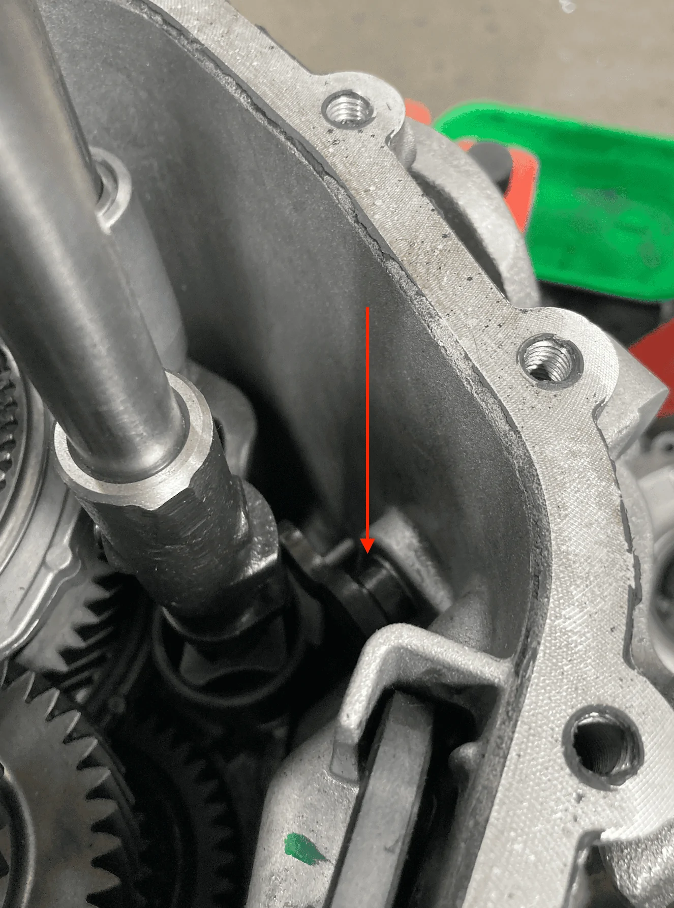

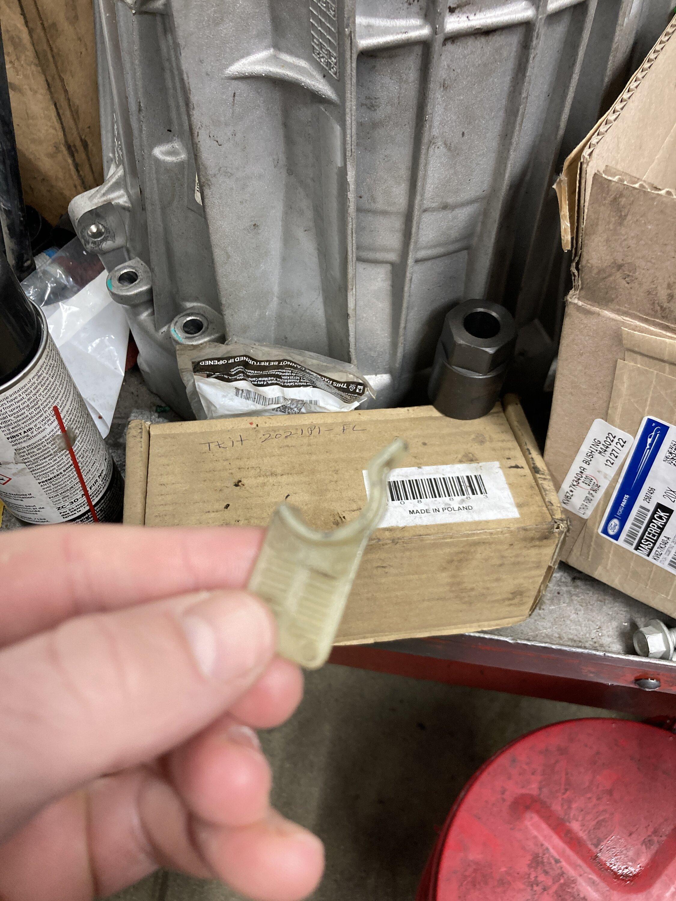

the infamous plastic clip (backordered to May 15)... and also where it goes
Ford Bronco Is your 7MT manual transmission making grinding / scraping noise too? Spreadsheet, Video and all resources for rotational scraping noise in the 7MT's 1679341458881
Well, unless your batch of back ordered parts somehow arrives with the clip and a set of updated synchro rings, youā€™d end up doing the TSB work all over again.
I was back ordered for 8+ weeks waiting on TSB parts, then found out the ones I waited on are the original -C synchro rings not the updated ā€œfixedā€ -D revision
What does it do? Part of the shift fork / rod assembly?
Are you a tech? If so, is this about the same cluster as tearing apart a MT82 or is it a lot easier to get in there to do the synchro replacement?
Not a tech, just a boy w/o a bronco
Thatā€™s cool. Was just curious how big of a job the repair was. Their MT82 doesnā€™t look fun to work on.
