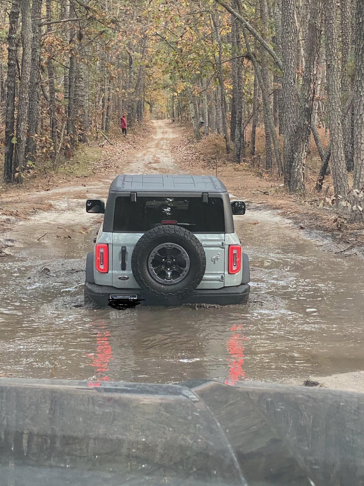

THIS. Especially in deep mud holes. I was sitting on my
Skids last week because of this.
