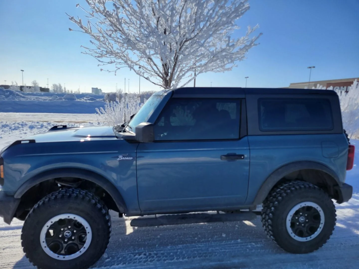

I finally got into the dealer yesterday for this issue. They came back and said the 4th & 5th synchro's are bad. Had a multi-page writeup for all the parts that will need to be ordered. And, of course, everything is back ordered. I'm ok with this. Would prefer Ford get this figured out first. One good thing is there's no drivability problems with this issue. I have posted here before. The videos here are exactly what happening to me.
parking lot wheelin' pic...
