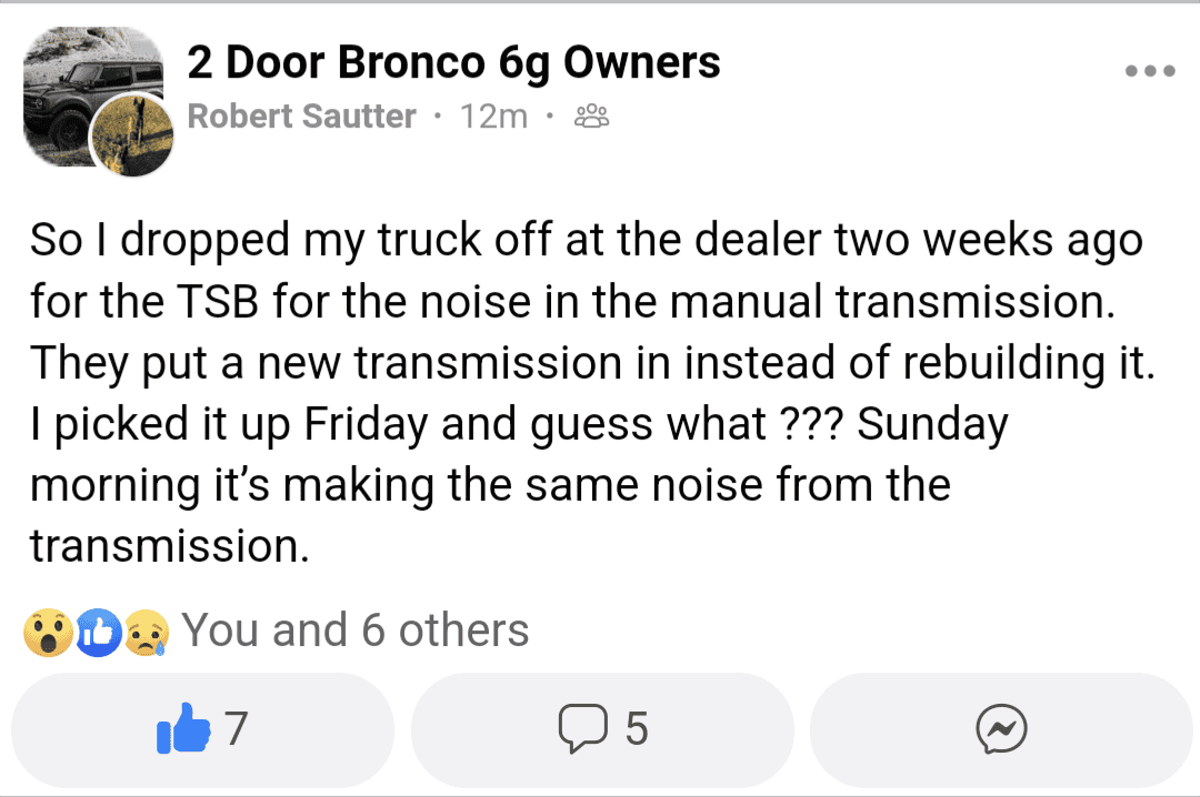

Another unsuccessful attempt at a resolution.
Seems like at this point replacing the transmission has 0 chance of resolving the sound, and it seems like a solid chance we can count the same for the TSB.* edit for clarity.
With the failure rate of both it seems like the sound is probably effecting 100% of manual broncos.

Seems like at this point replacing the transmission has 0 chance of resolving the sound, and the TSB seems like a solid bet.
The TSB is not proving anymore effective. They need to likely create a part change to solve this and the current TSB replaces with the same parts. I feel like this is going to get big.
Agreed, lost my phrasing, wanted to say it seemed like a solid bet that TSB repairs were going that same route = ineffective.
Again based on what? I’m still waiting for someone on this forum who has had the TSB done (not just replacing the transmission which is not the TSB not not sure why it keeps getting brought up) come back and say the noise returned.
