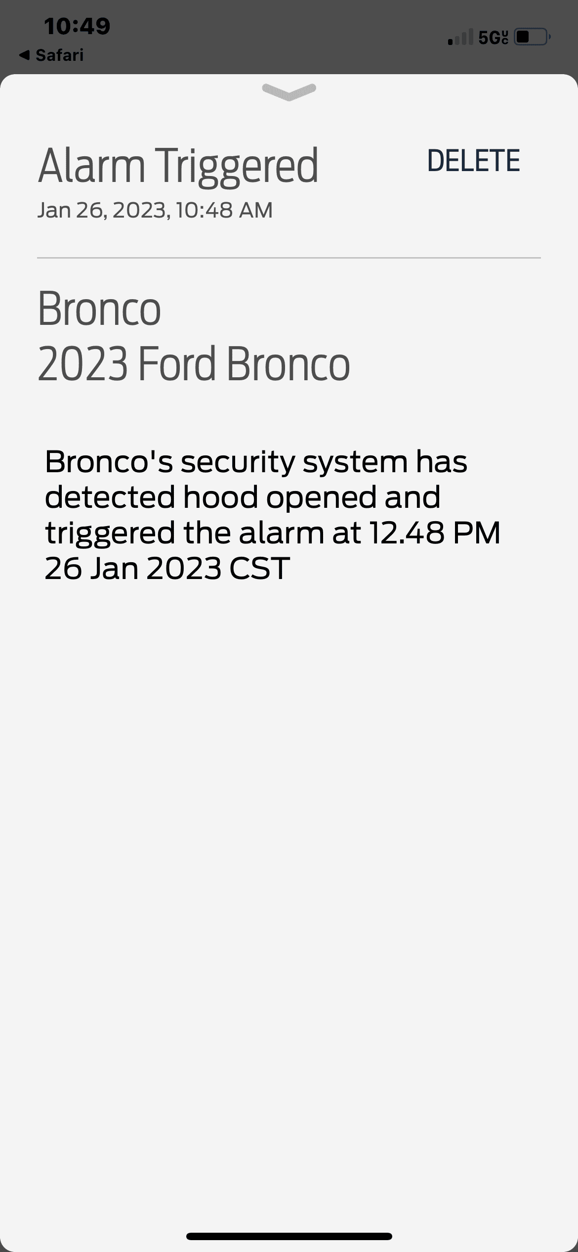

I also now have a new problem in that the alarm is going off, and I’m getting notification via FordPass app that someone is trying to open my hood. Except they are not! I’ve never had so many glitches before with a new vehicle purchase.
