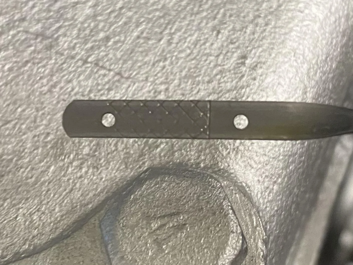

I recently performed an oil change on my 2.7L and managed to take out/drain close to 6 and 3/4 quarts of oil. The oil level readings on my dipstick has always been consistently in the nominal mark ("B") so I do not believe it was overfilled from factory. I put ~6 and 3/4 of quarts back in and the dipstick indicates that my oil level is nominal.
this is what an overfilled oil level looks like in a 2.7
Ford Bronco 2.7L Oil Change Tips + Replacement Drain Plugs 9179C4AD-9F66-41A1-9043-B27621BB683E
Notice the oil is past the second hole up into the twisted part.
This is what a 2.7 dip stick looks like empty wiped clean…. No oil is supposed to be past the second hole.

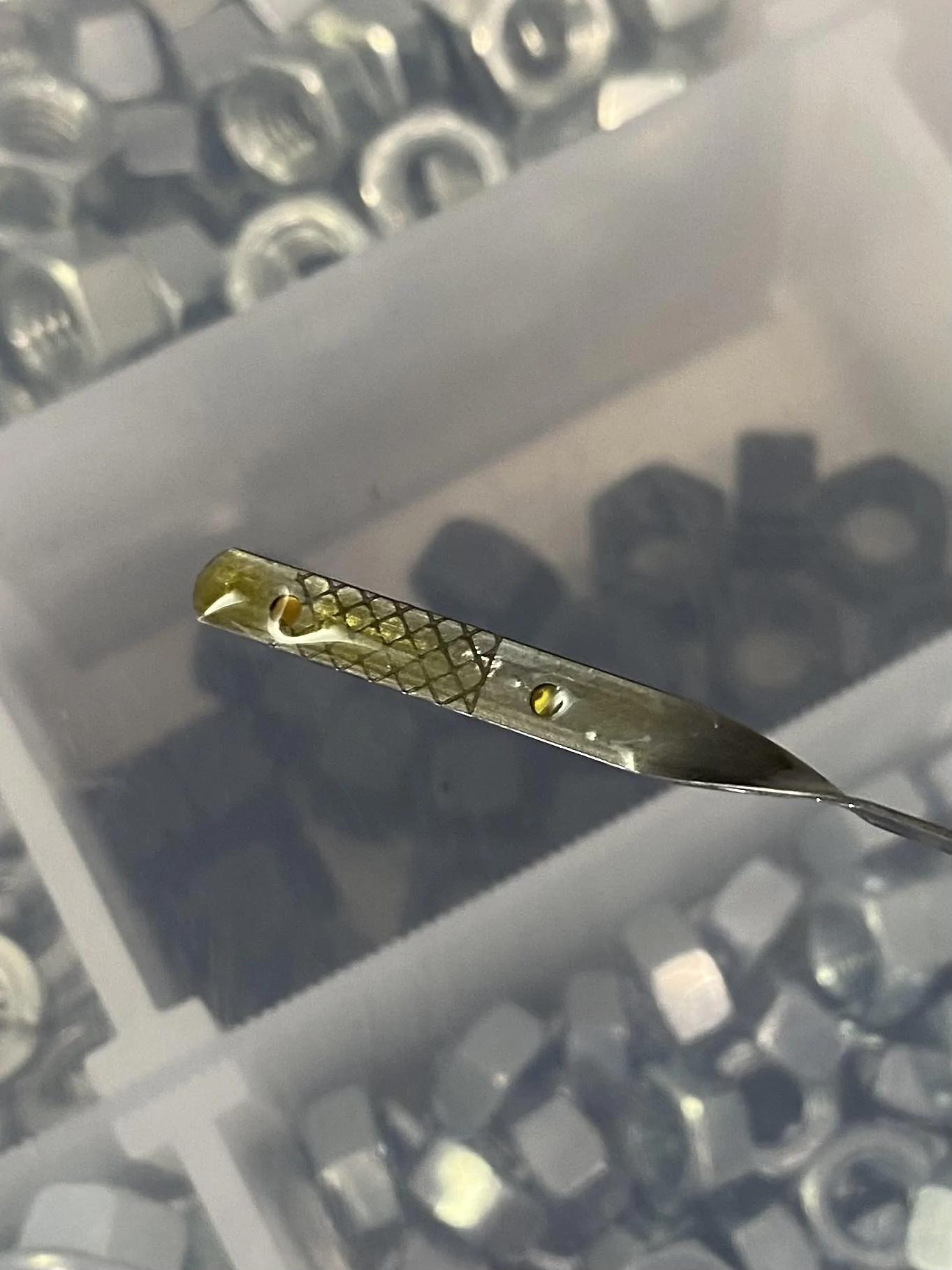

Ford Bronco 2.7L Oil Change Tips + Replacement Drain Plugs 1F778CAC-BBCF-43BB-9EE8-B841EF54112C

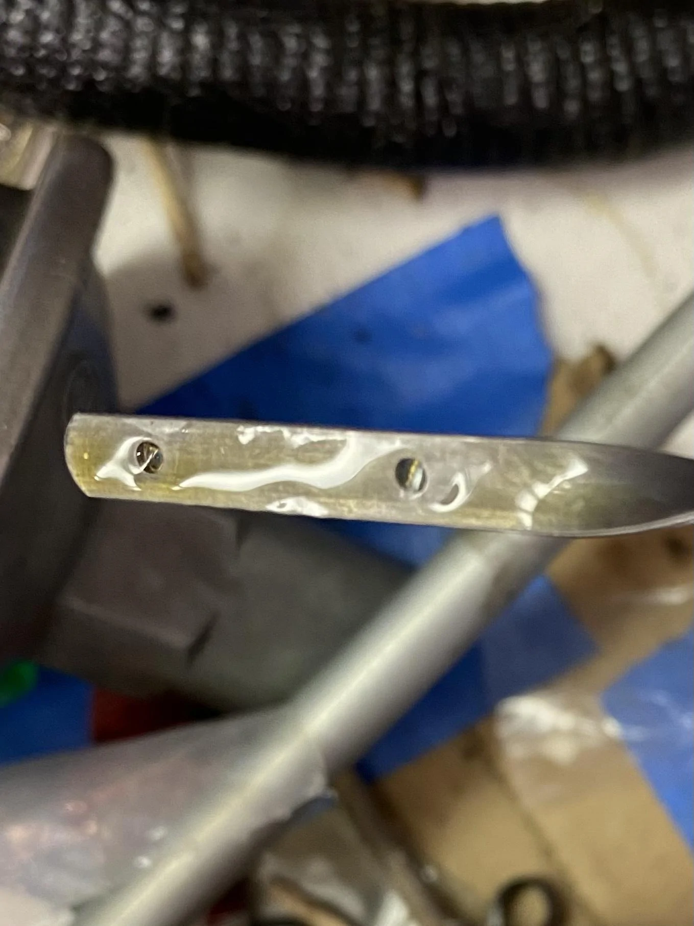

This is my dip stick (flipped over)
With approximately 6.3 quarts (with new filter, run warm, and drained after 15 minutes)
Ford Bronco 2.7L Oil Change Tips + Replacement Drain Plugs 35FB94C8-51DF-499B-9EF2-CA197903F943
Like I said earlier this dip stick is extremely hard to read… you can see the oil breaks up just past the hole…
I believe this is on the hairy edge of overfilled.
Again, after putting in 6.5 qts. as many have suggested, I painstaking bled oz. at a time to get to this level down…
my suggestion is to put 6qts in….drive it get the oil hot…let it drain back to the pan….
Then painstakingly top off the oil to fill…
I would never trust anyone to change my oil and the oil plugs that give you bleeding capability are a plus….
Hope my experience helps others
