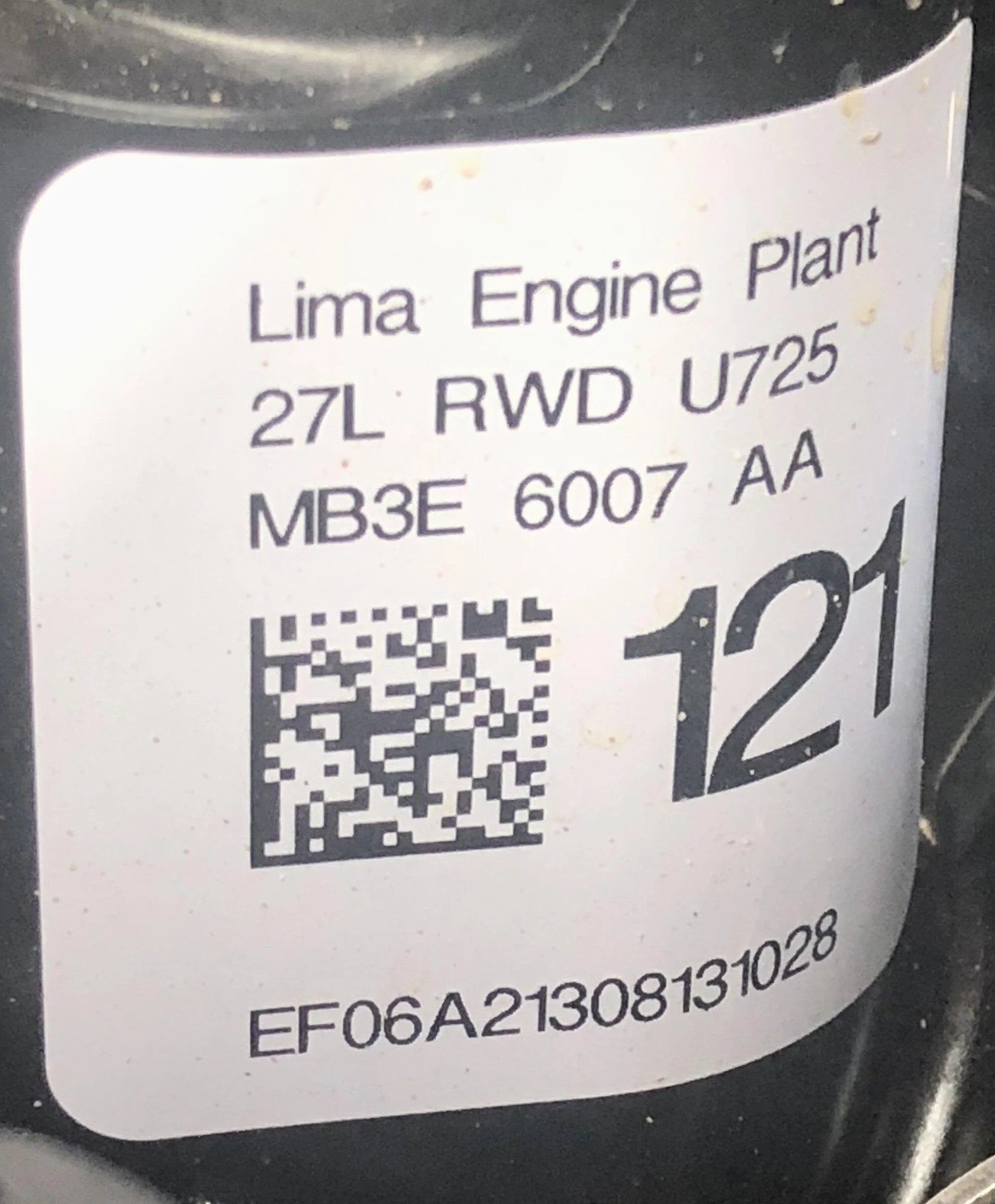

So far the engine build-dates run 21131 - 22019 - see how to read Engine Ser#
- 90% are in ' Hot Zone ', 21159 - 21224

- engine ser# - (see label photos)
-- or last-8 digits of VIN
- pls include mileage & fail-date if possible
example Engine Ser# Labels -

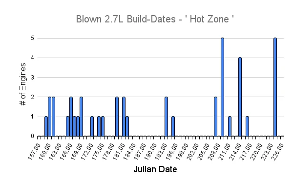

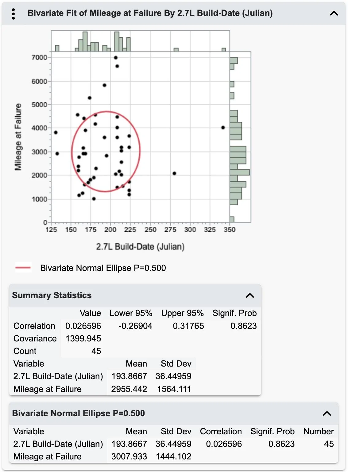

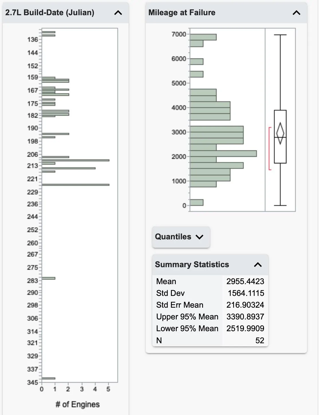

- B6g trying to see if the failures are confined to a range of engine build-dates
- maybe they were mostly built in same couple months ? - see also 2.7 Failed Engine Tracking Thread
- in 46 of the events we have the engine build-date info

Over 90% of dropped valve events range Julian 159 - 224
Ford Bronco 2.7L blown engine failure list . . 68 so far [Updated: December 13, 2022] Blown 2.7 ebds Hot Zone - 2022.July.18

1) @mmcq - 1st post
2) Jose Hernandez - 1st posted
3) @jeremy.wilson237 - 1st post - further
4) @ToddGinGA - 1st post
5) @Bubbabow - 1st post - further
6) @Nikole - 1st post
7) @Hailey Jo - 1st post
8) @Lance103222 - 1st post
9) father of @Shinoko - 1st post - further
10) @estone28 - 1st post
11) Steve Seale - 1st posted
12) @Broncoshrimp - 1st post
13) fb of @bytheway - 1st post
14) @yogi_stvl - 1st post - further
15) via BN - @Snowdogyyz - 1st posted
16) @roofone - 1st posted
17) @69 Mach I - 1st post
18) @Broncitis - 1st posted - further
19) @Broncitis - replacement also crapped out
- ? credibility ? - no independent confirmation any of these - only posted info
- so far engine build-dates run 21160 - 21216 - see how to read Engine Ser#
- most recent engine build-date could be @Hailey Jo - Sept ? - no Ser# info yet
- ? other posts overlooked ? - there could be more
Example Engine Ser# Labels -
Why do you have a pic of my Julian sticker date 2nd one? 🤷🏻‍♂️ Thursday November 4th 2021. Hasn’t blown yet! 😂 Current 2k miles.
Edit: 33,000k miles lifted on 37s going strong.
